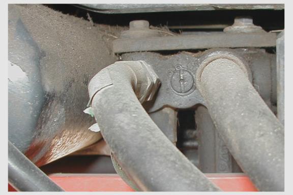

I have a Kubota L4200 w/LA681 bucket is a 1994 with 76 hours on it and am original owner.Also have a small 5 foot grader box on the 3 pt.hitch.The 3pt. hitch just made a huge BANG and the grader box fell to the ground while I was loading firewood into the the bucket.Now the 3pt. will not work at all...No up,or down even after I removed the grader box.The bucket was always kind of twitchy,until now.Now that the 3pt. stopped working the bucket is as smooth as glass. /forums/images/graemlins/confused.gifDoes anyone have any idea what could have possibly broken??Thanks for any and all help.I sure could use it..

Sorry it is not a welcome with out problems with your tractor. Check the selector between the 2 hoses that are just in front of the hydraulic filter, Right side center.
The slot should be vertical for loader and 3point, horizontal for only 3point, (loader removed) the attached picture shows my L4200. excuse the dirt... /forums/images/graemlins/tongue.gif
I have to think you may have broke something inside if the lift arms are still attached on the outside of the 3point.

A huge bang and no hydraulic fluid on the ground would mean you may have a internal failure like broken piston.
If you can you move your 3pt arms by hand with the engine running then you may be tearing into it.

The problem was that the 3 point control lever/shaft/washers was corroded from lack of use and was not allowing the hyd. system to return to a neutral or non-pressurized state,and broke the hydraulic cyl from its mounting where it connects to the 3 pt. internally.Thanks "hans2" you were almost exact as to the problem.Then the pieces fell under the gears in the rear end and cracked a large area of the bottom of the rear end case.The sticking of the 3pt. lever and constant pressure were the reason my front end loader were so jumpy,and wasn't working properly.He had a professional welder come to his shop and weld up the cracked area,$300 in internal rear end parts replaced,flushed out the hyd. system/new filter,repaired a slow leaky tire,new battery,and replaced a bad positive battery cable I have been fighting for years,pick up/delivery,and a used plow blade for the rear, for a GRAND TOTAL of ====$950 cash...
