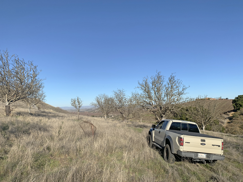

The one picture that got attached above is right in the middle of the build site. This is the flattest portion of the lot.
   / Kubota L3901, L4701 or MX4800 for Sloped 10 Acre Parcel and Home Build
In that picture you can also see the trees that need to be removed. This is in fall, and they have lost whatever leaves that have left. Interestingly, walnut trees are grafted onto some other type of root stock, and it is this bottom portion of the trunk, which is not walnut, which is now sprouting branches, even though the walnut tree above looks dead.

Ok, now we're in business with the pictures.
In this pic is a portion of the property which is pretty steep. I do not foresee us doing anything here. You can see how the hillside has oozed onto the road. I am thinking maybe a FEL can scoop this back off the road.
This image shows the build site where the trees will need to be removed. I am hoping a tractor can be safely driven around in this area.
Here (behind the marker posts) you can see our neighbor's parcel. Last year the grass was mowed by someone with a tractor and the area is fairly steep.
Here I drove our truck up what will be our driveway (after grading). My wife thought this was dangerous, but it felt fine. And considering the center of gravity is about at the height of the crankshaft, there is still a large margin to the roll over point. But I don't know if this would be the same with a tractor.
Another photo of the build site area where I would like to be able to drive around a tractor safely.

that is not particularly steep, you can drive a tractor all over that. Loaded rear tires will make it seem more stable. MX is a great tractor, particularly when its wide open land like you have
   / Kubota L3901, L4701 or MX4800 for Sloped 10 Acre Parcel and Home Build #7
Agreed - once you learn the tractor and learn to safely operate on slopes you wont give a lot of it much thought.
As for scraping the road off - shouldn't be a problem at all.

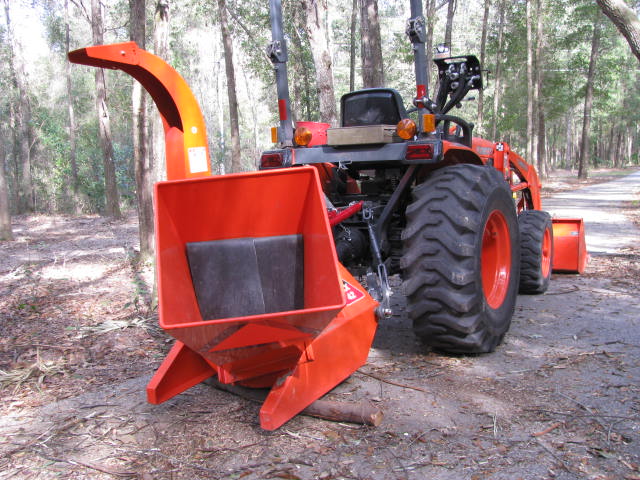

- PTO Wood Chipper. Our property is an old Walnut grove. The trees are not in great shape as they are no longer irrigated. We do not plan on removing them all, but certainly those in the area that will be graded need to be removed. We've started trimming the branches of some of them and the wood piles up fast!
We can't burn debris. We could take it to the dump, but that will take time and get expensive. So we thought to chip refuse so we can use it as mulch to keep the weeds down. The larger pieces we will save for a wood fired pizza oven or maybe to sell as firewood.
We looked at self-powered chippers, but I figure if we had a tractor then powering one off the PTO might be better.
PTO powered chippers are reasonably effective but fairly high maintenance beginning in year two, chipping dry material. Blades require periodic sharpening which requires removing the heavy rotor for blade access. As you cannot burn, you will have to learn chipper maintenance. You will soon learn there are small and medium chipper/shredders which turn brush into mulch and distinct medium and large chippers for 1" and larger limbs, vines and branches that do not handle small brush well. You will have to decide which of the two types of chippers is most appropriate for your property. A battery powered reciprocating "Sawzall" is very useful chipper adjunct.
You can chip brush from your Walnut trees with a Rotary Cutter but debris will be flung around.
