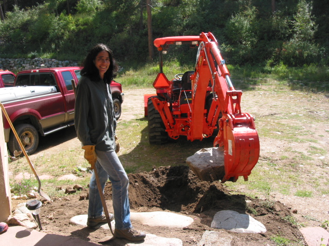

If you've made several ponds, it may be that you and I are alike in thinking the enjoyment of owning land is in sculpting the landscape to make it as good as it can be. Sculpting it to serve people, animals, and yes, the trees & plants as well.
Ours is no where near 90 acres, but is long and skinny and lies along about a quarter mile of mountain stream. This summer I am replacing the single pond which some high water destroyed.
The M59 has been our partner in doing everything here. We use it almost everyday. I'm proud to say that getting it was my wife's idea. I'd say you are on the right track to look at these TLBs. We have two older tractors for specialized chores, and because we've had them so long they are old friends. But the M59 is the one that gets all the use. The size is just right. It always has plenty of power for big chores, but it drives like a much smaller tractor. There was no real learning curve with it like there was - and still is - with both John Deeres. We got on the M59, it fit, and in an hour we were using it like pros.
I suspect the 39 and 45/47 are just as good; the difference is that with the M59 has reserve power and more reach. When working by the creek or at the pond it is always reach that we wish for more of. Our big 310 has the extendahoe and will reach 20 feet and that still isn't enough when you do so you are perched up on a stream or pond bank and inherently unstable. I'm afraid the real answer for more reach in a stream or pond is a small small vestpocket excavator. Well, Someday...
More about reach - the problem from a stream or pond bank is that you can only get so close before you are in danger of tipping yourself into the water when you use that much reach. Imagine picking up a 500 lb rock from the stream bank and putting it out as far as you can. Things get tippy. A longer hoe helps - but it also makes it more tippy. I like the length on the M59 because of the muscle it has. The compromise feels right, and the angle of the stabilizers works well for working close to edges. The big JD310 will reach six feet farther than the M59,, but it is shaky to put that much weight so close to the edge of the stream bank....so in actuality it doesn't reach so much farther.
IMHO the best thing about the Kubota TLB line is how well the controls are placed and how accurate and instinctive that they are. For landscaping type work I can pick up a huge rock and put in down exactly where it should go.....adjusting by fractions of an inch as necessary. Other tractors and TLBs I've used are not nearly so accurate with their loader, backhoe, and HST controls. The creeper feature is a great timesaver.
