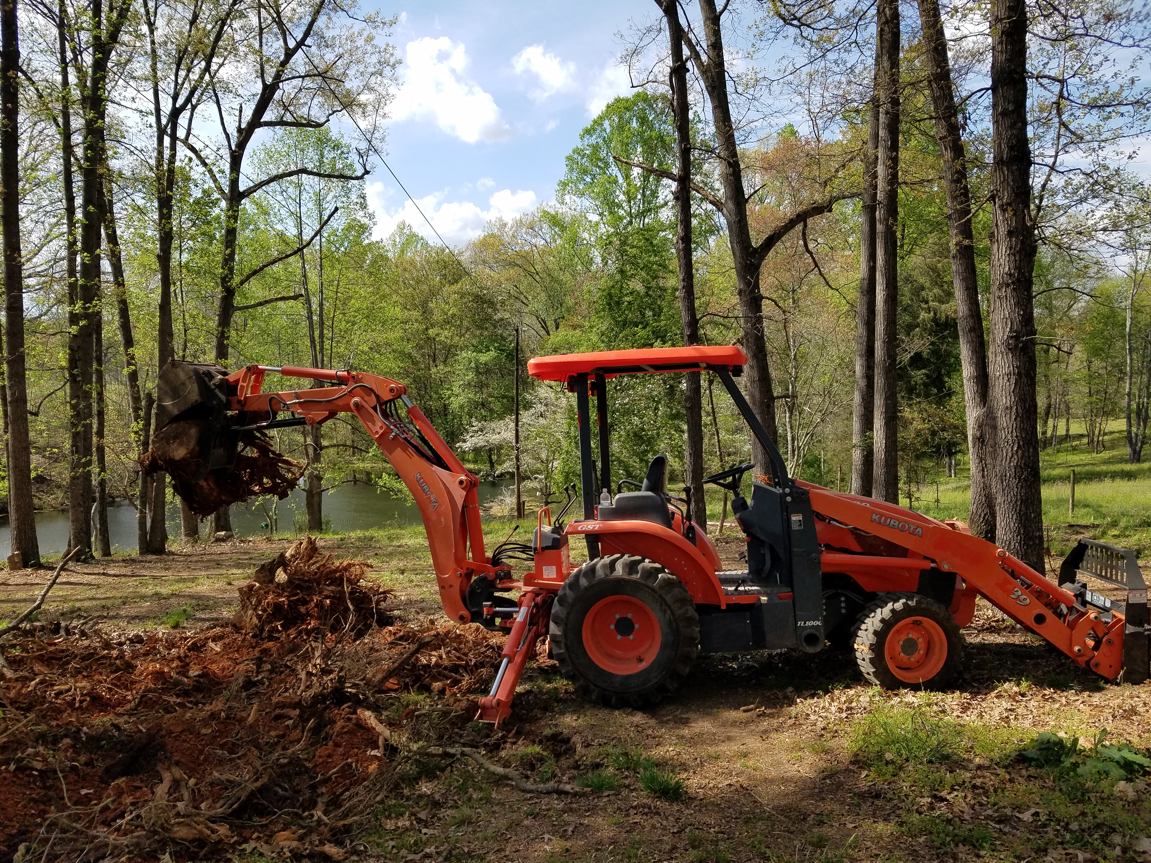

I am a proud new owner of an L39. Only has about 550 Hrs on it. My question is about a noise I hear when I am traveling. IT doesn't happen all the time, it happens whether or not the 4wd is engaged, and no matter what gear i am in, though It almost always is there at higher range gear operation. It is a sound of grinding or chattering gears. Doesnt sound right. Maybe it's normal. I have searched quite a bit and haven't found anyone talking about this with a GST. Could any Kubota GST owners chime in and let me know if they hear noises like this when driving their tractors.
Im not certain, But I don't think the fluid and filters have ever been changed. It is on my list of things to do. Kinda disappointing to be looking at a several hundred dollar service just after buying the unit.
Any comments are appreciated.

I've never heard of one making any different transmission sound in 4WD.
We could use some more information. How does it drive? Have you checked the level of the trans/hydraulic fluid? How does it look or smell?
Most power shift or glide shift transmissions use sets of multiplate clutches inside the transmission to engage & disengage gears. Those are hydraulically actuated internal clutch packs, and yes, you would get those chattering & gear slipping symptoms if the hydraulic fluid is low, or the hydraulic filters are clogged up.
You might also get those sounds if the wrong hydraulic fluid was used and has made those clutch plates slip and grab. When you check the hydraulic fluid on the dip stick, make sure it is clear or amber and not burnt or especially not looking milky or stingy.
Since the fluid and filters could cause the problems you are hearing, and since you suspect the fluid was never changed, then why not change fluid & filters? Yes, it's costly on these Kubota TLBs. The good news is it doesn't need to be changed often, but it definitely needs to be done after break-in because that's when the hydraulic filters get clogged with break-in particles. Those are suction filters. It is very common for clogging suction filters to restrict the flow of fluid and cause the hydraulics that work the powershift/glideshift to work poorly.

I have ordered the filters and fluid. Will do that as soon as I get them. The fluid looks ok, It was 2.5 gallons low when I got it though. It looks clear on the dip stick, but amber when i see a drip out of a quick disconnect. no funny smells either.
I haven't noticed anything odd about the way it drives or shifts. I will post an update when I change the fluid and filters.

I Changed the fluid and filters today. Pricey yes, But it was well worth it. I used it some, Not a lot, its raining now.
I did not hear my gear chatter that I had. I can still hear the tranny when driving at faster speeds, but barely, Sounds more like normal. Best thing is right off the bat I could see it shifted smoother and much quicker. Also seemed to make my sticky bucket control a little smoother. It really made a big difference.
I was surprised when I did the fluid change. The sample on the dip stick looks like clean oil. But the stuff that came out of the ole girl was dark and nasty. Not milky, just dirty. And I was correct, It was the first time Its been done, The filters were the same color as the subframe, and had assembly shavings on the magnets.
I should have done this before I started a thread. But Maybe someone else out there will find this info when they have the same question. Lord knows I couldn't find a single person that had ever heard such a noise in a GST tractor till this thread. And for low a experience guy like me, Its amazing the difference new fluid and filters can make.
