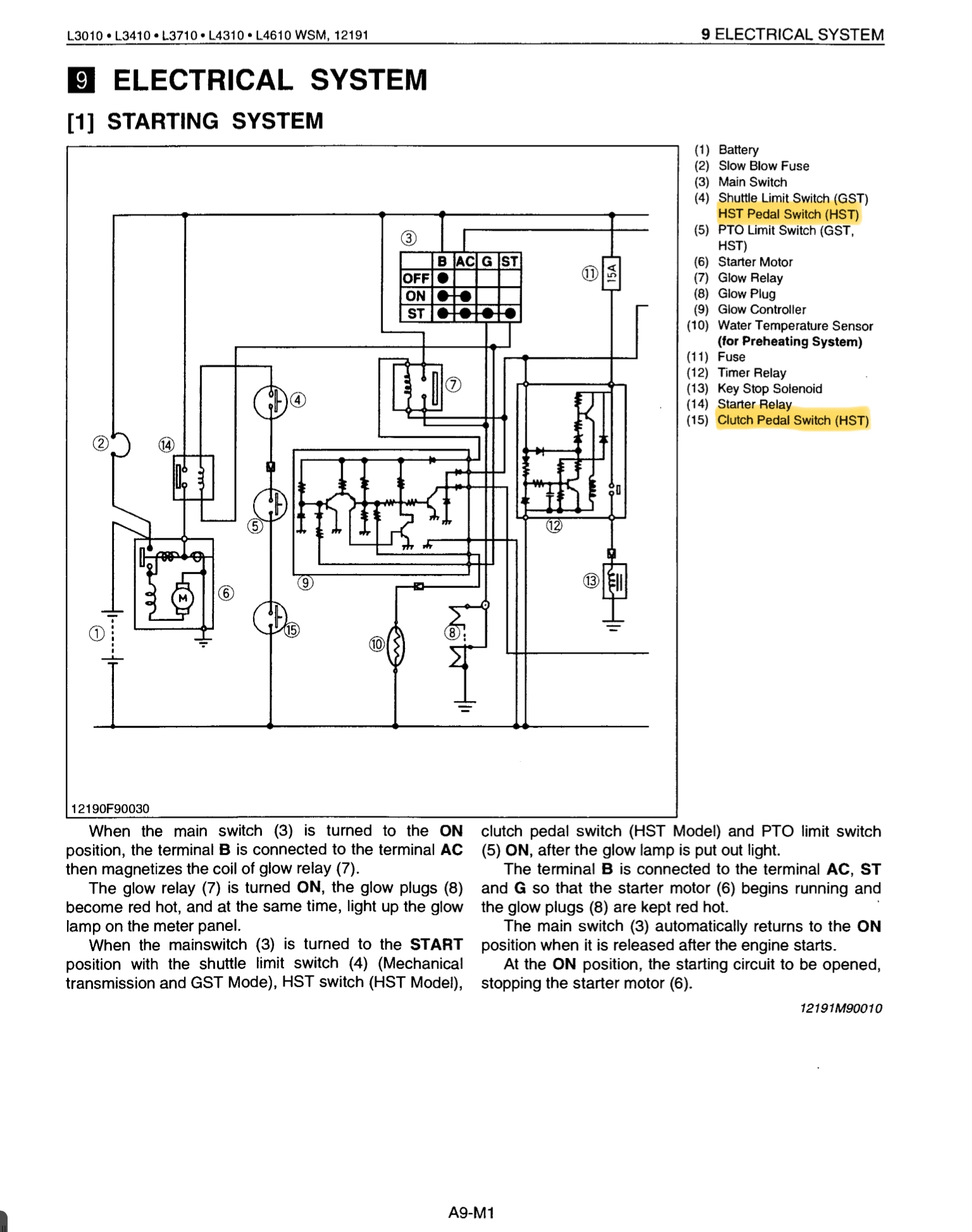

I have a Kubota L3710 with HST. It began refusing to crank this year.
I noticed that the tractor would start when I jiggled the F/R pedal, so I thought there had to be a sensor somewhere that prevented the tractor from starting unless the pedal was disengaged. I have since been told this model has no such sensor. I could not find one when I crawled under it, and I can't find one on diagrams.
Today I needed to pull my Dodge Ram out so a tow truck could take it in for work, and the Kubota started acting up again. I finally had to give up and pull the Kubota and truck with a JD garden tractor. I told the tow guy the Kubota would start right up as soon as he left, and sure enough, that's what it did. Irritating.
The tractor runs until I shut it off. The mystery issue does not shut the engine down. Someone suggested there could be a problem with the neutral safety switch. I don't know if that would shut a running engine down.
What is the most likely problem?
The dash lights turn on, except for the glow plug light. When the tractor actually cranks, the glow plug lights up. I think.
