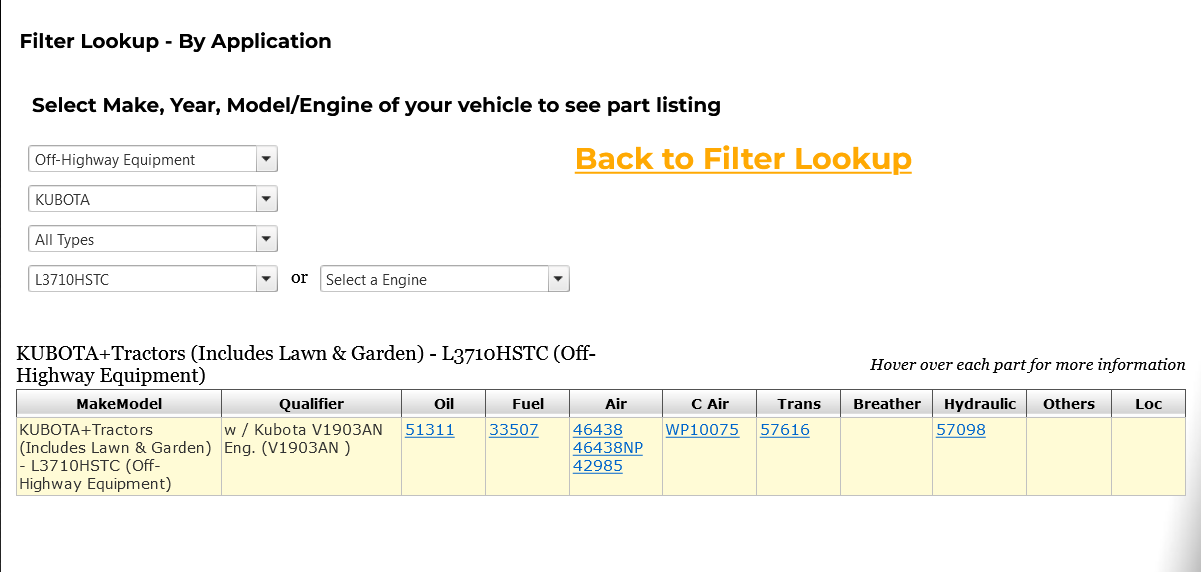

From Wix

Mobil 1 filters are not that great. If they have an A on the end they are made by purolator. Rating is 99% at 30 microns
The Fram everyone is bashing you can get at walmart for probably less and is 99% at 20 microns (XG16) Fram makes perfectly fine filters.
Edit: adding in the wix. 51311 50%@6um and 95%@20um so it's very respectable and would be a great choice over the Mobil 1
In the end both will work without issue (probably :) ). I personally don't like purolator because of all the tears in the media I've seen and experienced.
