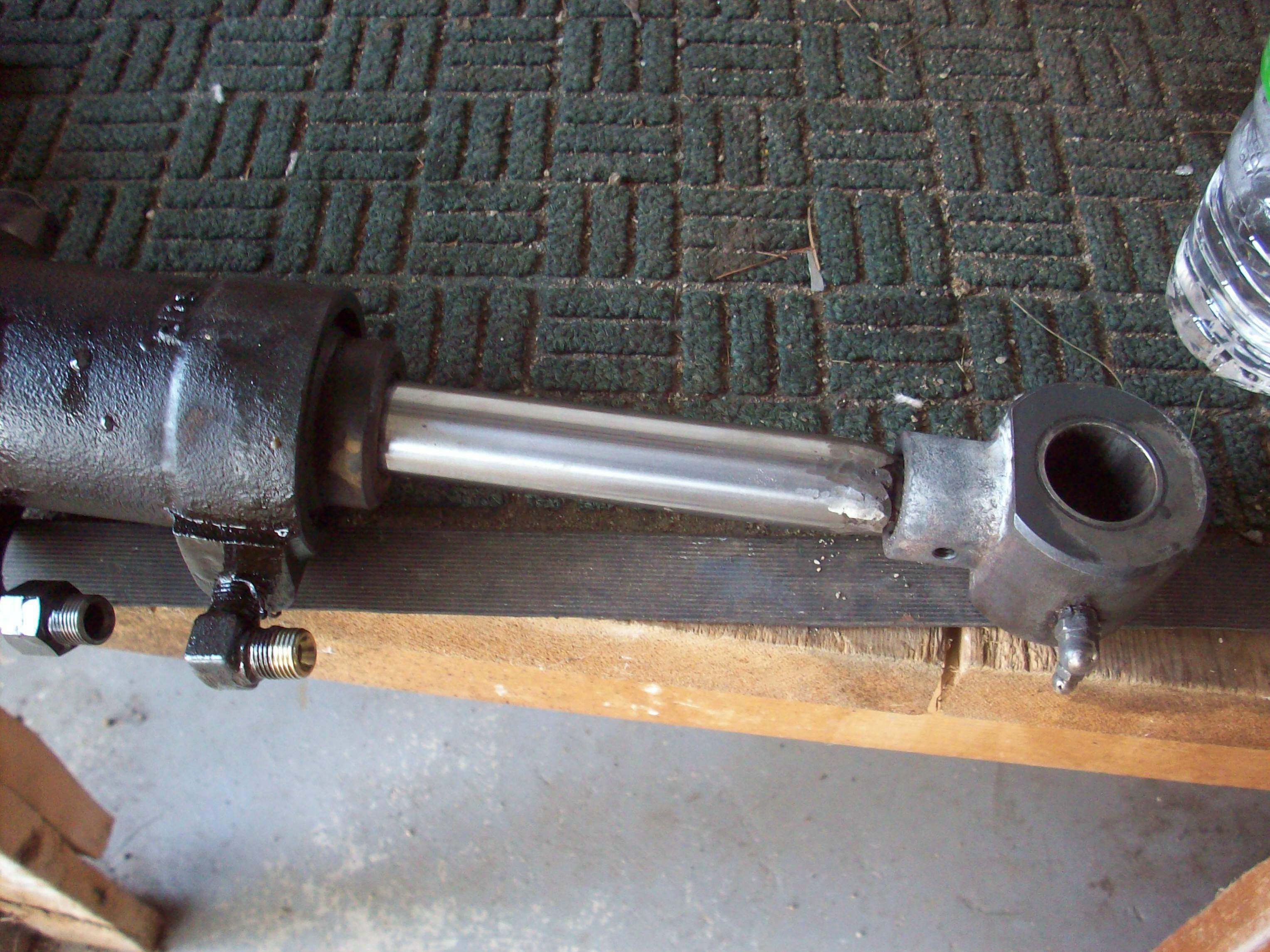

its ben a few years since i broke anything so im back. broke my stering moving snow this winter. hydraulic rod broke off at the thread part that screws into . weled it back together. should be ok. have hole in front engine cover as results of stering breaking hiting.dont think i want to replace engine cover. lot of tear down. was thinking of jb welding it to keep the oil in. i know there a little aluminum got inside. was thinking of geting a small scope to see inside and get out particles. anyone else done the jb weld. thanks bill

Bill you may have better luck with a piece of fiberglass matting to cover the hole then using seal all. I didn't have any luck with JB weld on an oil pan and I was able to get at it from both sides.
   / kubota l3600 repairs
think im going to try the jb weld with some screen to help it stay put. if dosnt work try diferent product or do the complete tear down repair or replace part. thanks bill
