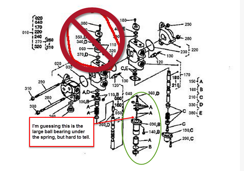

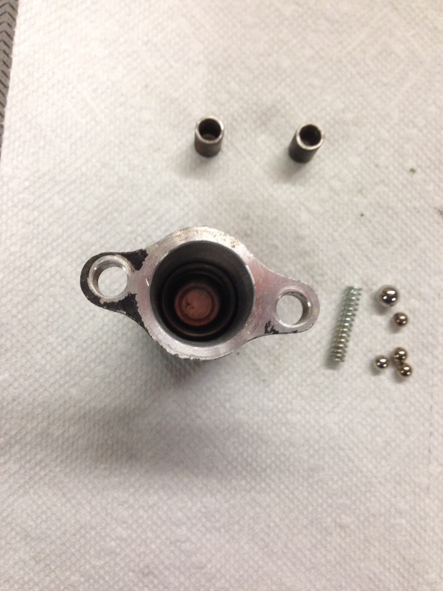

I removed the bottom of the valve to clean / remove any water (there was no water by the way) and unfortunately have no idea how this goes back together. First pic is of the pieces that came out when I removed the two allen screws. There are 4 small ball bearing, one larger one and a spring. All look to be in good shape.
This is what wa revealed when I removed the bottom of the valve cover. The little holes are where the 4 small ball bearings go. My question is, in which order/sequence do the larger ball bearing and spring go? I've tried a few ways and now the lever wont even go into float at all.

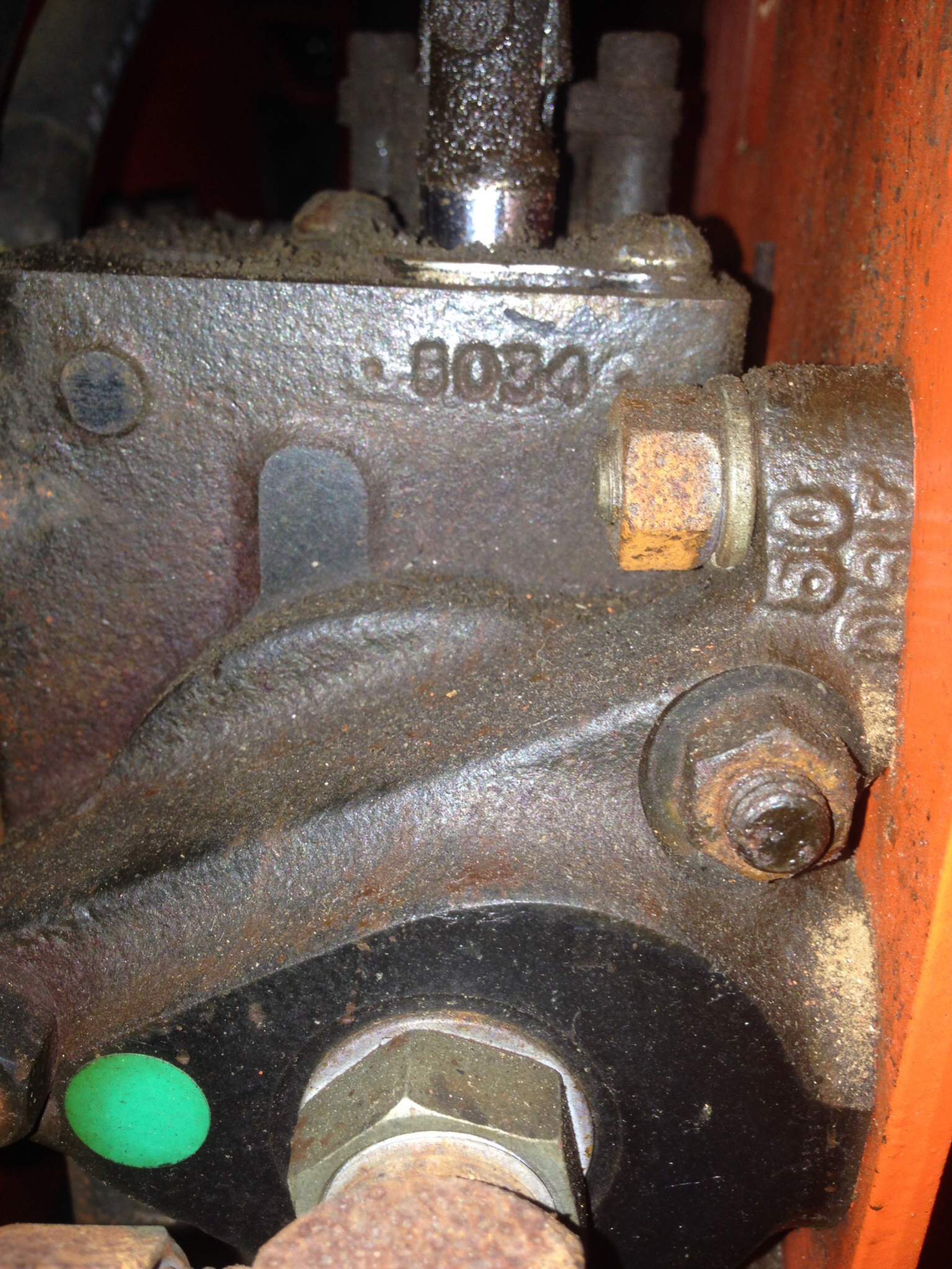

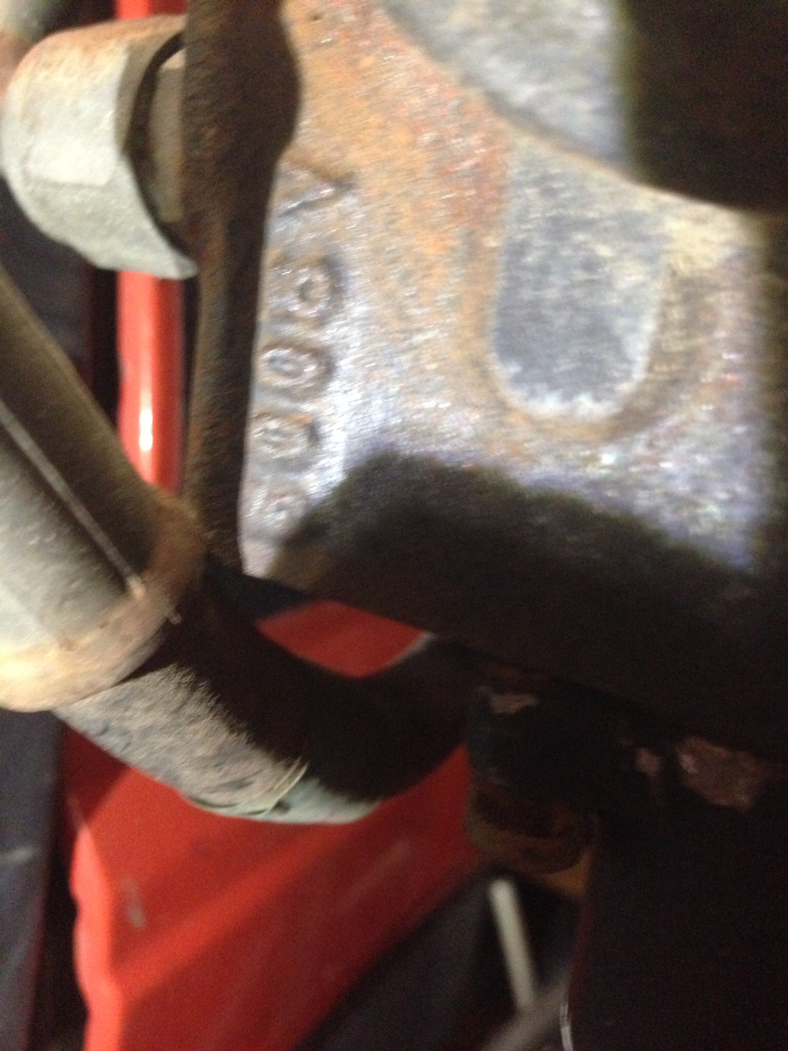

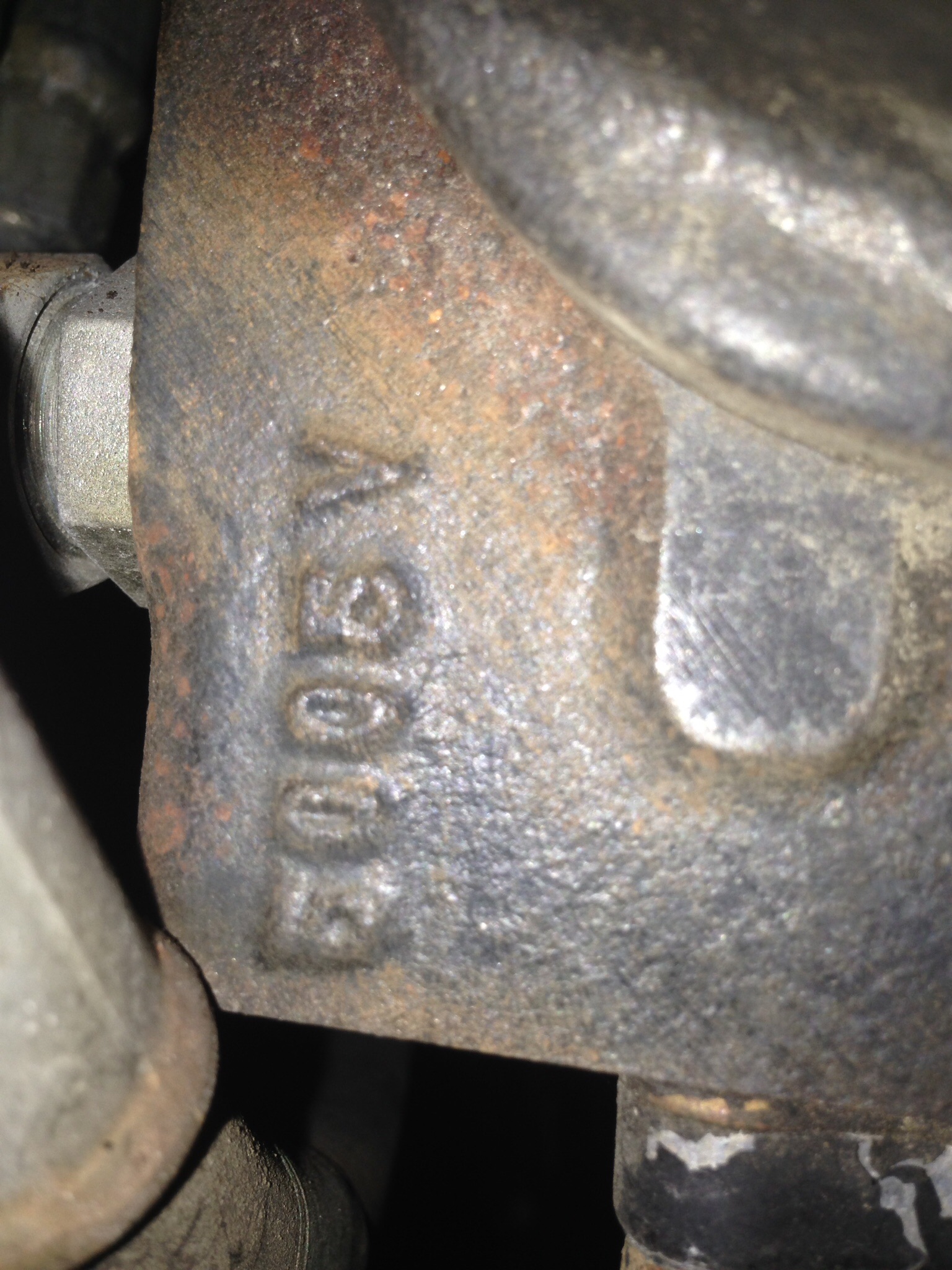

I tried finding an exploded view / diagram last night for hours but had no luck. Problem is, I don't really know what kind of valve body this is. The numbers that are stamped into it have been no help. See pics below
The kicker in all of this is that after I took this apart, when I was back online trying to figure out how it went back together, I found another post about the 3 point hitch being a potential source of the problem I have been experiencing. Sure enough, when I lowered the 3 point hitch from the highest point (where it had been left) to the middle of the range, the FEL now works normally. Except for the lack of being able to go into Float as a result of me taking this thing apart. :(
So, the good news is if I can get this back together the right way, I should be all set. I did find this post just this morning. I inserted the same image with my markups below. I believe this is the right diagram since my FEL is a LA680 as well. It appears so when I look at the diagram. It looks like the larger single ball bearing sits at the bottom under the spring. It's hard to see for sure, but I think that's how it looks. Help!?!?!?
Thanks for your help in advance!!!
   / Kubota L3600 FEL hydraulic problem #9
You might need to rebuild the valve -- sounds to me like some of the internal seals are bad. However, your description could be a red herring if it's just the detent mechanism jammed up, and confusing location of the valve's center position. I believe you can get a new detent end kit (cap and guts) if those pieces look worn or broken.
With the detent cap off, does the lever move smoothly in both directions? That would tell us if the problem was caused by a jammed/worn detent mechanism.
Everything moves very smoothly with the detent (now I know what this is called, thank you) cap off and the valve looks very smooth and clean when I look at it. What's weird is the larger ball bearing and spring seem to have way to much room in the bottom of the detent cap, it's not a nice snug fit. Makes it nearly impossible to put it back on... Almost seems like something is missing to hold it all together. However, I was careful when I removed it, and believe I got all of the pieces. Refer to the image in my post above. Is anything missing that should be there?
