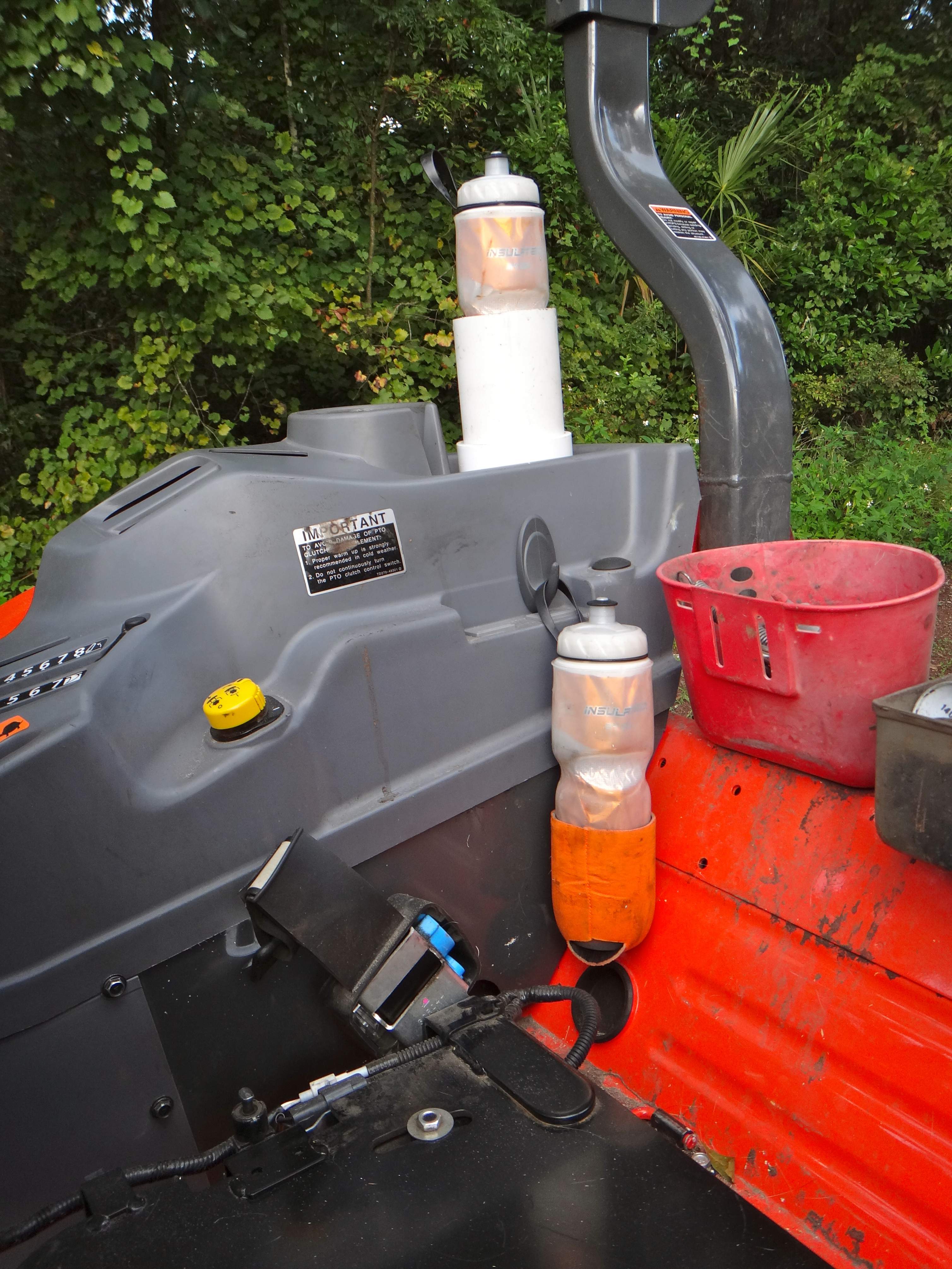

Factory provision for maintaining water conveniently to hand on the L3560 is inadequate.
The factory "Cup Holder" does not fit the standard 2-3/4" dimension of US liquid containers. It is useless. L3560 is manufactured and assembled in Japan. Cup holder probably holds standard Japanese containers securely.
Photo #1 3" PVC pipe (Schedule 40) with a flat 3" PVC cap, mounted to console through factory 8mm X 1.5 mm threaded hole. PVC caps come in two types: Flat and convex. You need a FLAT cap. You also need a longer 8mm X 1.5mm bolt. I did not glue the two PVC components together, so they could be separated for cleaning.
Photo #2 Plastic glue-on hook. I have since secured this with a small self-tapping screw through the hook mount into the console.

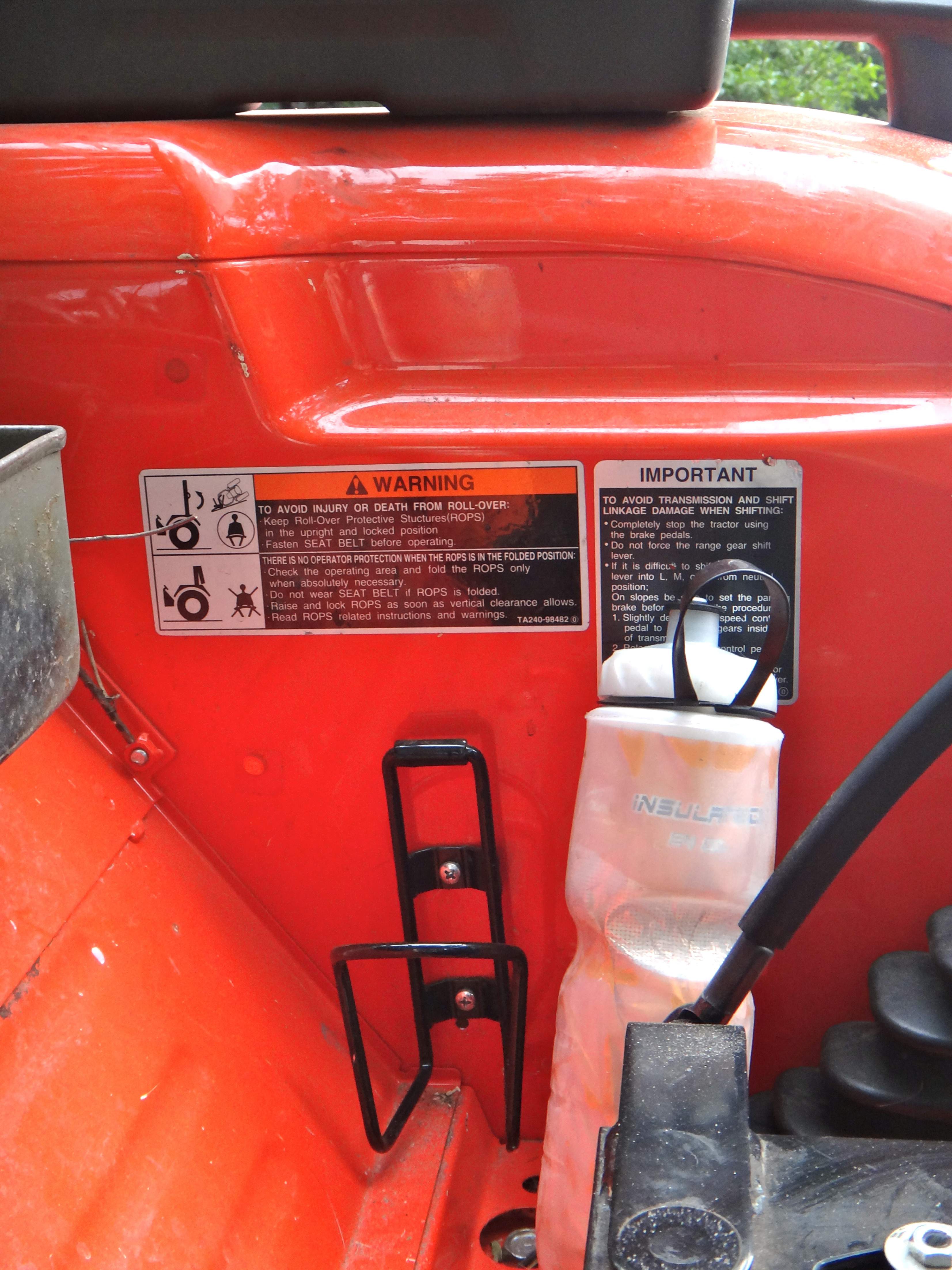

Photo #3 + #4 $4.99 bicycle water bottle bolted through fender on left side of tractor.
Bottles are 2-3/4", 25 ounce, Polar (brand) insulated containers, most often used on bicycles. I like to put 3" of water in the bottom, then store them in the freezer, so water is iced on the job. Polar containers are $10.00

In post#3, where do you get those wire bottle holders? I could use a few of those.
Thanks,
   / Kubota L3560 Paraphernalia Storage on Tractor #8
Thanks!

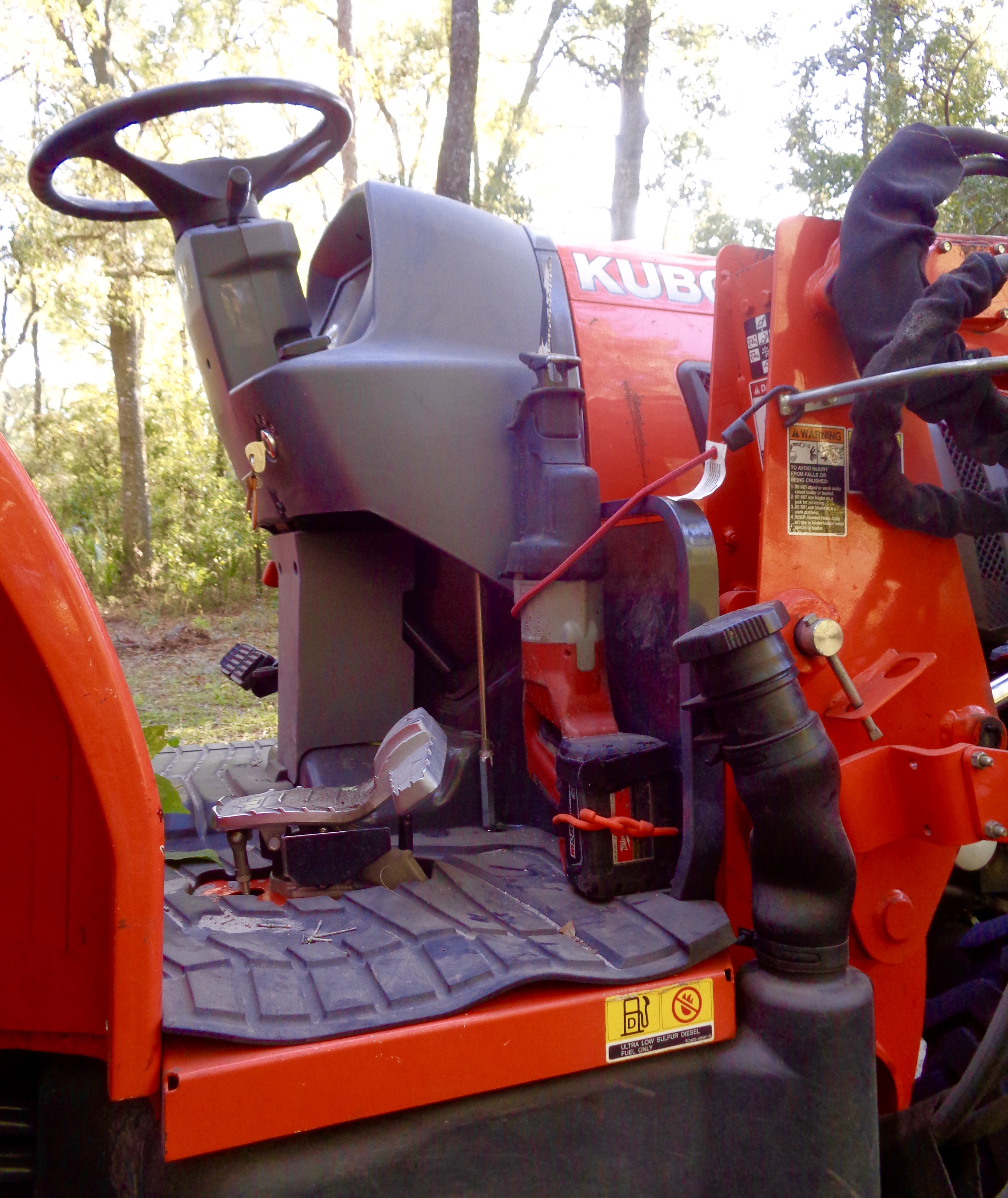

Finally figured out a SIMPLE 18" bungee cord restraint/mount for my 28 volt Milwaukee reciprocating saw; out-of-the-way when I am on the tractor, ready-to-hand when I am standing on the ground.
Saw has remained securely in place for two weeks despite many removals and returns as I clean up Hurricane Irma debris in Florida.
