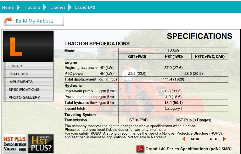

The L3540 is not discontinued. Go to Kubota Tractor Corporation. Click on "Products" > "Tractor", on the next page click on "L series." At the "L Series" page click "Grand L40." Once you are at that page with the big "L," click on "Specifications" and you will see the L3240 specs come up. Click "Next" to see the 3540 specs. You can also click on the "Grand L40 Series Specifications" to open the PDF file that shows all the L series tractor specs.
The Case DX35 is a very good tractor. You have a 2 range HST with a high/low for each range, very good engine and the ergonomics on that tractor are excellent.
The Kubota 3540 is also a very good tractor. The HST on the tractor is superior as you have a 3 range HST with a high/low for each range, load sensing, HST response control and auto throttle advance. In addition, the tractor has a little more lift capacity at the 3PH and a very good engine.
Tough call, but if you can swing the extra dollars, you might be better off with the Kubota in the long run.
