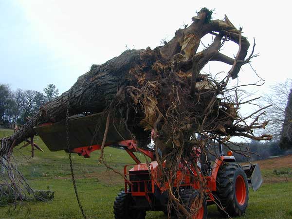

I now own a L3830 after having had a L48. Biggest reason for the switch was being able to remove the loader, a huge benefit when mowing, even if in open fields. The other reason was that the L48 had a top speed in medium range with it's HST of 4.5 mph while the L3830 HST is 7.5 or so. A big difference when mowing especially since those speeds are based at 540 RPM PTO speed or about 2600 RPM on the engine which I rarely if ever use. While the L48 could do all of its work at about 1800 RPM, the L3830 is about 2300 RPM. Funny thing is though, the L3830 with a 3 cylinder is quieter then the L48 with a 4 cylinder which already was pretty quiet. The advantage the L4330 has over the L3830 is loader lift ability, the engine performance is in my opinion barely noticeable between the two. The 4 cylinder on the L4330 is certainly not any smoother or quieter, the LA 853 loader is noticeably larger and like the LA 723 on mine, is very well made especially when contrasted with those on JD's comparable compacts. I would consider the L4330 or L3830 for your needs based on what you have mentioned and of course with HST. Rat...
I've posted this picture before, but here is my L48 with a tree I removed quite easily. The power of the L48's loader is huge compared to the L3830 or L4330. Rat...

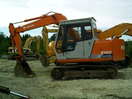

I apologize for my ignorance, but is a "12,000 lb Hitach" an excavator, dozer???
The vast majority of the trees on my land are beech. I was planning to cut the trees down and then remove the stumps with the TLB. I was going to dig a hole in the ground at the edge of the property for a stump dump.
Thank you all for your feedback. It's making me think twice about the investment.
Carp
   / Kubota L35, 3830, or 4330 #8
<font color="green"> I apologize for my ignorance, but is a "12,000 lb Hitach" an excavator, dozer??? </font>
It is a small excavator, (backhoe). As far as backhoes go, 12,000lbs is light. The more weight you have, the easier it is to use. If you don't have a way to tow it to the property, figure on around $75 to $100 for delivery and return. The one that is attached is located in Milford, NH and will run around 14K to buy. Easily outdig any compact tractor for not too much more money than a backhoe attachment would cost.
