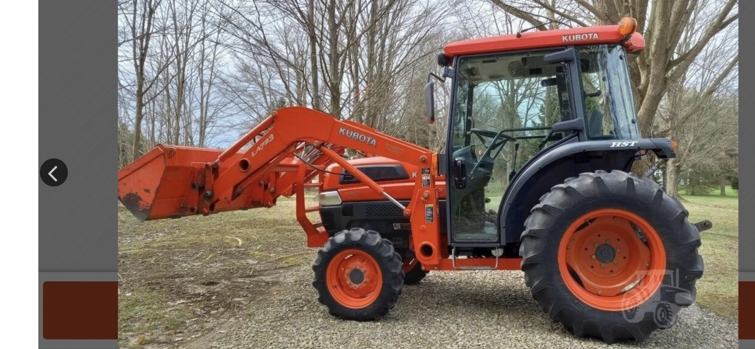

I have a 2005 Kubota L3430 I’m picking up this week but prefer to run turf tires or R4’s and not the R1’s that are on it. The tractor has only 660 hours so tires are in incredible condition. Located in Marquette, Michigan. My pics are too big to upload.

you will more than likely have to get rims to, R1 rims are taller and narrower than R4 and turfs , You might find someone willing to trade.

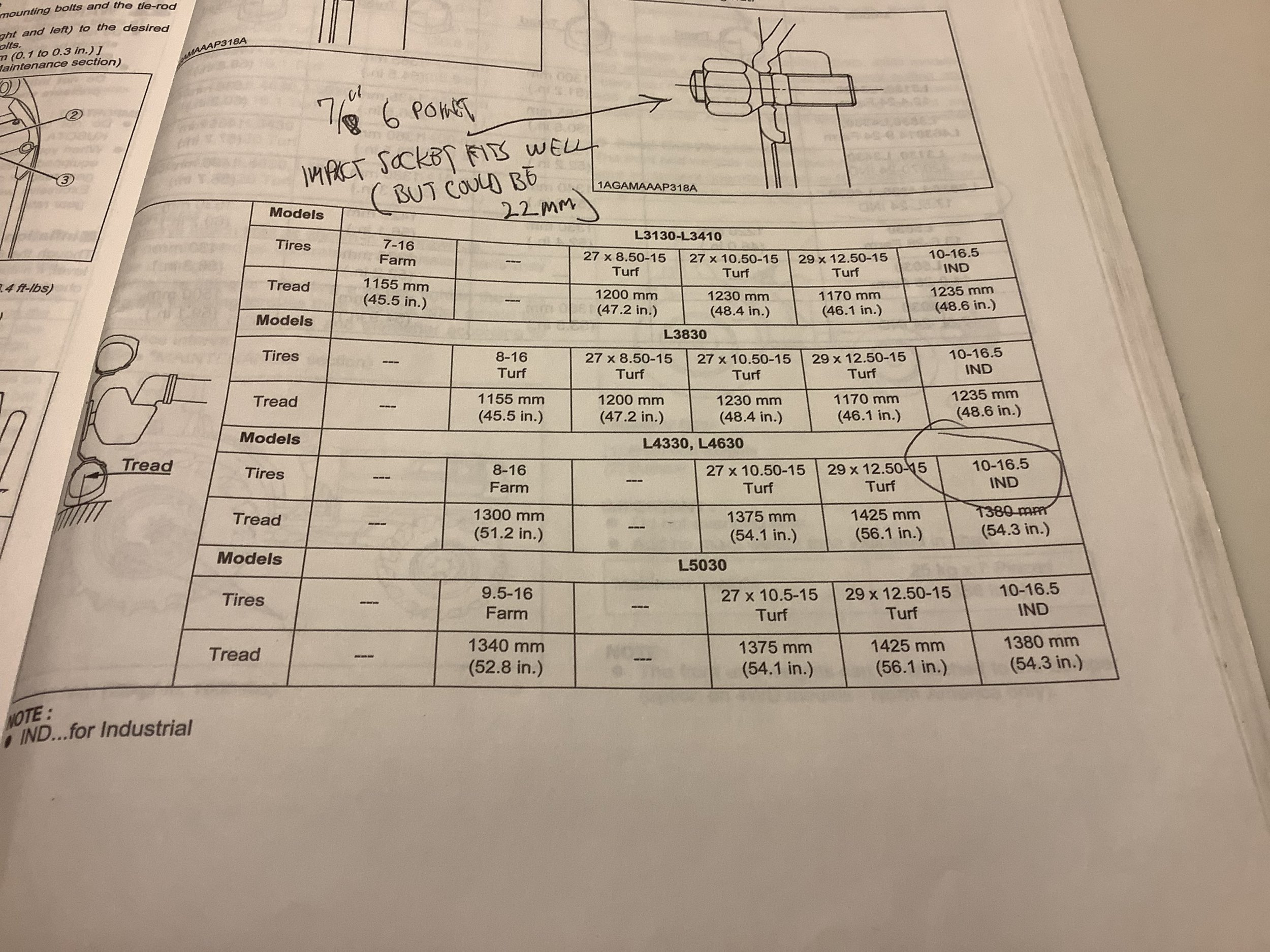

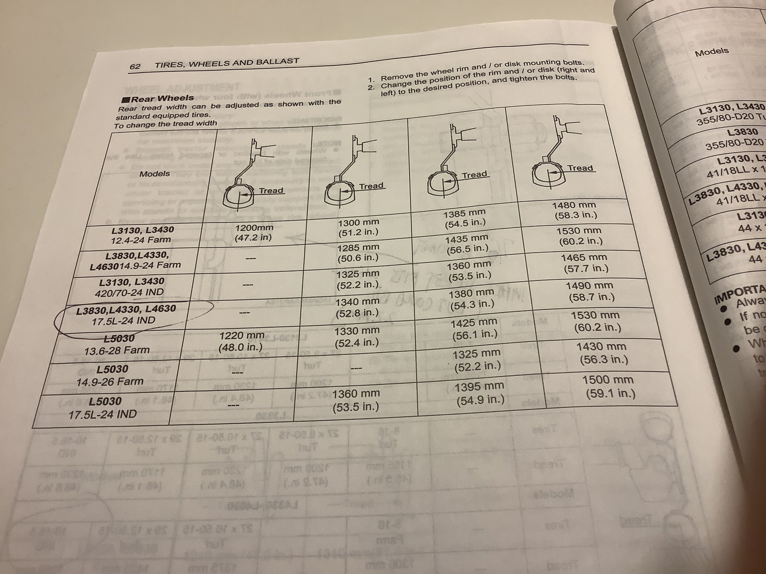

You might specify the tire size too, in case other Kubota models use the same wheels/tires.

FYI……My tires are the Ag(R1) type. Front are 7.2-16 and rears are 12.4-24.
