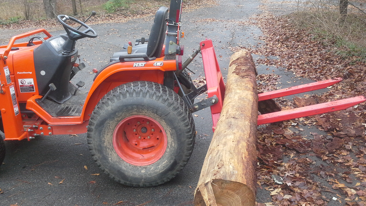

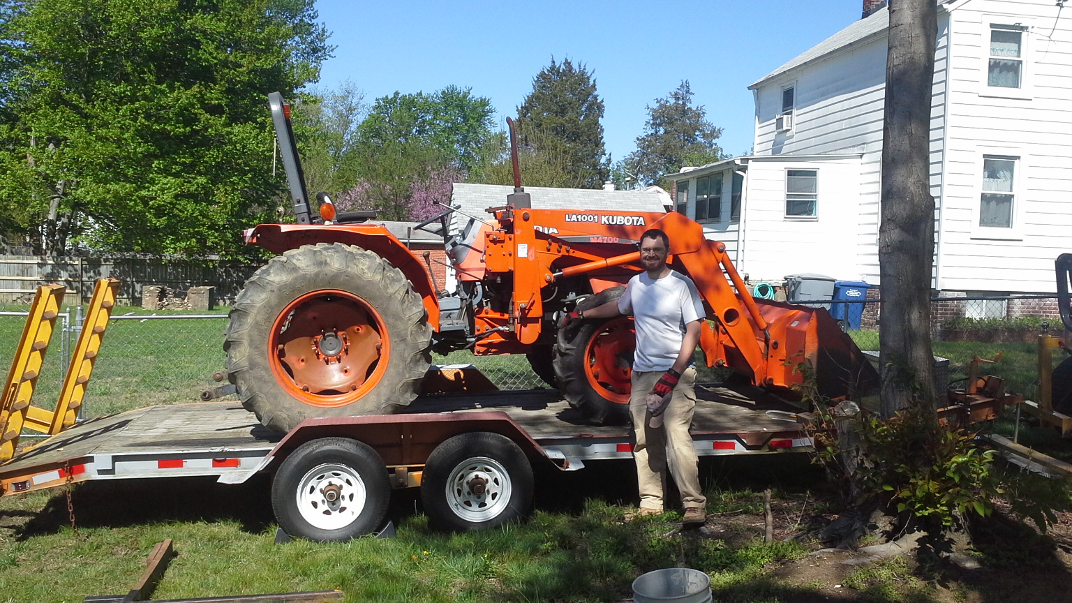

Treat is as your first tractor and be on the lookout for something bigger to LIFT logs with the FEL or develop a method to get the log loaded.
I've got a B7610 (which I knew was small) and it's great for moving the small stuff around. I've also got a Woodmizer LT 10 w/18' of track. But to put a 10 foot, 20" white oak log on my sawmill I need a lift of about 1500 lbs (unless I let it dry out). Now a 10' pine only weighs about 1100 pounds and I can handle that with the 3 point.
This log wasn't 20".
attachment.php
Now just for fun and jokes I have loaded a "full log" on my mill entirely by hand with a pair of cant hooks, but it ain't easy.
So I searched for something that would lift a ton on the 3 point and cost less than $15K.
Got this for $12K.
attachment.php
Supposedly lifts 2 ton on the 3 point and 1 ton on the FEL. Makes putting the logs on the mill REAL easy.

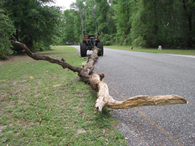

I would calculate max tree weight you want to transport to your mill, then select a tractor that will lift 125% or 150% of that load with the FEL for transport. I would not be dragging and collecting dirt on trees to be milled.
(Lift on the L3301 - LA525 FEL is around 1,100 pounds.) (Lift on the L3301 3-Pt is around 1,500 pounds.)
A grapple is optimum for moving trees. See STEPPENWOLFE's photo.
Less expensive option is SSQA (Skid Steer Quick Attach) pallet forks for moving trees.
I have aluminum Debris Forks but I lose some lift capacity due to fork mount on front of FEL bucket, so leverage works against me.
You can certainly use 3-Pt mounted pallet forks too, as in NEWBURY'S post, but FEL pallet forks offer more flexibility in loading and unloading, especially lift height.

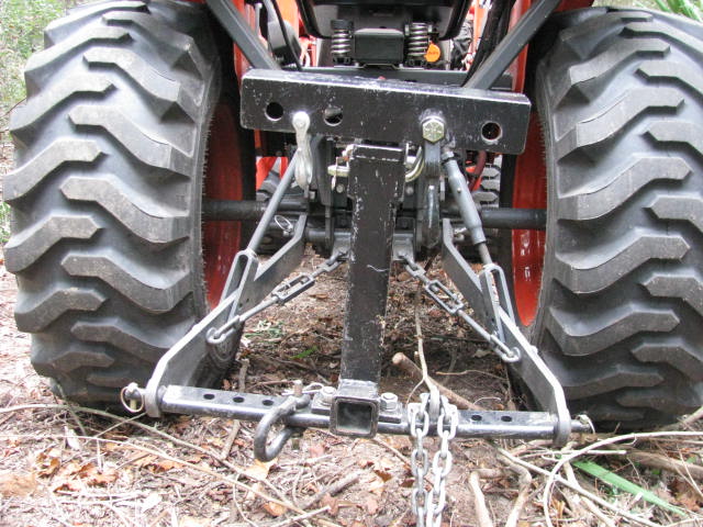

Agree 100%, but with a good skid plate on the 3-pt, you can elevate one butt and get very little dirt on the log when dragging. That's what I normally do. I think I paid about $125 for my skid plate on e-Bay, but they are easy to make with a welder and some square stock.
   / Kubota L3301- is this right for me? #7
Full cut chains on my Stihl MS261 retain sharpness a very long time so long as dirt/sand contact is nil to irreducible minimum. "Very little" dirt would be too much by my standards. Then there is the issue of unproductive time as dull chain is exchanged for a sharp chain.
While I occasionally have to skid a weather toppled tree, I only salvage the clean wood for chainsawing into firewood. Any part with visible dirt is segregated and carried to the burn pile on the Debris Forks.
I use an OMNI (brand) 3-Pt triangle-crossdrawbar, with an OMNI "hanging tree" to elevate logs when (rarely) skidding.
