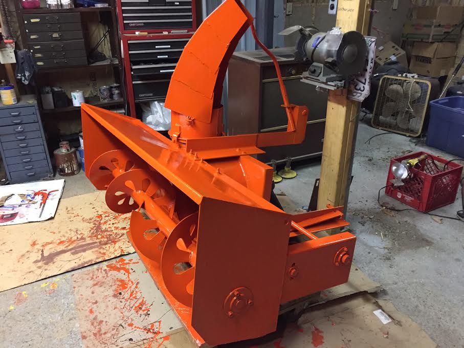

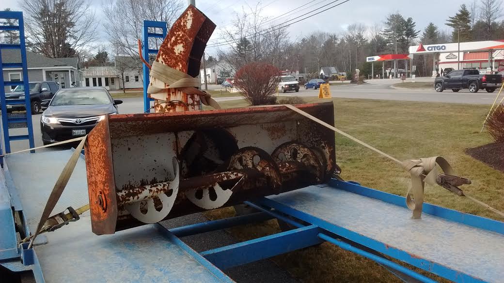

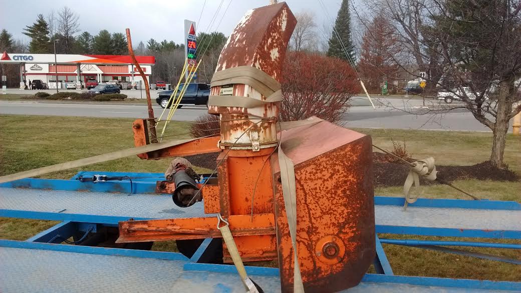

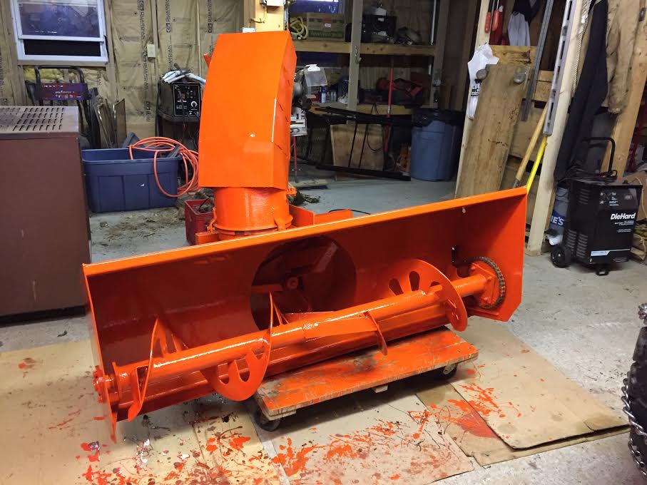

Hi all,
haven't posted for quite a while as everything running smooth and no questions. So that leads me to my latest purchase.
I just picked up for a very cheap price a Kubota L 321 snowblower. what I know so far is it is made by McKee and is also known as a Sno-lander 320 they also made these for John Deer. does any one have any info on these or manuals?
I have finished welding a few cracks, straighten a 3 point arm and putting new set screws in the gear on the shaft, as well as a full grind down and prime and paint job.All seems to be mechanically sound but any info on this 5 foot blower would be appreciated.

I have never heard of a manual for a McKee snowblower. Maybe they exist but I have never seen one.
The most important things would be keep it greased and oiled and replace the cutting edge when it is worn out.
I find keeping all fire wood and concrete blocks out of the way is important to.
I think it is fairly common to have to straighten the hitch on the McKee blowers.

Thanks for the input, I did find one manual on e-bay 50 bucks I think at that price I will figure it out on my own.
I like your idea on the 3 point arm fix if I bend mine after my repairs might just do that.
I fabricated a chute rotator out of a boat trailer winch for now using an arm that puts it right behind my seat of the tractor and a set of winch rollers seems to work pretty good.
