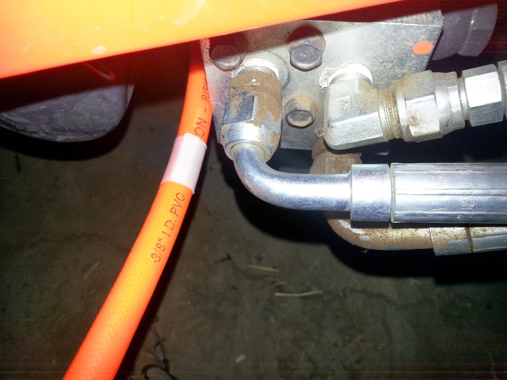

Can somebody help me identify the fitting type on the hydraulic block for the loader & 3pt?
IMG_20131117_192223.jpg That orange hose is just air hose I'm doing some measuring with.
Is everything 3/8"?
I see teflon tape or what not on the threads going into the block itself, so is it safe to assume those are NPTF?
Are the fittings on the hoses themselves JIC?
Have all hoses & what not measured for my TnT & 3rd function install, but realized I'm not sure what type of fittings & adapters I need to worry about.
   / Kubota L3200 fitting size & type? #2
I think they are 3/8 NPT into block and JC on the hose ends.
   / Kubota L3200 fitting size & type? #3
1/4" NPT is .540 OD (17/32) and 3/8 NPT is .675 (11/16)
In looking at the picture the NPT looks smaller than the #6 JIC which is 9/16-18 thread so I would suspect 1/4" NPT to #6 JIC
