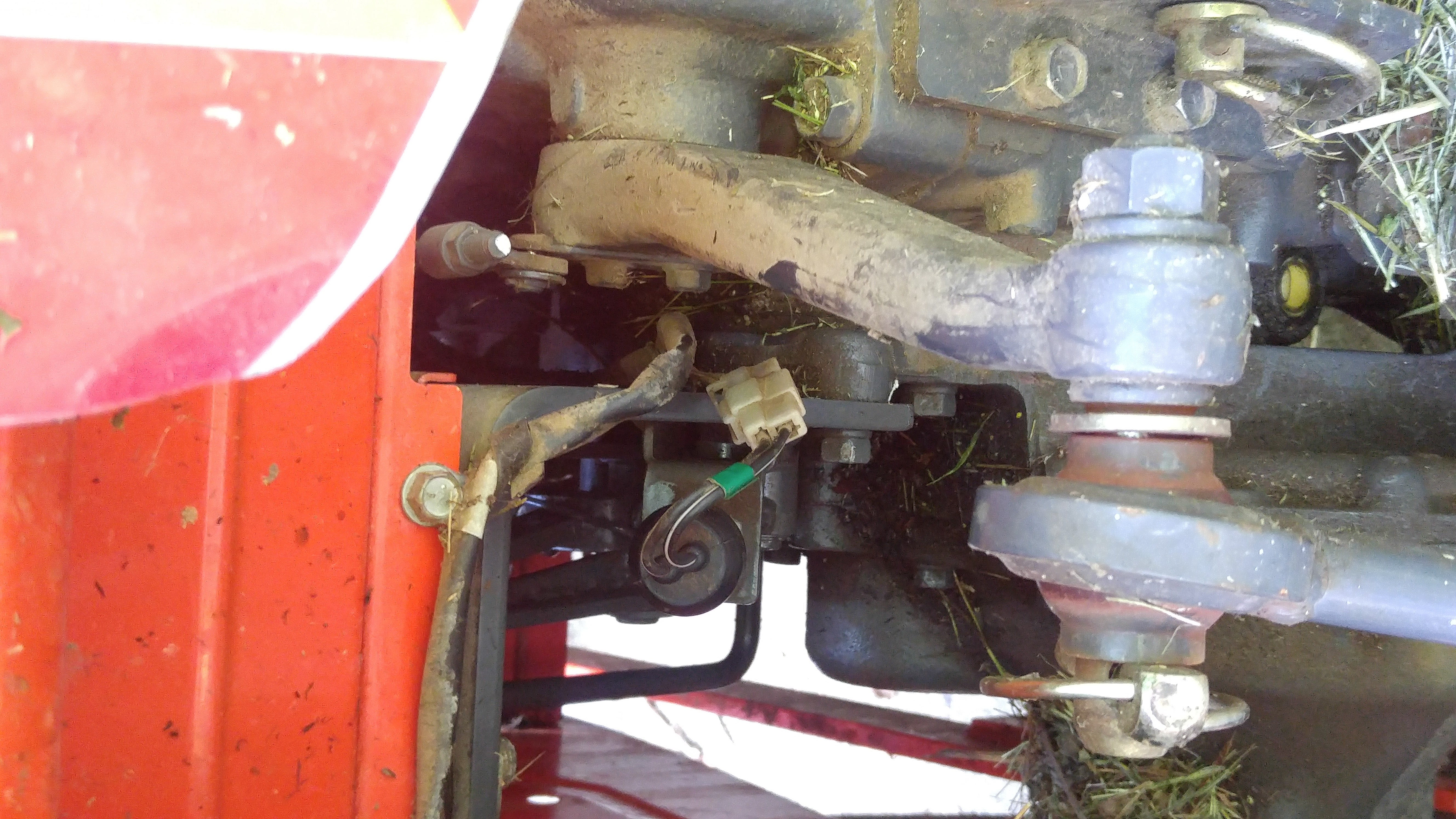

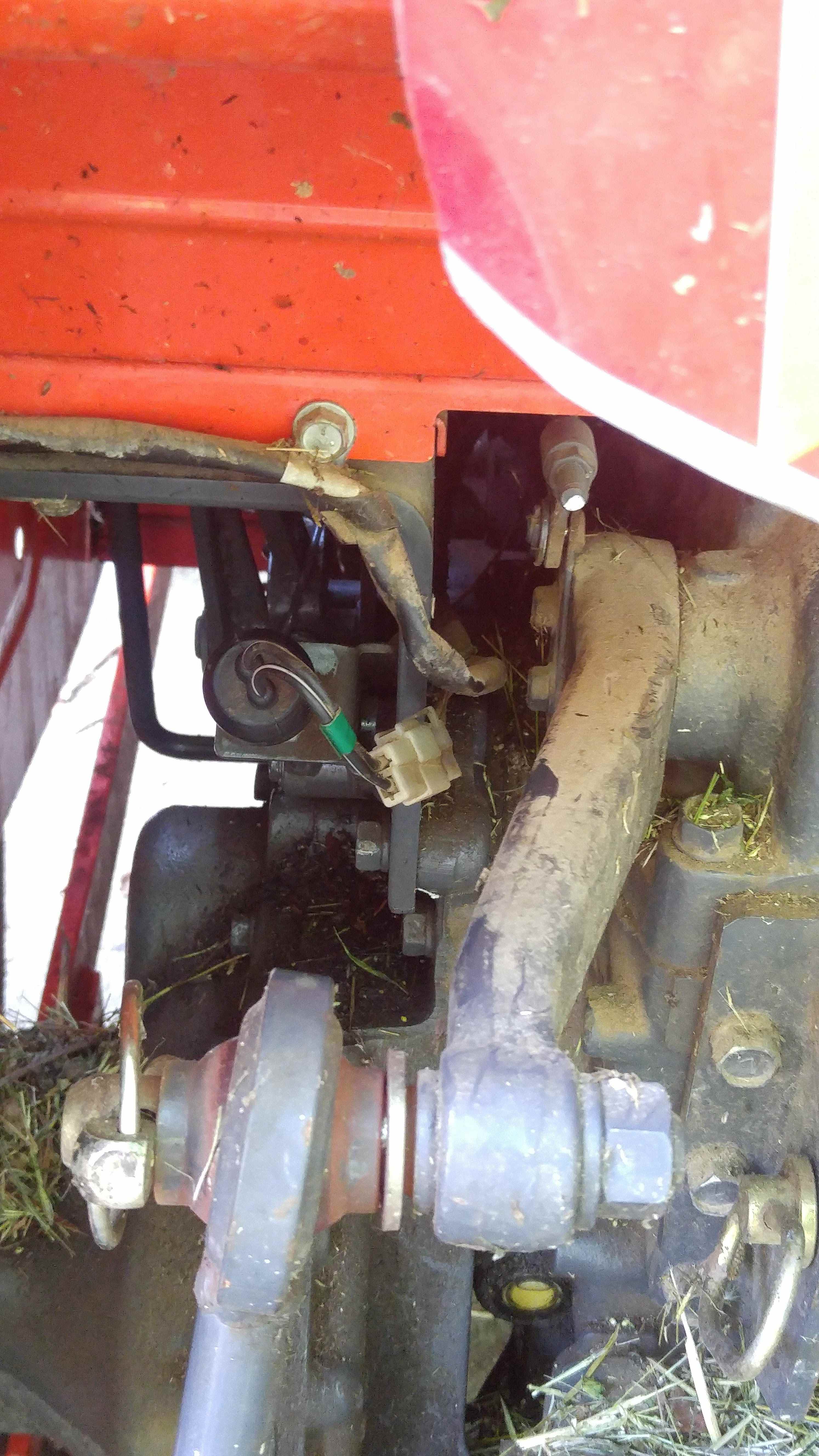

I noticed an electrical part near the shift lever linkages that looks like the neutral safety cut off. I cannot find the part on the parts list so I don稚 know the name of it or if it could be bad. It was heavily soaked with degreaser. I tried disconnecting and reconnecting, wiping connection, but no help. Here痴 a picture:

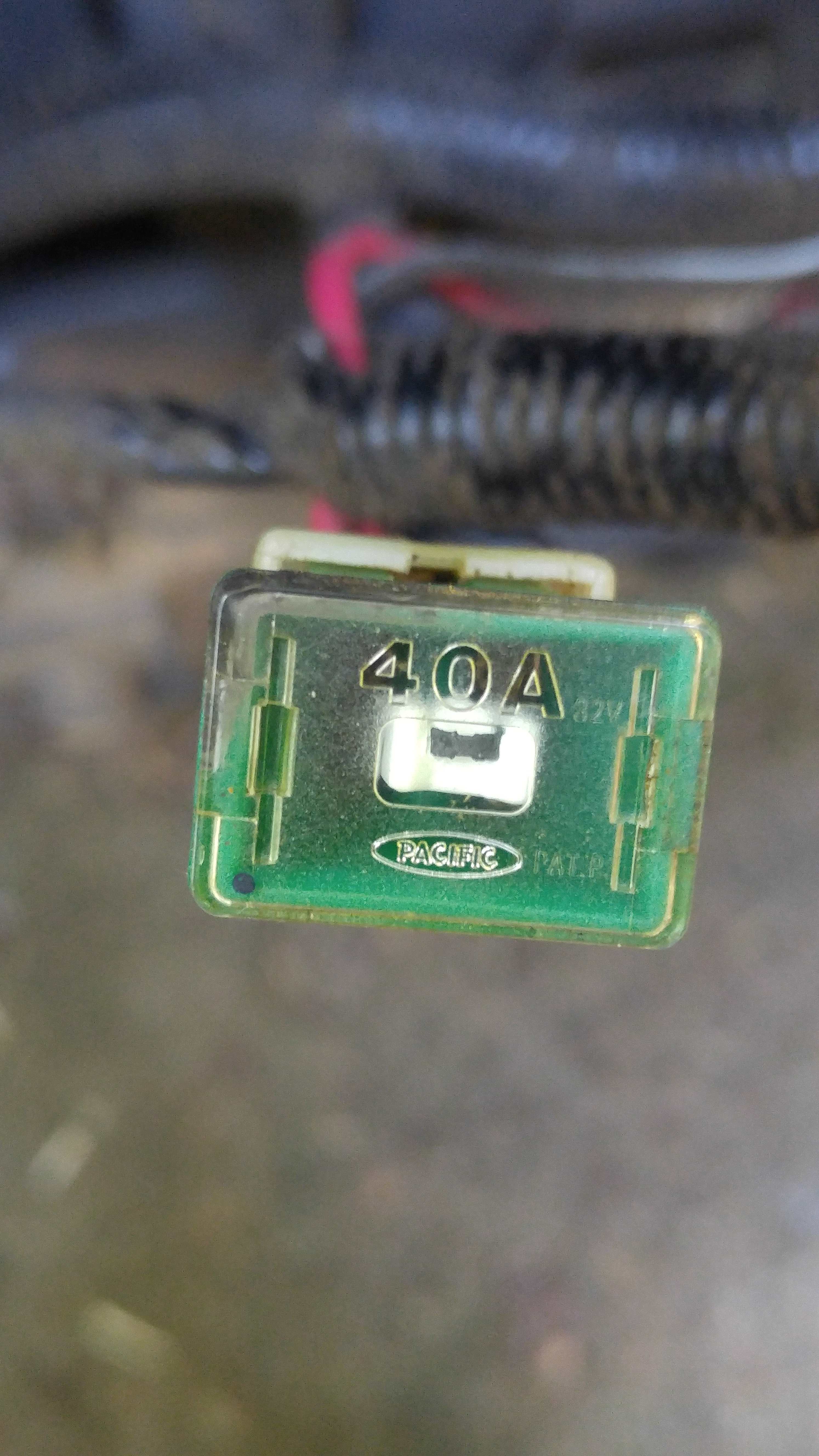

Assuming I have an entirely unrelated electrical issue I have questions about other parts. First, the easy one, thereç—´ a 40A fuse that looks like this:
I've not seen a fuse like this before so I cannot tell if it is blown. Would it be obvious?

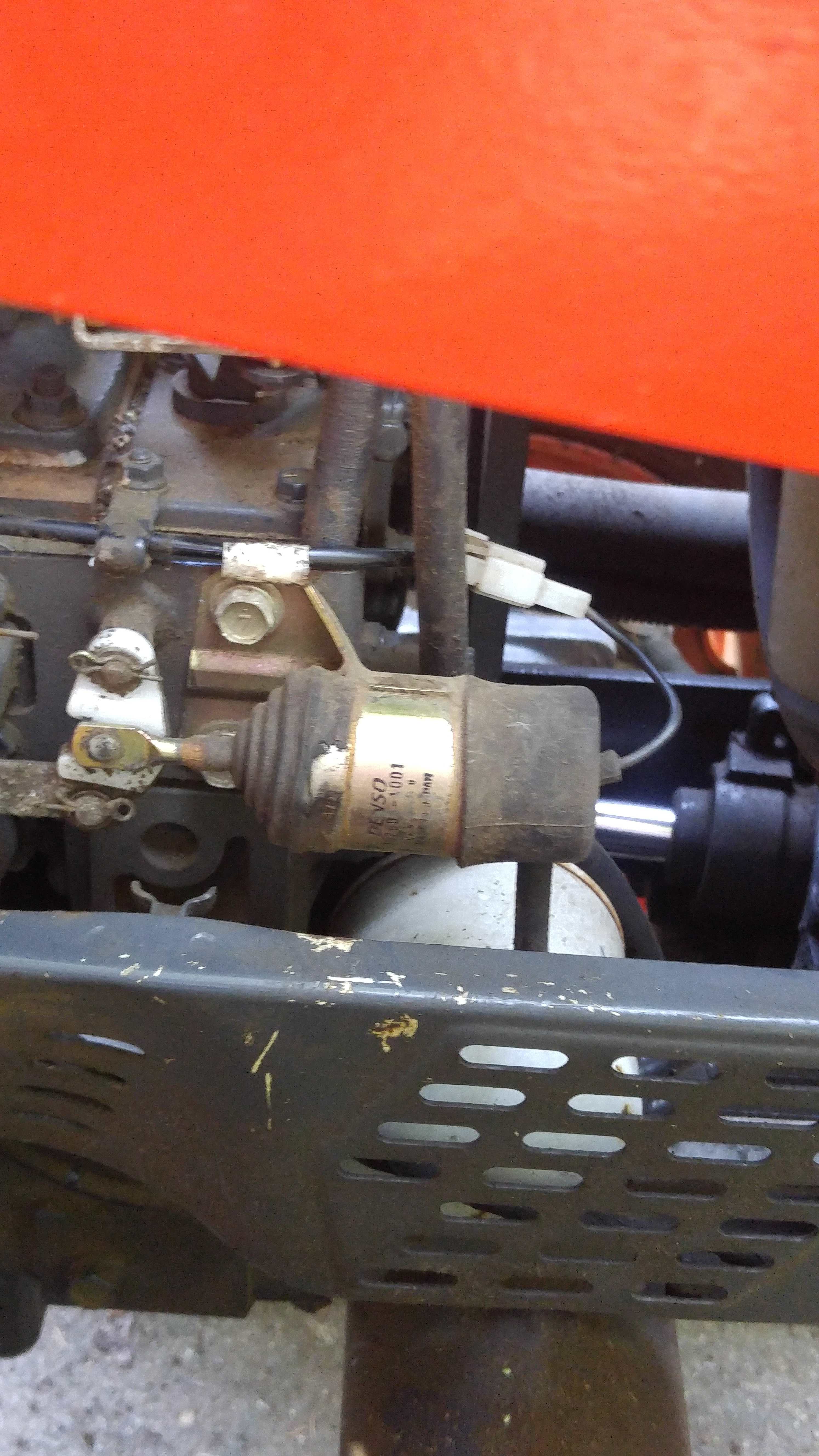

Also here's another part that I believe is the starter relay or solenoid. Again after hours of looking I cannot find it in parts diagram so I知 not sure. It says DENSO on it and google gives me links to starter and it's clearly not the starter. Here's a picture:

2. What is the name of the part in the first image and could it have gone bad from degreaser?
3. How can I tell if the fuse is blown?
4. Is there some way I can trouble-shoot the part in the last image?
Bob
This looks like a fueling actuator. Controls a valve allowing fuel to the injector pump.

Thanks for the reply. Yes, been wiggling those 2 things a lot. Doesn't seem to affect anything. And I do have a voltmeter though I'm not much of an electrician. When I remove the 40A fuse pictured above and probe the wire terminals I reads 12V. When I probe the resistance on the fuse it reads 10ohms (if I did it correct). I expected the fuse to show no resistance so I suspect that it may be/going bad but I'm not sure how it's supposed to work.
That makes sense because I can see the manual cutoff is connected to it and controls the switch.

Gotta love electrical problems oh and your maxifuse looks good I should add also my instrument cluster was having issues with lighting up
You must remove the fuse to check with an Ohm meter. It should measure the same value as the meter leads do when the tips are pressed together. Typically a fuse is either good or blown. Blown gives extremely high or infinite Ohms.
Is your meter digital or analog??

After some long delays due to family obligations, I finally figured out the problem. It is the neutral safety switch around the shift levers (below, not under, seat). After taking apart the dash and fiddling with the connections it still didn't start. Out of desperation I was looking at the shift lever linkage mechanism again and noticed that if I moved the levers into the forward position of neutral the linkage that presses on that switch would move about 1/10 of an inch higher to press the switch a little more firm...starts every single time now!
I thought the problem had to with that switch from the start because of the shifter issues I had earlier that same day. Correlation does not prove causation, except for when it does :) Thanks to everyone for your help on this!
