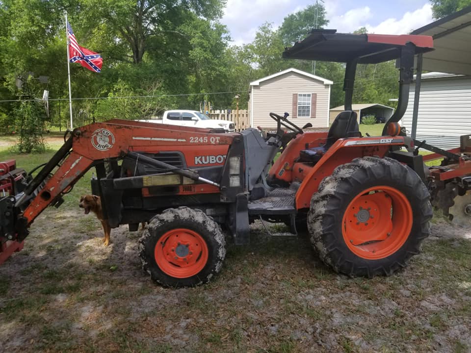

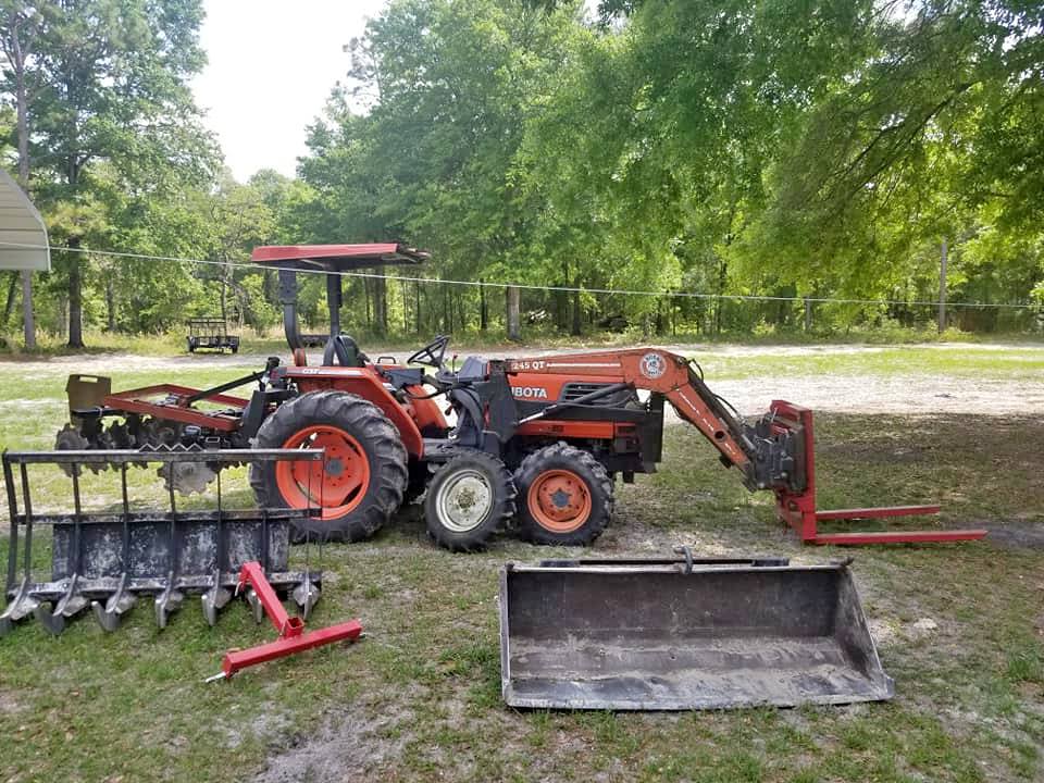

I have 4 acres. About half cleared and the other half had lots of pines standing until hurricane Michael came though, now they are all on the ground. Current tasks for the tractor would be to move enough dirt from the front to the back to fill in a pool and then help with moving all the downed trees. Considering one of the 4" or 6" PTO wood chippers to chip the branches and then get forks to put on the loader bucket to move the larger part of the trees to get them stacked in a more orderly manner.
I have found a Kubota L2900 with disc,root rake, bucket, forks quick connect front and back spare tire 4wd 2027 hours has glide shift transmission. The guy is asking $10K. I know nothing about tractors. Does that price sound reasonable? Due to past experience with an older Kubota and the unavailability of parts, is there any way to determine the year of manufacture and a way to determine parts availability of this tractor?

Tractordata.com says that the L2900 was manufactured from 1994-1999. I don' have any idea of parts availability.
   / Kubota L2900 #3
We had the same tractor it was a warhorse for its size With 10K down at the Bota dealer you could probably by a new one (compact) and find or buy new inmplements and owe who knows $12k ?
I think finding sheet metal parts for the L2900 would be difficult . Whats the tractor look like has it slept indoors all its life ? What kind of implements are they name brand or big box store stuff ? Maybe you can post some pics. Remember its purt near 20 years old . Without seeing it I'd say $8500 -$9k . How long has it been for sale ? Whenever I make a major purchase i always ask myself if i had to sell it in 6 months could or would i be able to break even and get my money back ? Just my thoughts .

Kubota L2900 = 2,700 pounds, bare tractor weight. Loader lift when new = 1,058 pounds.
