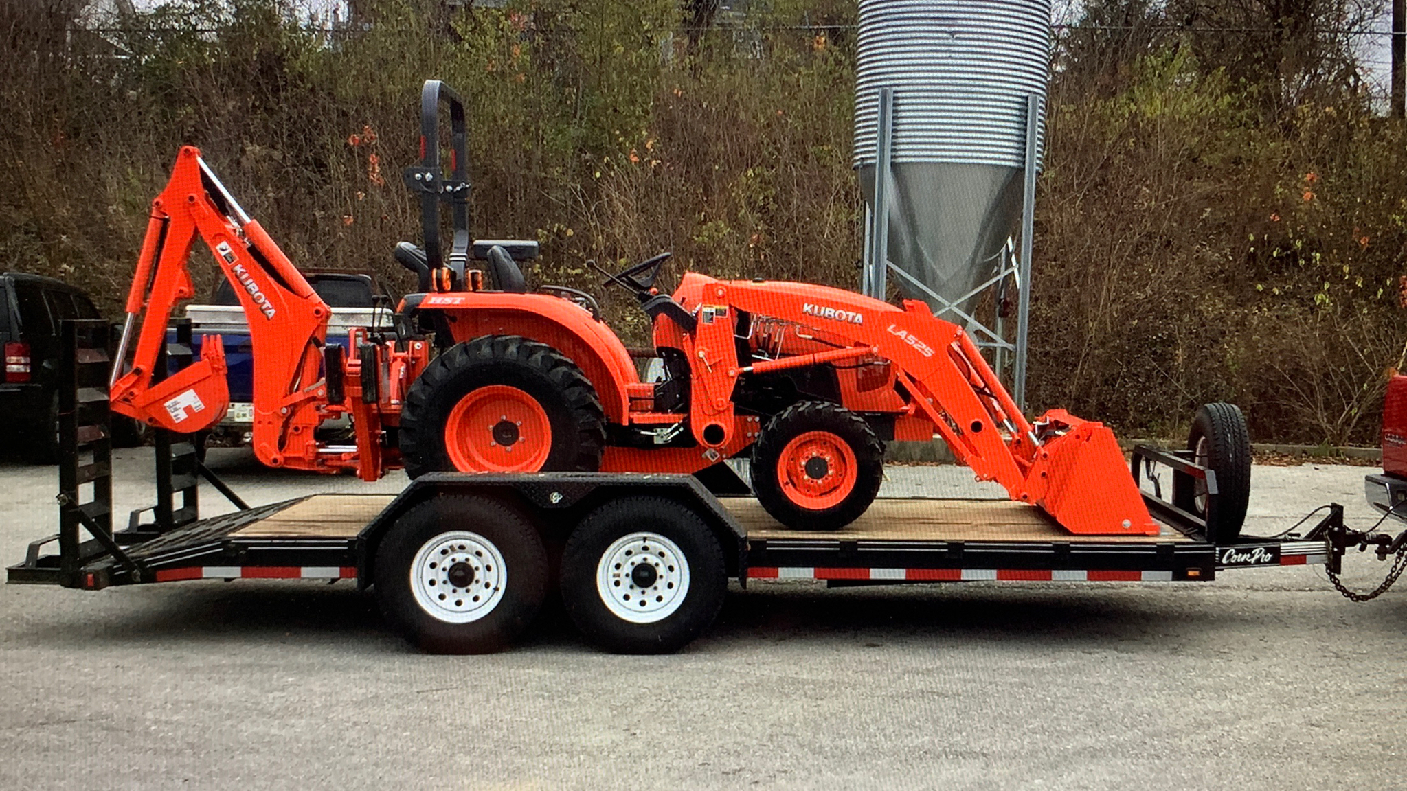

Does anyone know the length of a kubota L2501 tractor with LA525 loader?
   / Kubota L2501 #2
The length of an L2501 without the TPH is 111".
Laid down, the Loader adds some increment to 111" length. Elevated, as is often the case on a trailer, the Loader adds zero.
   / Kubota L2501 #3
I disagree. Loader adds a lot length on a trailer or anywhere else. LOL!
Back of rear tire to front of bucket 158”.
Back or rear tire to front bumper (loader bumper) 111”.
Please note I’m not measuring 3 point hitch because I don’t have installed.
Trailering a loader with the bucket raised is an excellent way to get a driving award. However far the bucket is raised it will ALWAYS extend further forward than the grille or grille guard.

Why not provide the measure sought by Louman from your L3301?
Didn’t have access to my tractor.
OP here’s your measurements.
