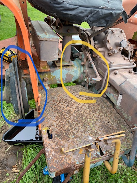

Hello guys, can someone assist with where the brake pad location is? Right back brake is locked up I think. See pics, is it in the yellow circle/arrow or the blue circle area? Kubota L245 brake pic1.JPGKubota l245 brake pic2.JPG
   / Kubota L245H brake pad location? #2
Not familiar with this tractor, but am pretty sure, although not positive, it is the inner location you have marked in yellow. This is based solely on review of parts diagram on Messicks website.
Try following the brake pedals mechanism shaft and rods under the floor pan
   / Kubota L245H brake pad location? #3
Yes, it's the location market with the yellow circle. If you really want to access the brakes, you'll need to take the axle case off. It's a wet brake system.
You can download the parts manual here: Index of Kubotabooks/Tractor Parts Manuals/
