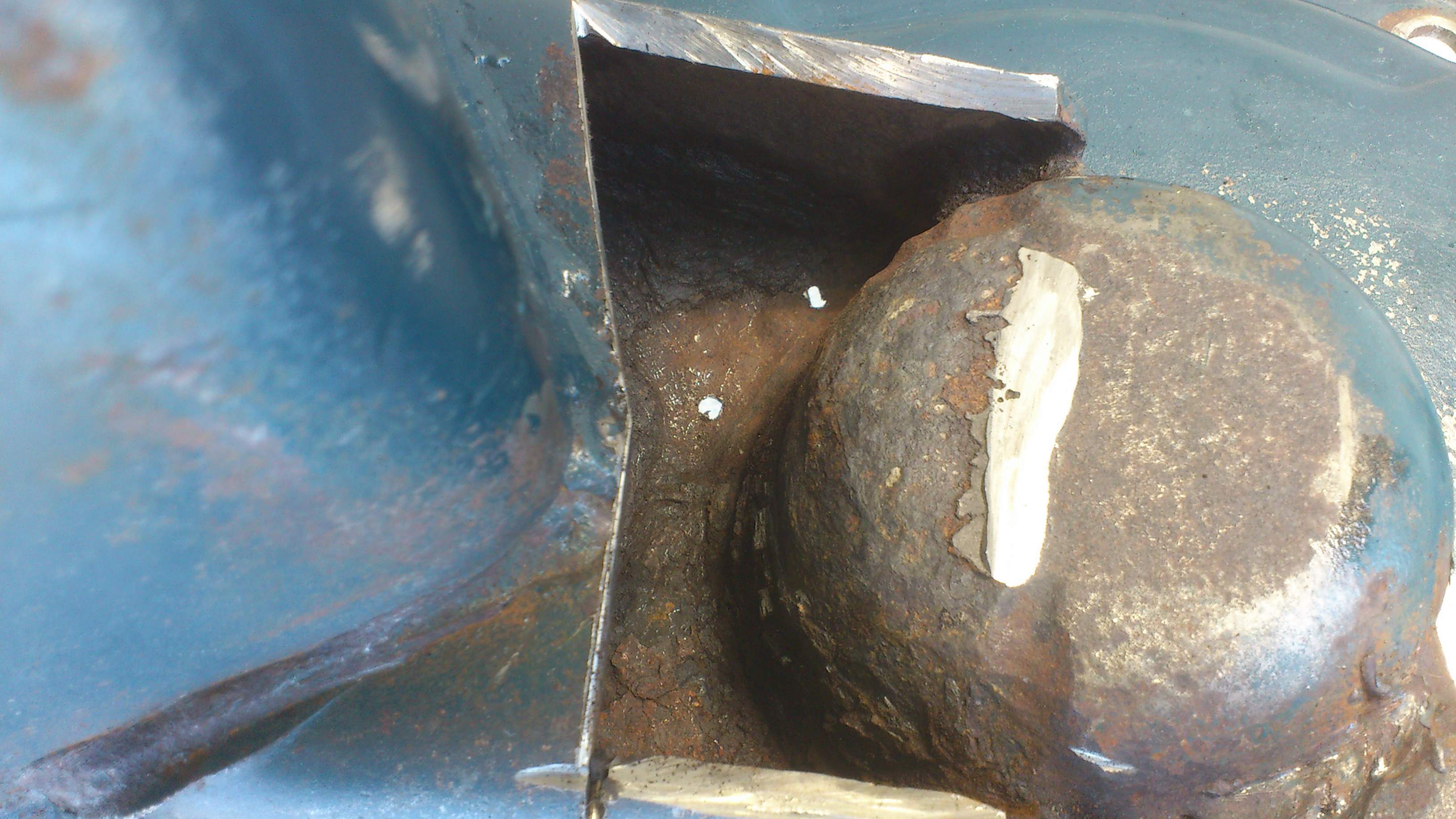

Hi
Following this post here about the leaking rear hubs on my Kubota L2402DT, I'm looking for opinions and suggestions as how to best tackle this.
3/16" plate has rusted right through, I would like to fix this "properly" and replace as much of the lost material possible (preferably not with jb weld!)
Backside, under what is left of the re-enforcing gusset (after cutting out as little as possible)

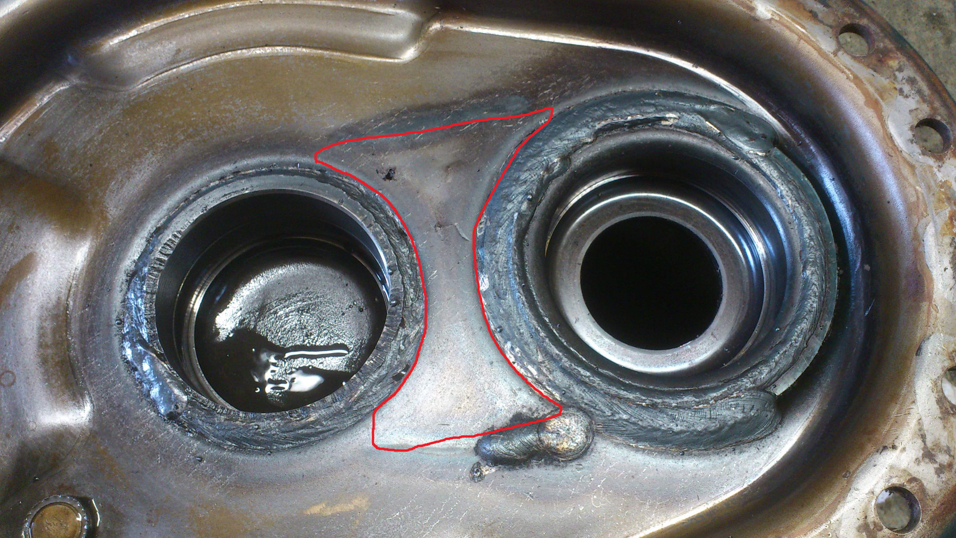

Am considering welding a plate over the area outlined in red:
Confident enough with stick welding (no exp of tig or mig) but not sure what to expect re thermal effects on nearby bearing housings? (also need to determine if there is enough material left to weld on to...)
Any better ideas? or should I just get on with it :D

Yup - just get to it. I'd suggest degreasing by washing out the hidden cavity with brake or carb cleaner, and painting it with phosphoric acid (Ospho) to stop the rust. Then cover it with new scab reinforcements. Seal-weld the scabs on - no gaps, seal it from the outside, entombing the weakened area and providing a new structural outer skin that also prevents new water from getting to it. Skip around doing the welds in small sections to control the heat and shrinkage. The formed housing is low-carbon mild steel so shrinkage and warping should be minimal. Fill in the old gaps. This style welded housing is common to several '70s L series models. Now that they are 35+/- years old, oil leaks may become more common - but I think the solution is to simply seal them up with more welded material. The damage would need to be much worse to significantly affect strength.

I would MIG weld that before I tryed stick. Much easier to get clean neat bead with no slag to chip off.
