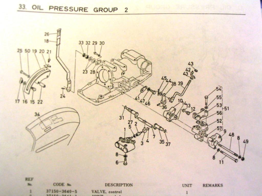

Does your hydraulic for your 3ph look like this? This is out of my book for a L245 DT and will take a pic of my tractor setup when I get home ( which is a factory loader valve setup.)
Bob

The controls on your unit are similar but not the same. The L185 has a metal discharge line coming off the pump to a "block" mounted on the front (under drivers seat) of the 3 pt housing. The "block" is a feed through with a removable cover. This cover appears to be designed so it can be replaced with a redirecting device for an additional hydraulic attachment.
I'm quite sure a machinist can make a device to replace this one or tap into the existing cover. I am hoping for a less expensive method.
Thanks for your interest. I would be interested in seeing your setup.

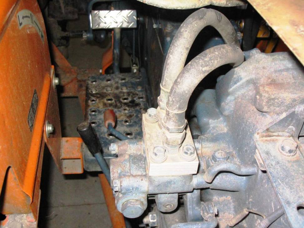

Here is mine.
Bob

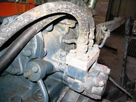

another.

Thanks Kuby I believe you have solved my problem. I will let you know as soon as I get a chance to make the cover for my valve body.
Thanks a lot!
