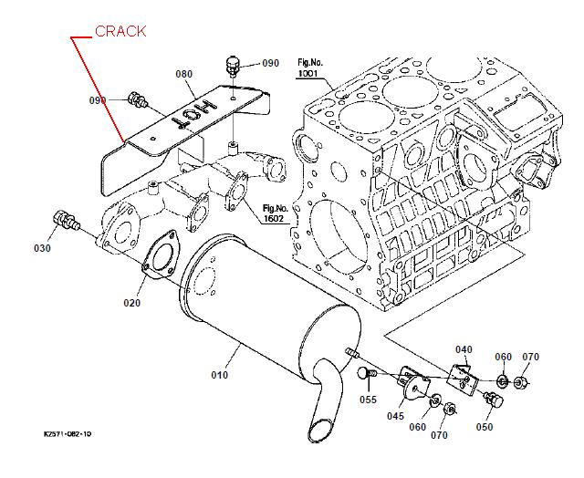

Have a BX2230 with about 300hrs. Started making a knocking sound at a certain RPM. Sounds like it's coming from injection pump. Any suggestions?

Run the tractor to the RPM where you hear the knock, open the injector lines at the injector nozzle. When you get to the cylinder where the problem is the noise will go away. Tighten the line back up, many times this will make the noise go away, if it doesn't, remove that nozzle and have it tested. If the nozzle tests okay I would then have the pump tested and then lastly check for internal engine damage.

If he has a cracked heat shield all the better as he can remove it and repair it (I just hope the bolts cooperate) be sure to use new bolts and Blue Loctite at least.

I have the same tractor, and noticed a 'knocking' or 'banging' noise, only at certain RPMs at about 500 hrs. It sounded almost like a hammer on metal. The tractor ran great though. Did some looking, and finally found the culprit. The heavy metal guard over the exhaust manifold had cracked at the front of the engine, where it bends at a 90 degree angle. At certain RPMs it goes into resonance and slaps against itself,and/or the manifold itself. One of these days I'll likely have it welded, but for now I just ignore it, and if it gets annoying, I change the engine speed!
This picture will show what I'm talking about.
