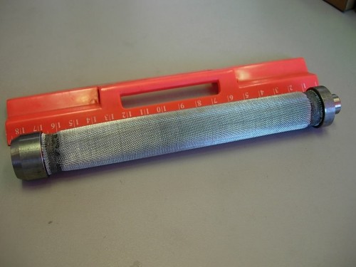

The filter listed on the parts diagram on Messicks is the screen/strainer. I'm familiar with these tractors and I know that most of them won't have an actual filter.
It looks like this:
The L235, however, does have a cartridge oil filter but doesn't seem to have a screen.
