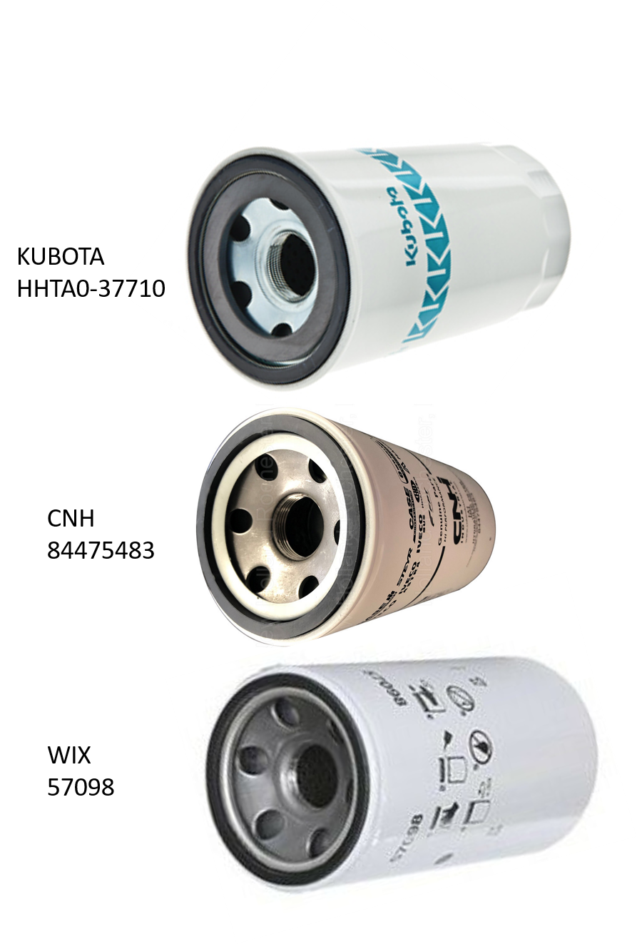

Hi. I have a New Holland T2220 HST, which uses 2 hydraulic filters. The hydraulics filter is 84475483 (was 87300043). In the past I've found WIX 57098 to be a cross-reference replacement, and less expensive, and easier to find.
I'm looking to replace the filter(s) again, and in my search for a WIX 57098 from auto parts stores, I saw some critical customer feedback mentioning how disappointed they were that the WIX 57098 was not a good replacement for the Kubota HHTA0-37710 because it didn't have the magnet. That made me start searching for more information. The WIX 57098 is listed as a cross-reference for both the CNH and Kubota filters. It looks like CNH and WIX filters don't have a magnet, but the Kubota filter does have a fairly big one, as seen here:
Kubota: Hydraulic Oil Filter, Part # HHTA-3771
New Holland Hydraulic Oil Filter Part # 84475483 - New Holland Rochester
(2nd view)
https://www.ebay.com/p/193347595
Unfortunately I have not been able to find specifications for these filters to understand if the 3 are cross-compatible. But it seems that if they are equivalent, a magnet would be a big benefit, and so I'd be inclined to use the Kubota filter. Though I am a bit concerned that the magnet could restrict flow.
Does anyone have experience or thoughts here?

The listings don't state or declare a magnet, I'm going by what Kubota owners say, and the pictures of the HHTA0-37710 showing an additional ring that looks like it would be a magnet. That ring is missing from the CNH and WIX filters. Again, I'm a bit hesitant because that may restrict flow. I'll pick one of these up on Friday to confirm, but curious if anyone already has experience here.

If that is just a magnetic ring..... Maybe you can just move it to filter of choice... Does not look like permanent attached part of filter... Kind of agree on flow issue though....

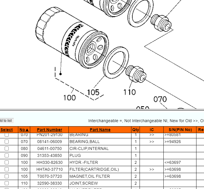

Yes magnet can be changed from old filter to new filter. BTDT several times since I've owned my Kubota M7040

Thanks. Good suggestions. And, wow, I would not have expected a magnet to have its own part number.
