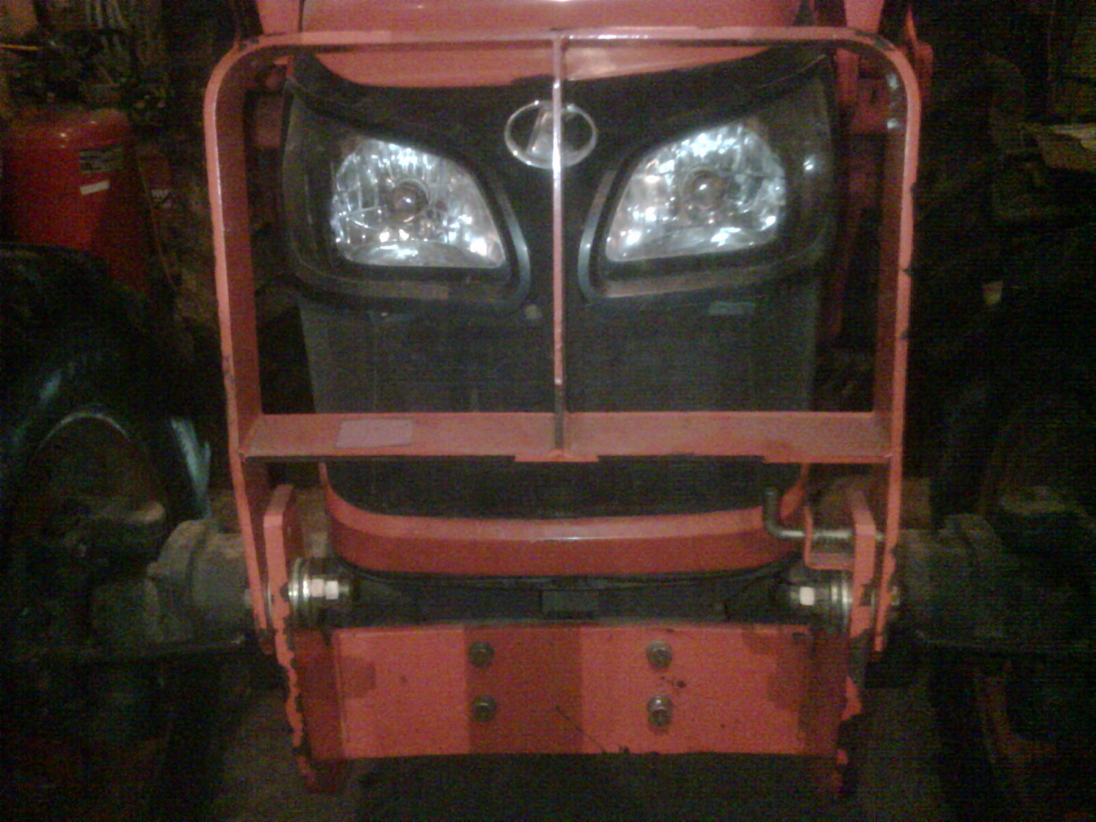

I am modifying my M9540 grill to keep limbs from damaging the front of my tractor. I am using a Lincoln sp 175 mig using CO2 for gas. Been using this machine for several years with no problems, but today when I pull the trigger I hear the gas come out for few seconds and then gas barely comes out. I can let go of trigger and the same thing happens. Any suggestions?
