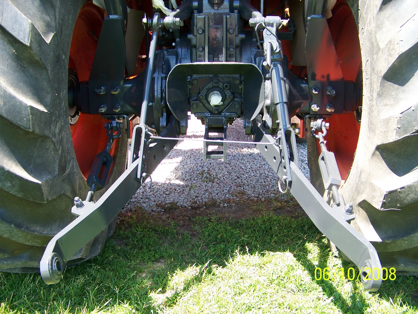

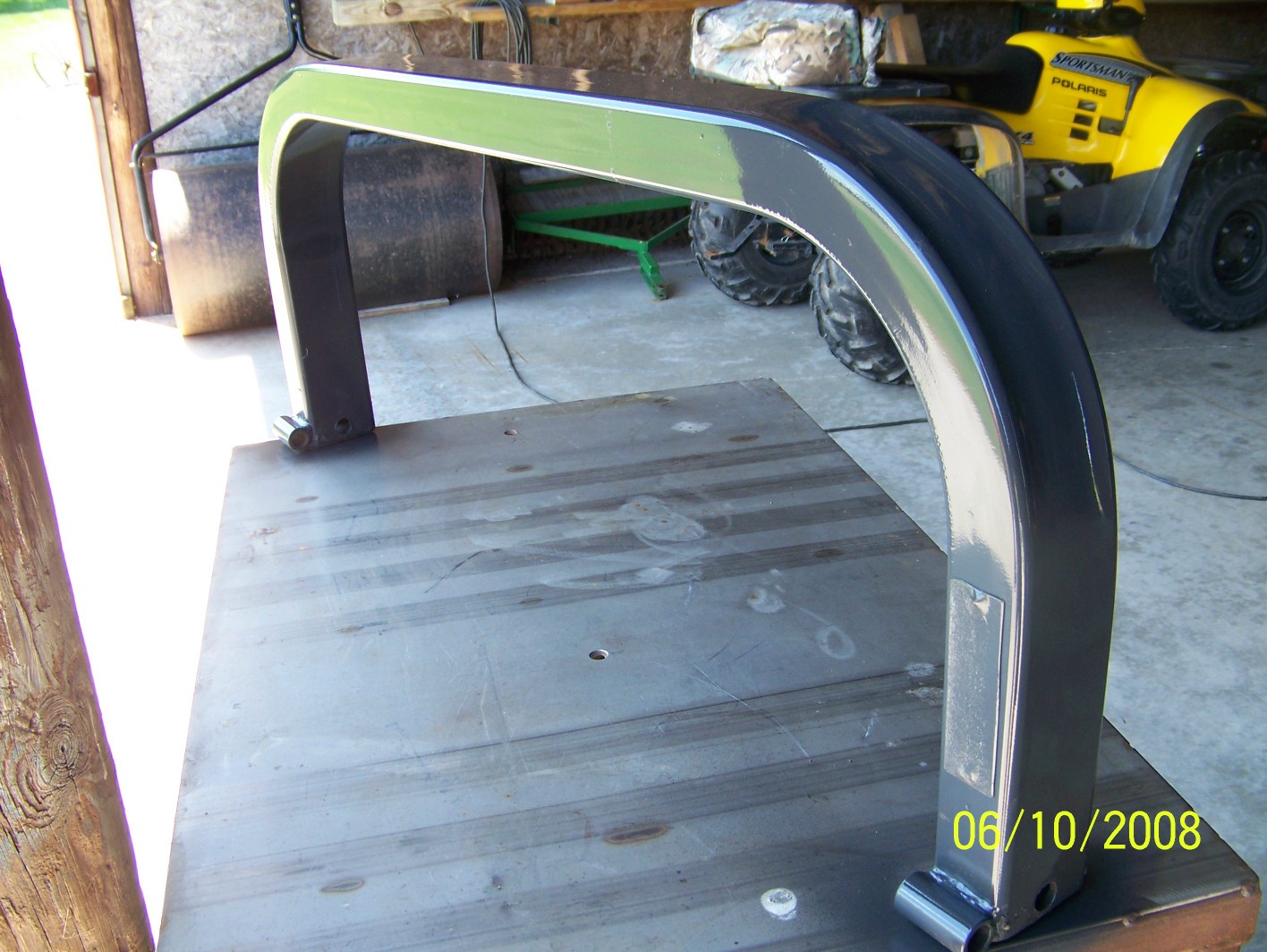

Here are some pictures I took hope they make it first time uploading had to make them smaller to except them any questions let me know thanks Eddie

Well good I am glad you seen my post, I just finished my painting today Tuesday want to let it set for a couple days then back to mowing I live in Indiana and we have been getting quite a bit of rain then sun the grass is growing I think you might be able to sit and watch it grow but I don't have the time! I thinned out my paint with mineral spirits not much just so my spray gun sprayed it nice without running practice on a scrap piece of plastic I have been using empty 2 liter bottles I used to use cardboard but paint absorbs into it, something smooth scrape metal works to have fun you will love the color match Eddie
