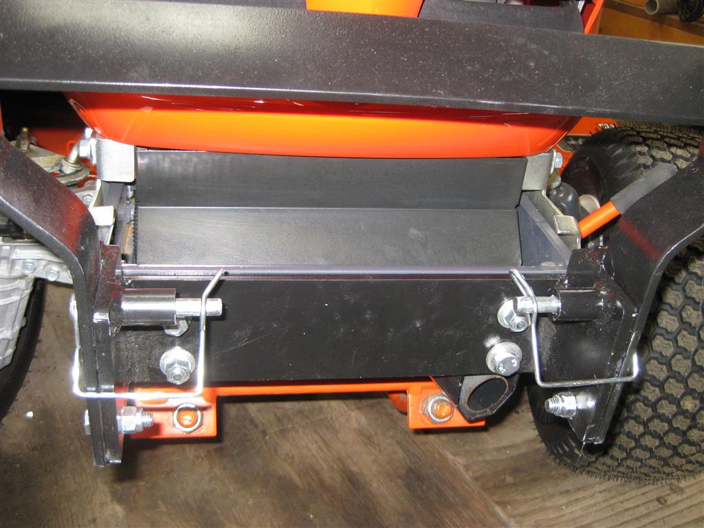

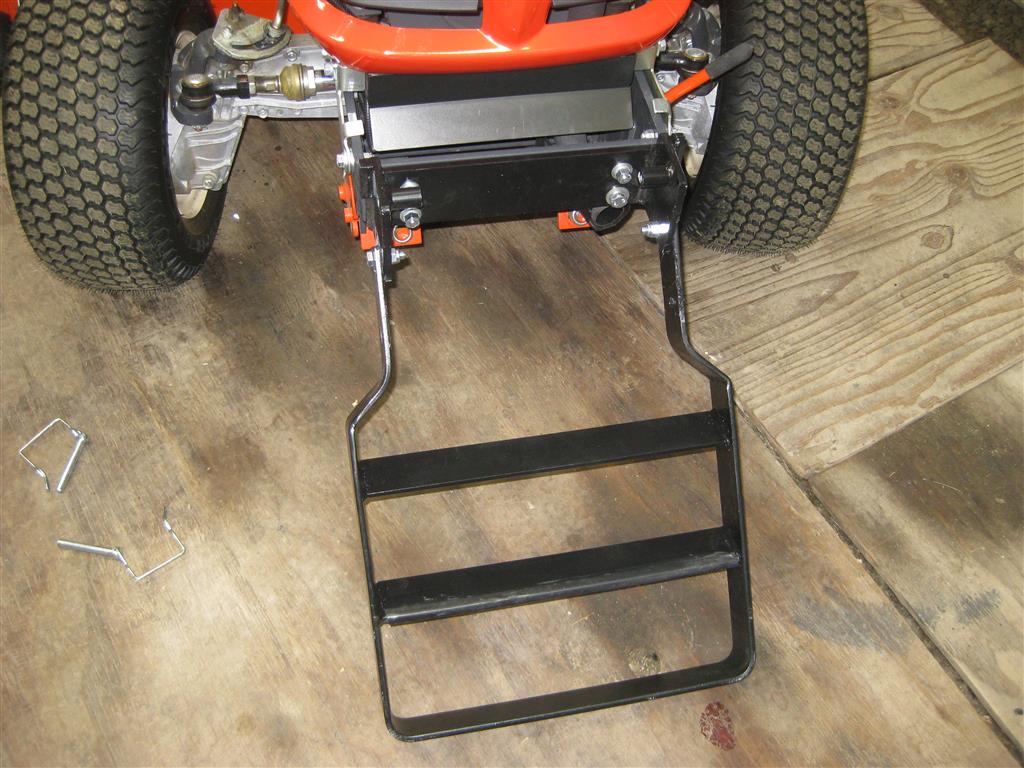

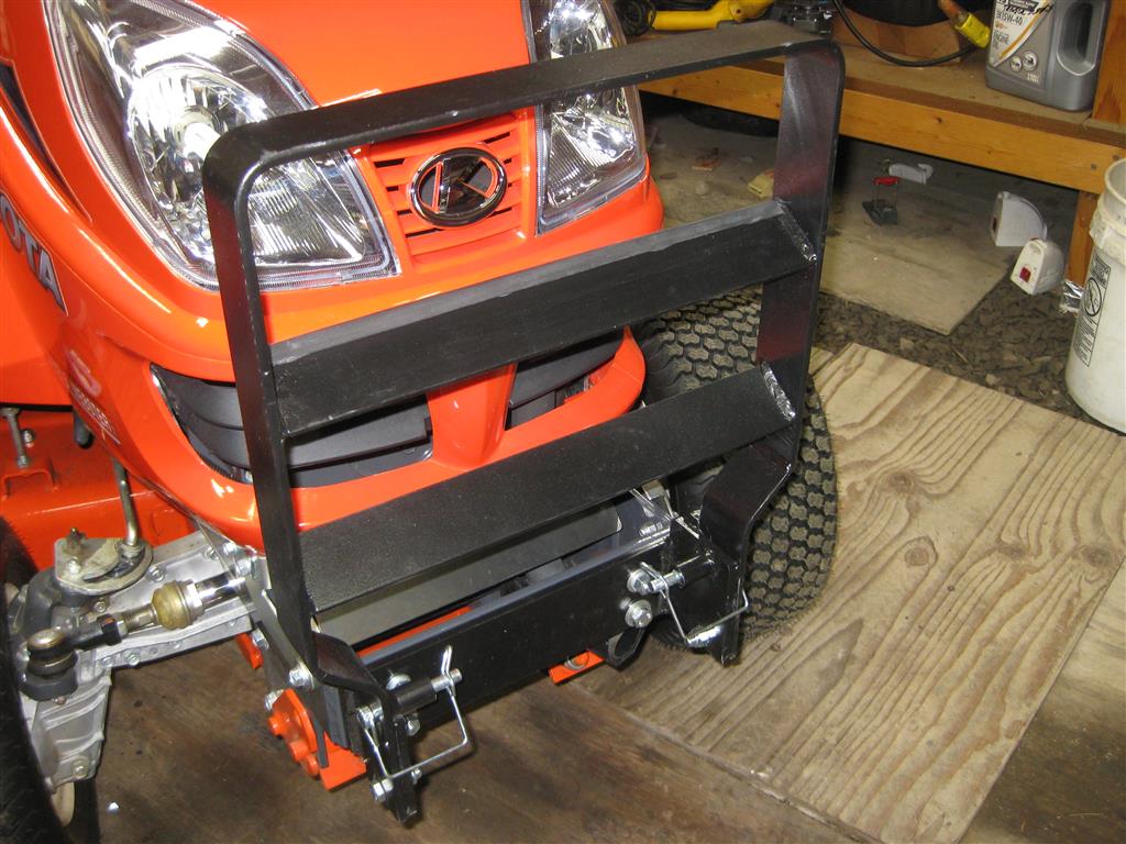

I was looking for some time if there was a company who made a brush Guard for my GR2120 and did not find but only One and that was
Steve From
Heritage Machine Works Inc
3268-320th St.
Wellman,Iowa 52356
319-646-5169

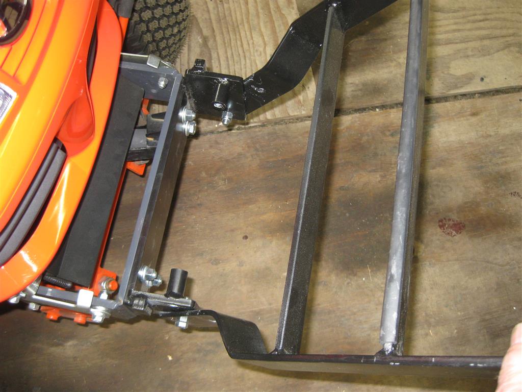

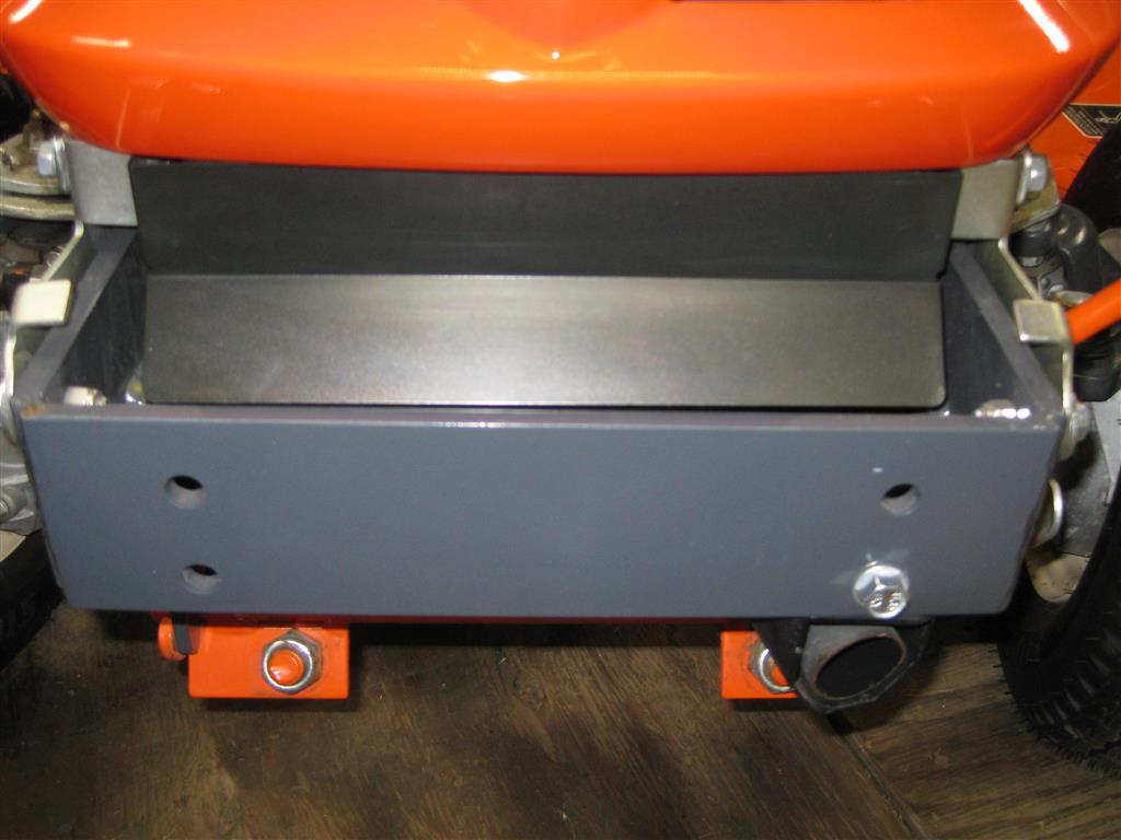

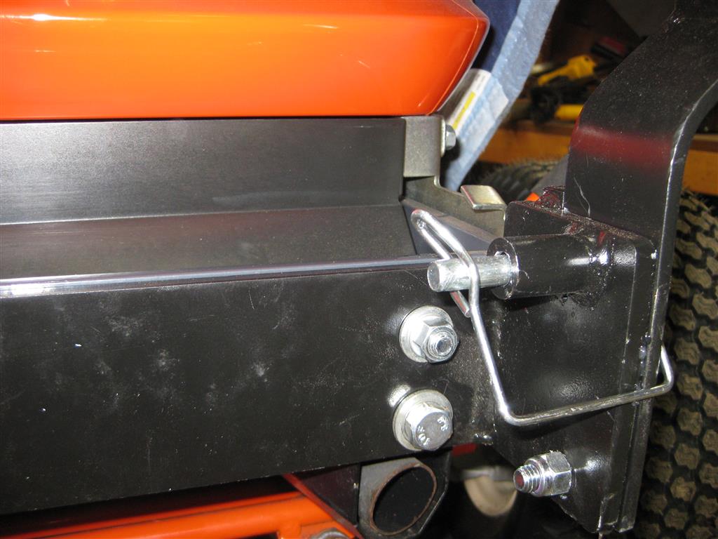

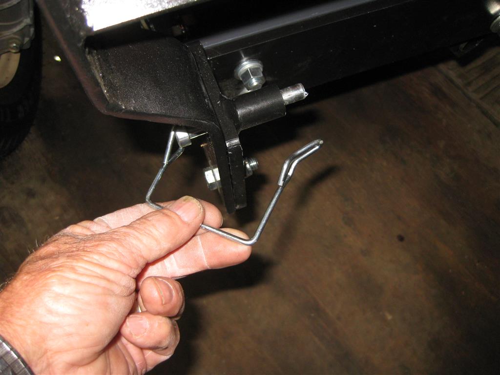

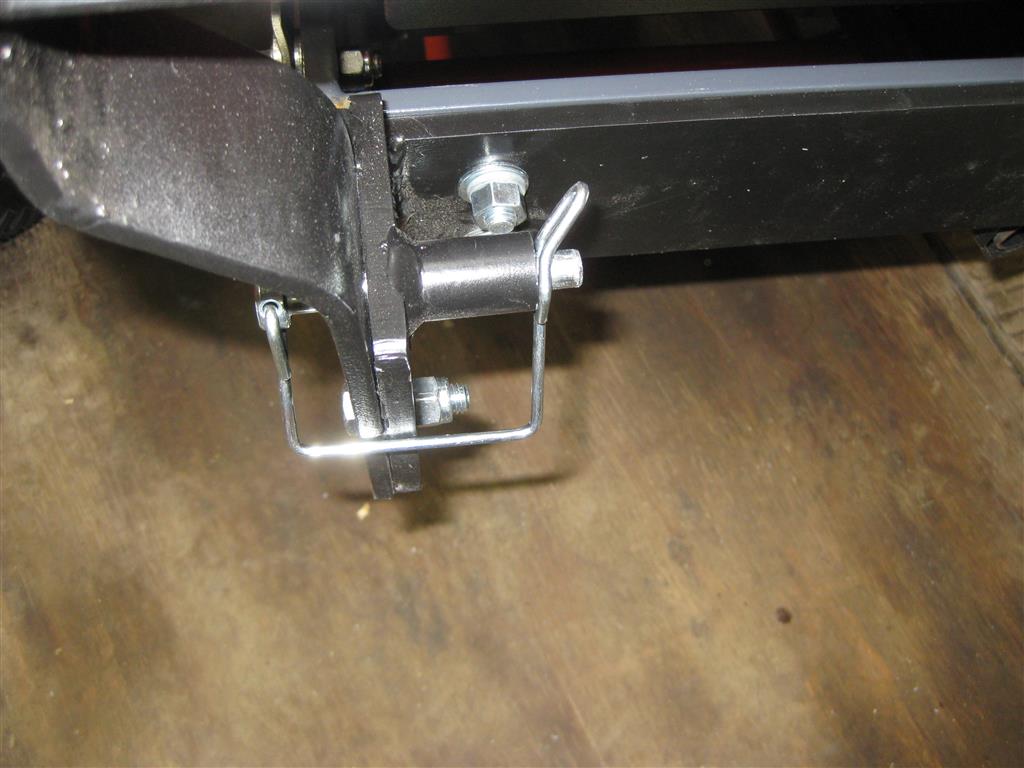

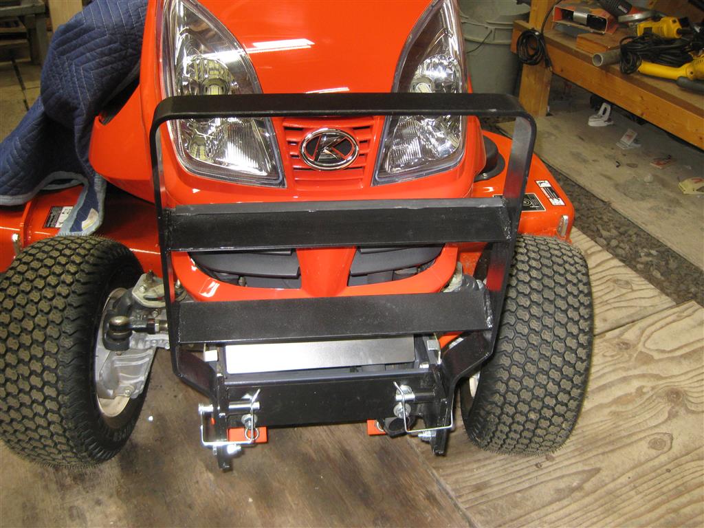

The unit bolts up to the front bottom frame plate and tilts down by just removing two linch pins in seconds.
You can mount it in 1/2 hour or less and it will tilt down to the ground for opening the hood .
Its made of heavy gauge steel and painted black.There is a original front right lower bolt which supports the
muffler. Just replace this bolt with the same thread size with about a 1/2 inch longer bolt.
The assembly comes with 4 mounting plate bolts just use a longer one for the original muffler supporting bolt which has a different thread size (metric)
The total cost with shipping was $250.00 and took about 2 weeks to make and ship.
Its a very nice guard. if your original hood gets damaged it as very costly part so the guard is a cheap way of protecting it.
Here are some pictures of mine mounted. IMG_6868 (Medium).JPGIMG_6867 (Medium).JPGIMG_6869 (Medium).JPGIMG_6870 (Medium).JPGIMG_6871 (Medium).JPGIMG_6872 (Medium).JPGIMG_6873 (Medium).JPGIMG_6874 (Medium).JPGIMG_6875 (Medium).JPG

Looks like that would not be compatible with snow blower mount. Philip.
