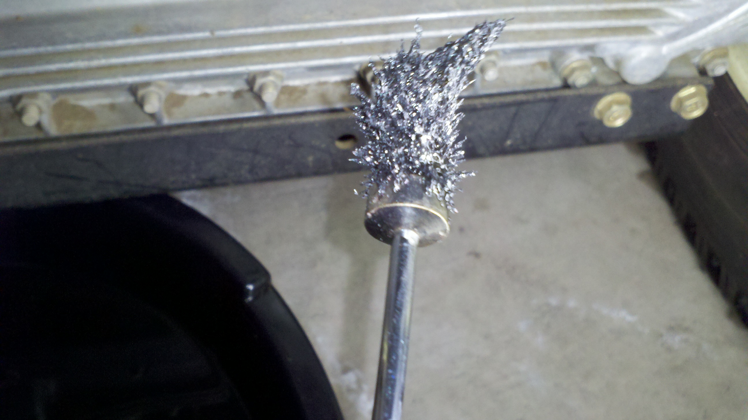

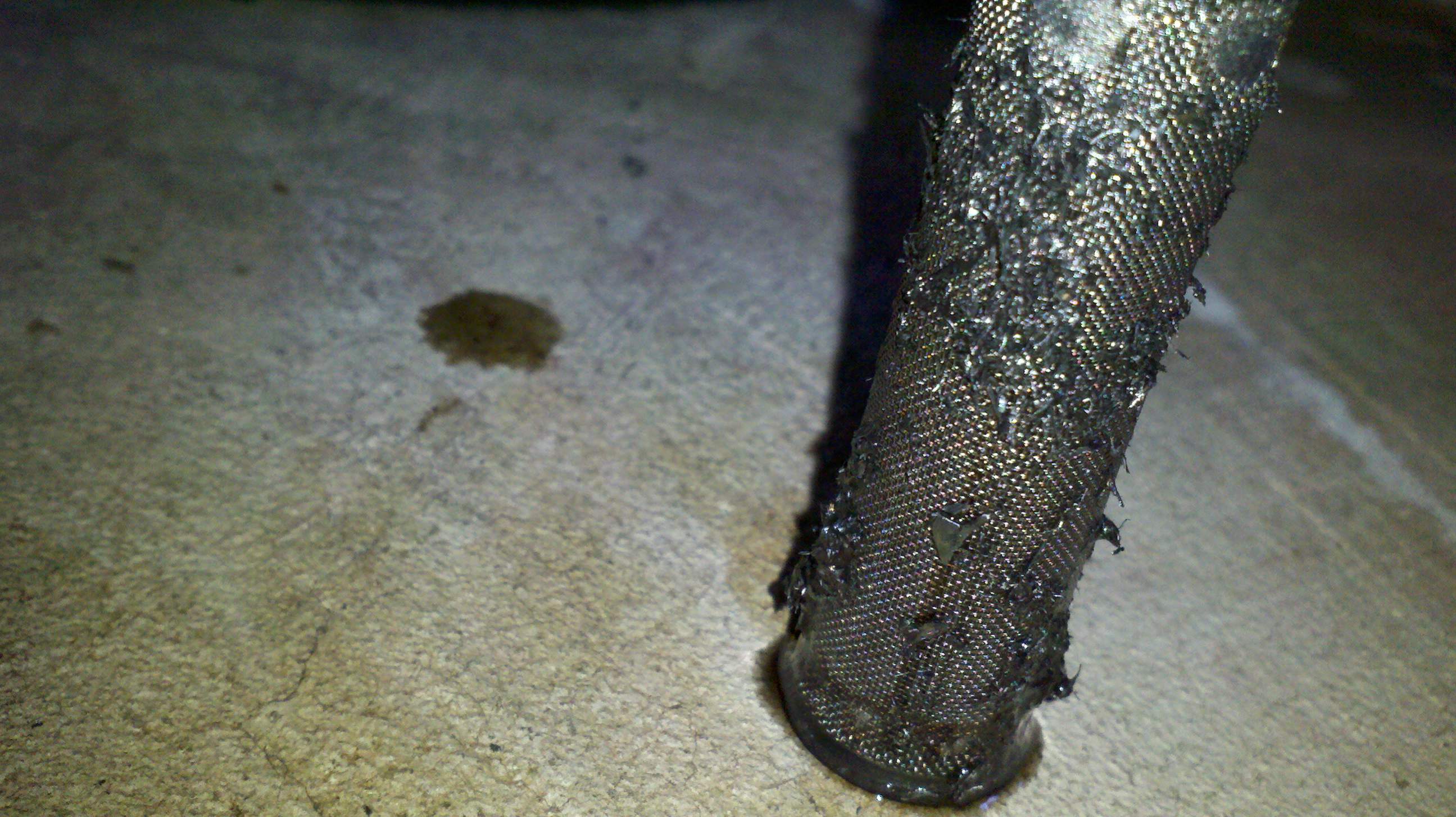

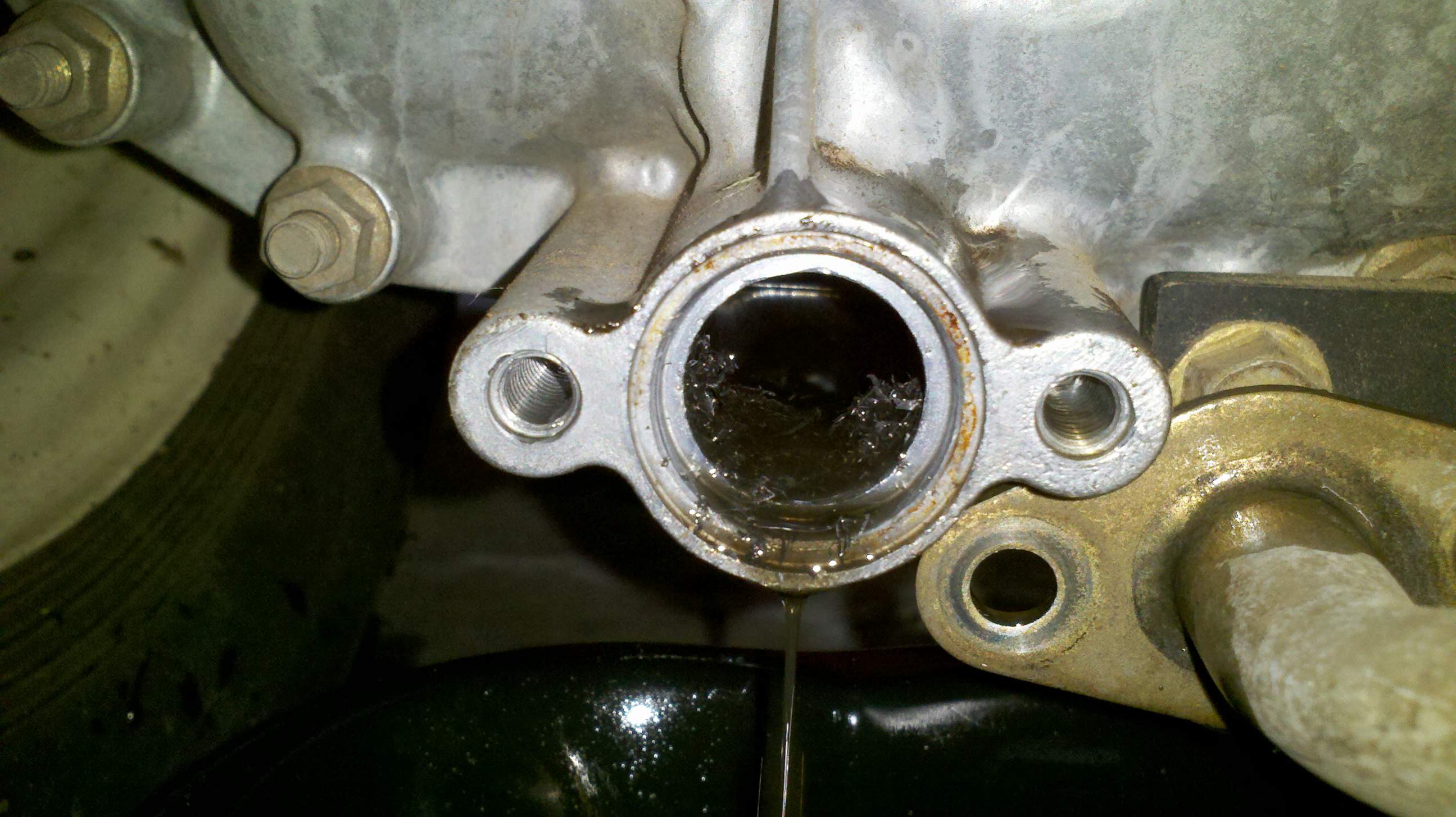

I serviced my GR2000 on Saturday at 313 hours, When I took the hydraulic line off and removed the screen I used a 1/2 inch magnet and put it into the hole and got close to a teaspoon of metal shavings that were stopped by the screen.
My question is how many is to many?
There were some at 200 hours but i figured that is why they put the screen in. To catch the metal.
I really need someone that has done this themselves to give me their opinion on the amount stopped by the screen filter and collected on the magnet.
Locknut have you changed this before?
1/2" magnet
inlet hole
screen

Never pulled the screen assy myself.I had the dealer change the hydro fluid initially,and then sometime after that they rebuilt the whole thing.I was down there the other day and the Tech looked up the serial # break on early GR's for the old vs new changeover design.Wrote it down,now can't find it.He also told me some of the things that were involved in the changeover/or rebuild upgrade with sold units under warranty.The problem was using bushings on the rear axle that developed leaks.The fix was a bearing/seal setup but that required a whole new case.Also,with the leaks,the fluid level would drop up top whereby the PTO would be damaged with the oil starvation.He also mentioned a new charge pump with the upgrade.
Anyway,the shavings in those pics doesn't look good to me.Others in the past have found this to be the remnants of some thrust washers, IIRC.

You have an early one for sure.If you bought it used some work may have been done previously.
The serial # break on the case/axle bearing is 12588.
There is an additional break on the PTO upgrade-11590. Yours is below that,so the shavings are likely the thrust washers on the PTO drive assembly.
Either way,it looks like you may need the whole upgrade done if the tractor hasn't been touched.
