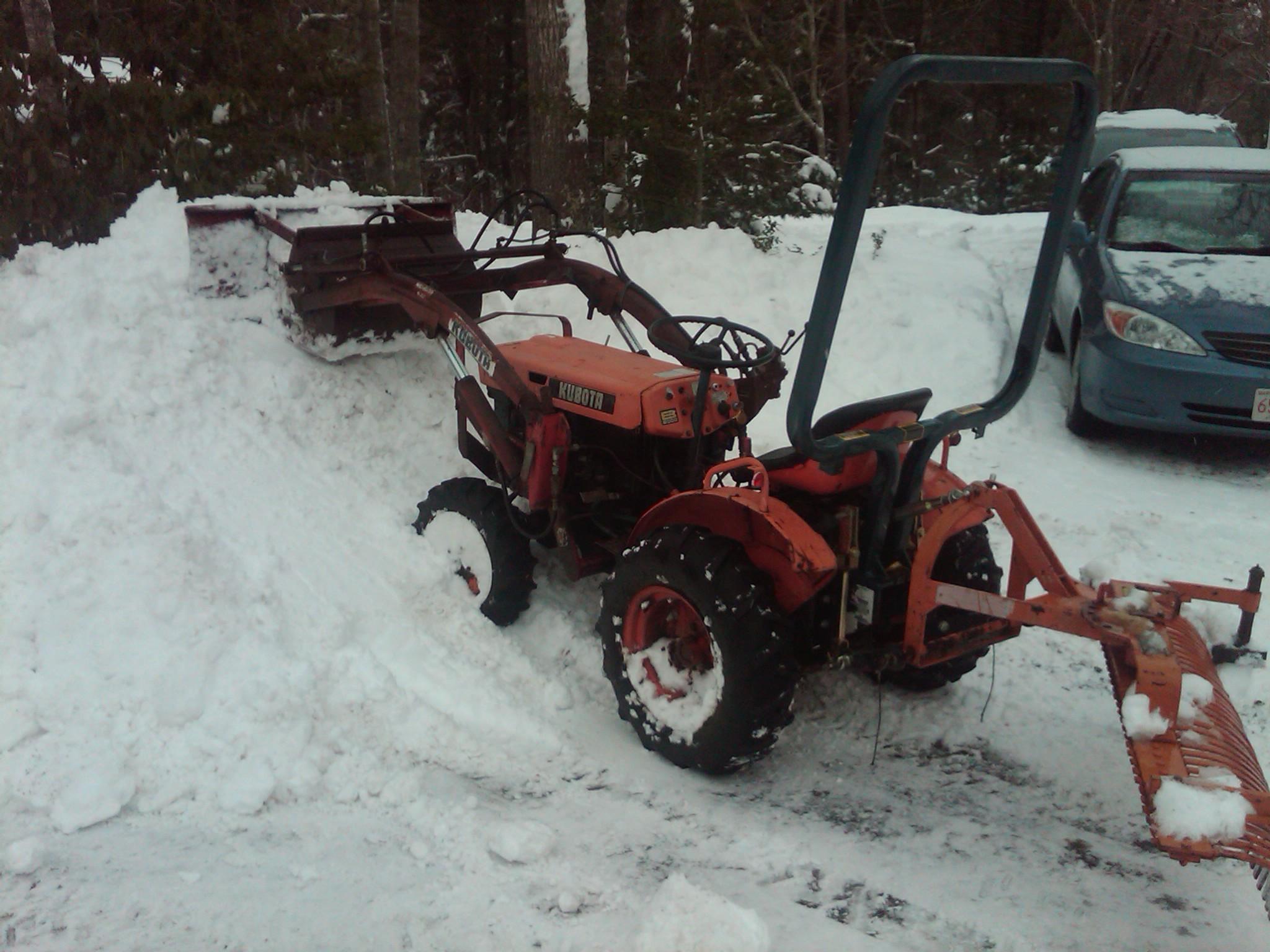

Here's what a B6000 can do. Note, my blade is a reworked rear scraper blade, and it does NOT have the springs either.
My blade has a 1/4" piece of angle iron welded to the back side, to stiffen it up, and a piece of flatbar on the upper edge. The actual blade is only about 3/32" steel. Maybe even less than that.
