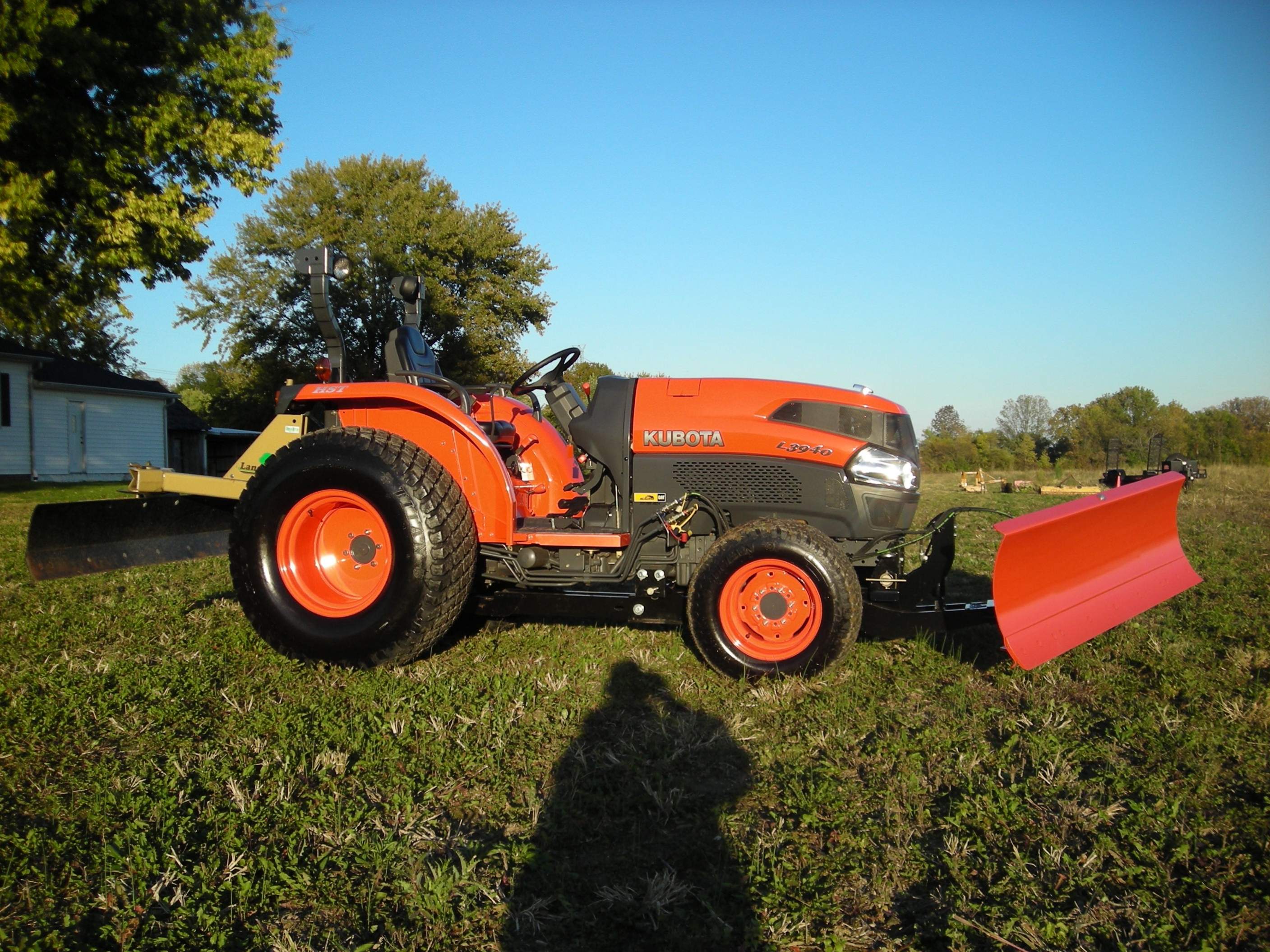

Never used it on dirt. Used it on mulch once. Awesome in snow! On my tractor, there is a full length frame under the tractor. Mounts with drawbar, two pins mid, and two pins front, with brackets that bolt on and stay on tractor. You can remove blade by itself and leave sub-frame on. Takes about 10 minutes to mount or dismount subframe. Not sure if you can have subframe and loader on at same time. I will test later this fall. Philip.

Thanks for the pics. I believe the B-series subframe is a little different, but I can confirm this until I hear from someone with a B-series blade.

I have the exact set-up you are looking at - B3200 with quick connect and 72 inch Kubota blade.
For the b3200 it is a midmount subframe which stays on all the time. The quick connect framework is very easy to put on. Once the quick connect is on the plow attaches extremely easily. If everything was right there you could probably attach the whole thing in a few miinutes and definitely less than 10.
Haven't used it for loose dirt yet but it sounds like your expectations of the plow are appropriate - The blade is very heavy but the "lock-out" for pushing dirt (so the springs don't actuate) looks a little weak - I wouldn't expect it to do a lot of digging (which you aren't).

Oh - The loader sub-frame stays on - I think you would have to remove the quick-hitch to put the actual loader on.
