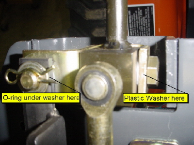

Jun 28, 2004 / Kubota FEL Joystick Rattle #1 nitroxn Bronze Member Joined Jun 20, 2004 Messages 77 Location Maryville, Tennessee Tractor Kubota B7510DT Don't need to go into much detail about this. Simply put o-rings and plastic washers in place to minimize space between the loose factory tolerance. Attachments 452122-Kubota Mods TBN1.jpg 58.1 KB · Views: 671

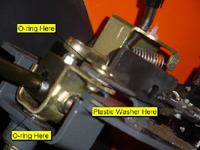

Jun 28, 2004 / Kubota FEL Joystick Rattle Thread Starter #2 OP nitroxn Bronze Member Joined Jun 20, 2004 Messages 77 Location Maryville, Tennessee Tractor Kubota B7510DT Second Picture Attachments 452123-Kubota Mods TBN2.jpg 64.2 KB · Views: 539
Jun 29, 2004 / Kubota FEL Joystick Rattle #3 D Dave___in___CT Gold Member Joined Oct 7, 2003 Messages 481 Location West-Central CT Tractor Kubota L3130, LA723 Loader, BH90 Backhoe, Curtis Cab, || '82 Gravely 8199KT garden tractor Have the rattle on my L3130's joystick... Thanks for a solution... Dave...
Jun 29, 2004 / Kubota FEL Joystick Rattle Thread Starter #4 OP nitroxn Bronze Member Joined Jun 20, 2004 Messages 77 Location Maryville, Tennessee Tractor Kubota B7510DT Let me know how it worked for you.
