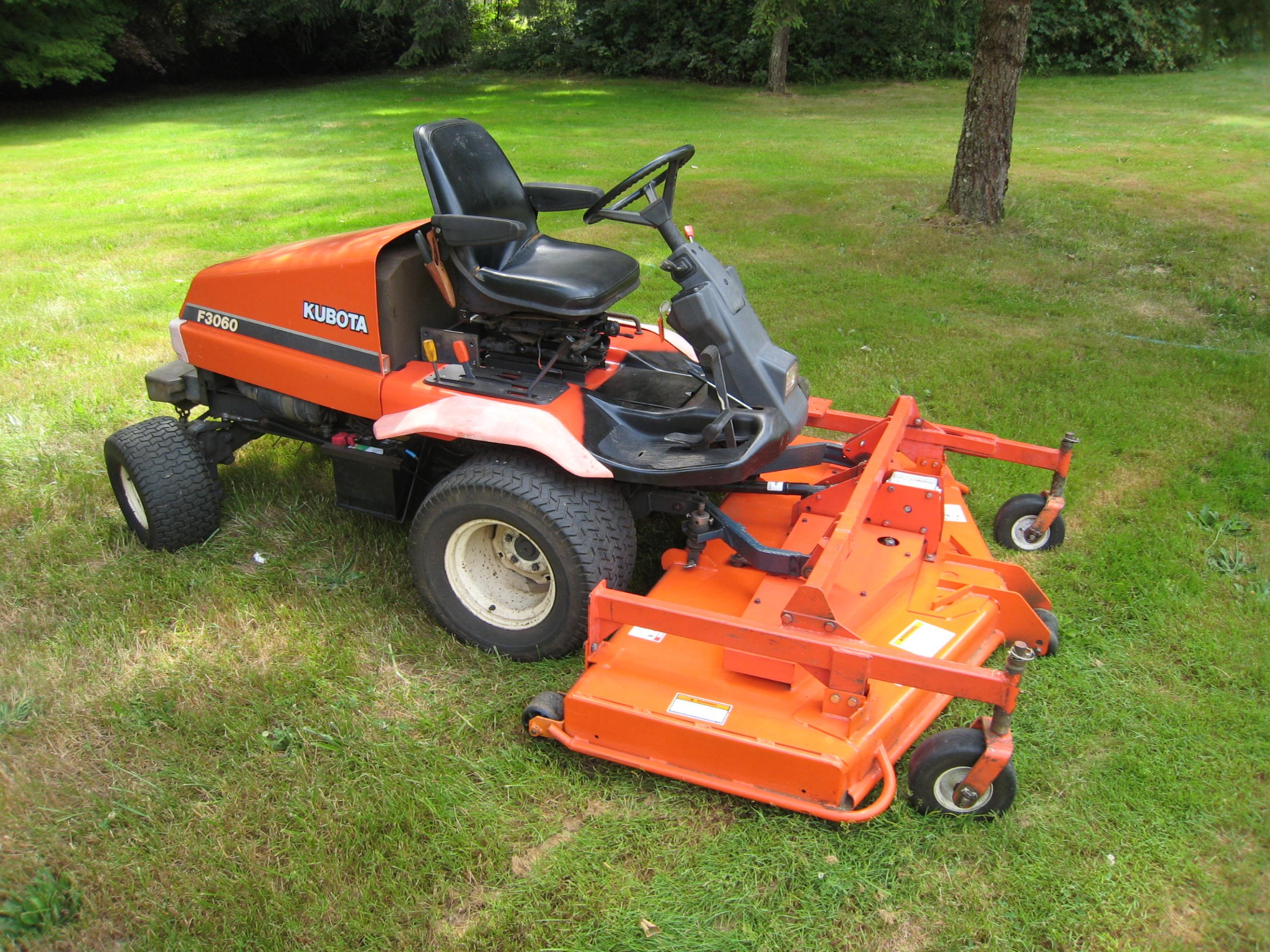

I was recently looking for replacement PTO shaft (Part No. 70050-94620) for in-between my F3060 mower and RC72R-F30 rear discharge deck, but was told by dealer it is no longer available from Kubota!
The dealer was unable / unwilling to offer any help at all for alternatives. The PTO driveshaft 70050-94620 was listed as a $600 part when it was last available.
This was totally unexpected bad news and prompted me to urgently start looking for alternatives!
After 3600 hours of use, the drive shaft spring lock yoke splines were worn, the extension spline was worn and the bevel gearbox end yoke fit to the gearbox was worn loose.
U-Joints were the only parts without any noticeable wear.
The design of RC72R-F30 (Rear Discharge) deck uses shear-bolt only at the bevel gearbox end and has no key-way in the shaft making it slightly loose fit over time, which probably caused the extension spline in-between the yokes to wear excessively.

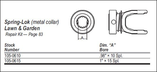

After some online searching I found out that the old IH Farmall Cub tractor uses the same .098"-10 spline in the PTO output shaft end where the PTO shaft yoke is connected to, and Weasler Spring-Lok yoke No. 105-0610 has a perfect fit and will also fit the U-Joints Kubota uses (which are the same as MOOG 861)
Kubota F3060 mower gearbox output shaft end will connect with Weasler part No. 105-0610:

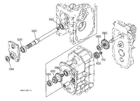

Item No. 020 is the internal gearbox PTO output shaft with .98"-10 output end spline:

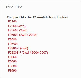

All of these 12 Kubota F models use the same PTO gearbox output shaft, item 020 ( Part # K3511-14310) and have the same .98"-10 spline:

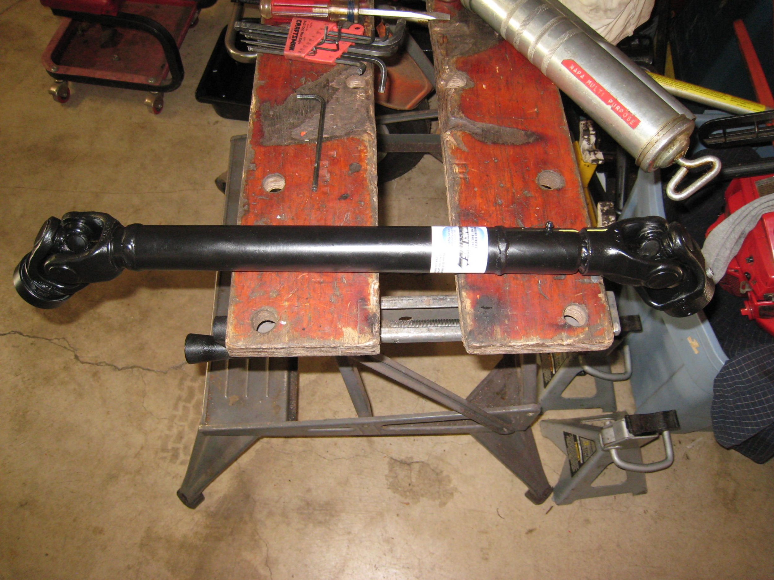

With that information I went to a local drive shaft specialty shop where the first thing I was told was Kubota uses proprietary parts and may be tough to find aftermarket replacements, but mentioning Weasler 105-0610 Spring_Lok yoke caught their attention.
Long story short, they made me a new PTO shaft out of parts found in Weasler North American Drivelines & Components catalog and the cost of new shaft was way lower than expected.
The new shaft fits perfectly and does not have any noticeable vibration - so far I have used it for about 4 hours.
It's good to have a local shop and alternative supplier, especially when the OEM stops support!

   / Kubota F3060 PTO Shaft - OEM Replacement No Longer Available! #4
It just helped me. Did you replace the output shaft from the Kubota?
No not yet since it's not bad at all with the new .98"x10 Spl. yoke.
IE. The original yoke spline had more wear than the output shaft spline.
However there is some wear in the output shaft spline and I will replace it eventually.

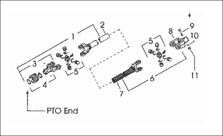

Mine had the most play in the "slip sleeve" to 15-spline shaft, see below.
I'm thinking I can just get the cross bearings and each end yoke.
Also, what size shear bolt are you using? The hole looks threaded on one side but I'm just dropping a long bolt through and putting a nut on.
The bearings or U-joints had no wear or play at all, they were the only PTO shaft parts in like new condition! Both yokes had noticeable wear.
I eliminated the shear bolt design (item 9 below) and instead now have keyed gearbox end yoke, item 8 below and keyed gearbox input shaft.
The OEM shear bold design yoke had worn loose on the Superior bevel gearbox shaft, and since it had became loose it caused excess wear in "slip sleeve" and 15-spline shaft, items 2 & 7 below.
This excessive wear caused vibration in the PTO shaft, which rotates at 2500 rpm.

Something else I noticed. The parts diagram shows that the implement end is tube side and the tractor end is the shaft. Mine is the opposite. Not sure if that matters.
Sounds like someone turned it around?
