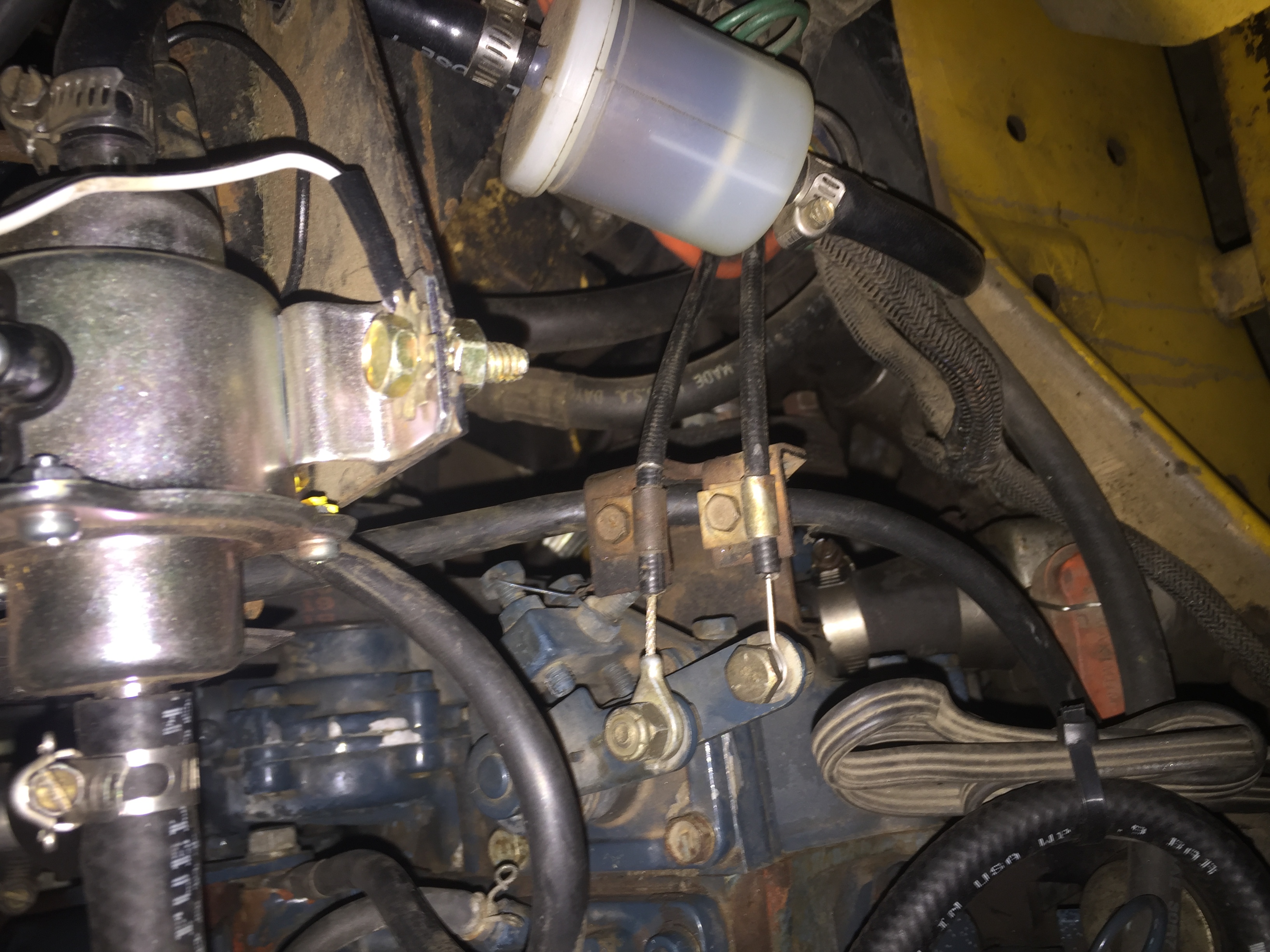

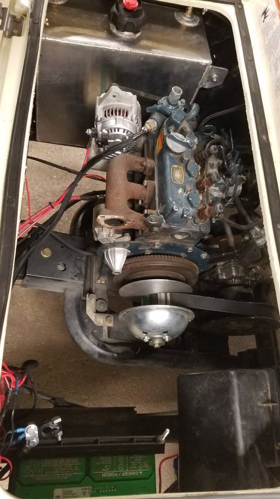

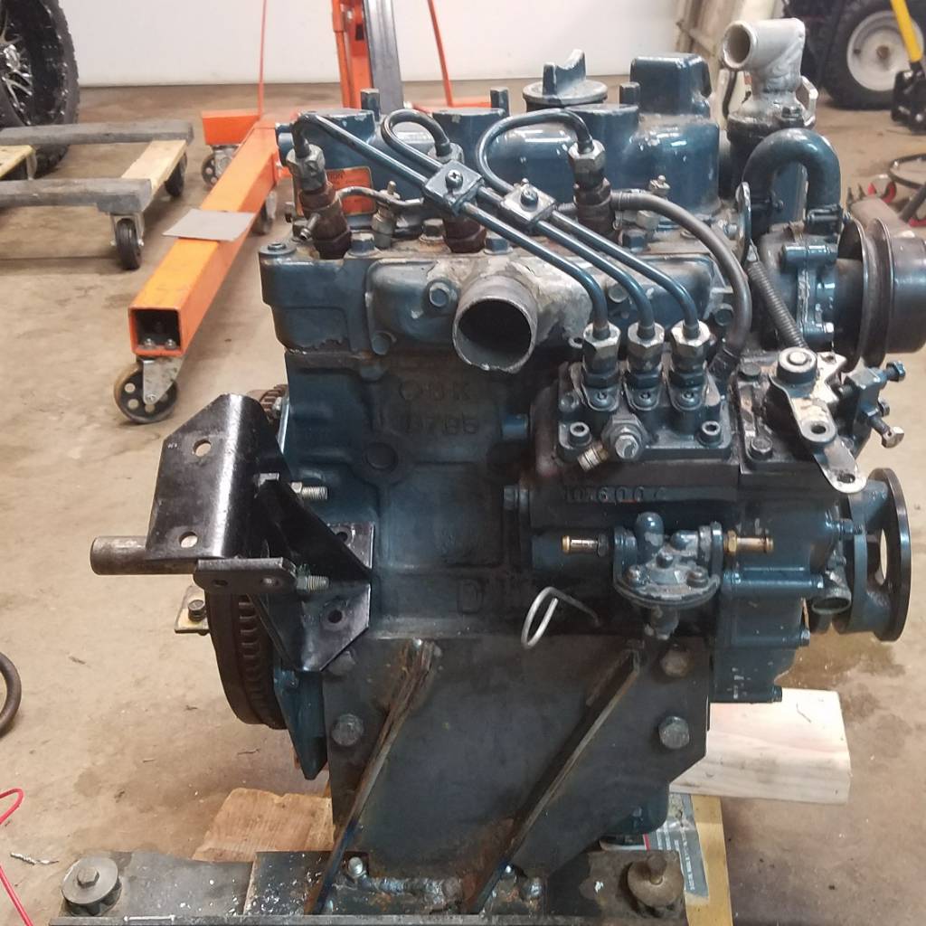

Hey guy,
While back i posted about my kubota swap into my yamaha golf cart. I'm getting close to completion. I'm down to the little details now. Motor is getting painted and I'm trying to figure out best way to mount the throttle cable. Anyone know how it was mounted in a grasshopper 718D?
Also I am looking for suggestions on a intake for my cart.
Thanks! 20170221_174311.jpg20180111_122349.jpgIMG_20180111_215016_236.jpg20180105_124742.jpg
   / Kubota d600 throttle bracket and air intake intake #2

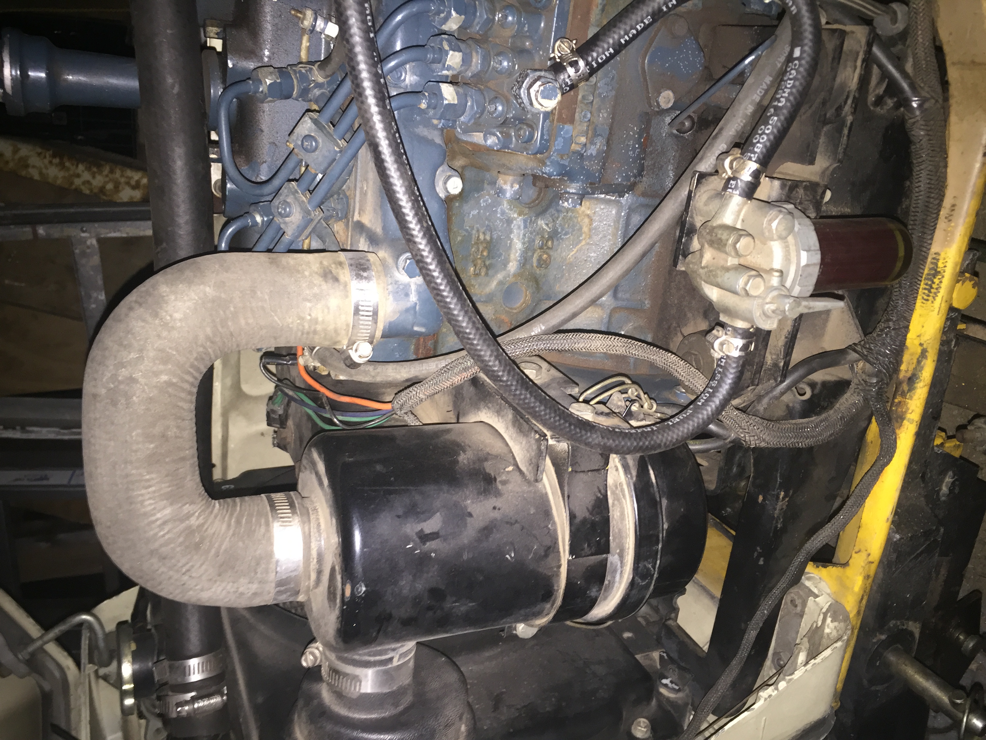

I have that same engine in my cub cadet 782d tractor. The engine is mounted backwards. Driveshaft connects to front on engine. Front PTO runs off the flywheel side.
Happy to get you picture if it will help?
If you dont mind thatd be great! Any hints and ideas would help out lol
Thanks! That helps out a lot! I have an idea how to do the cable!
