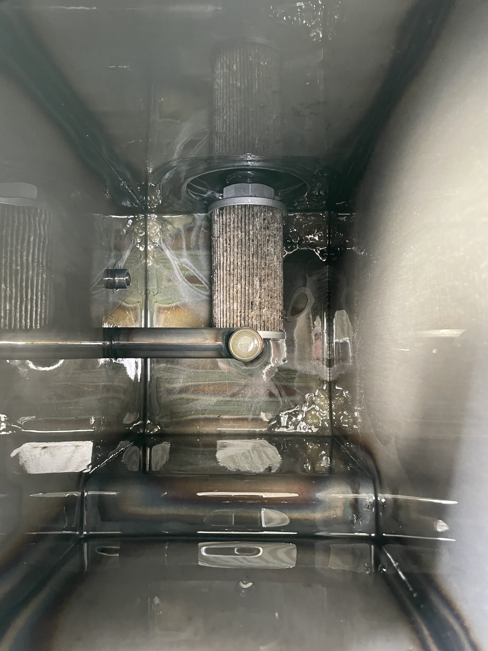

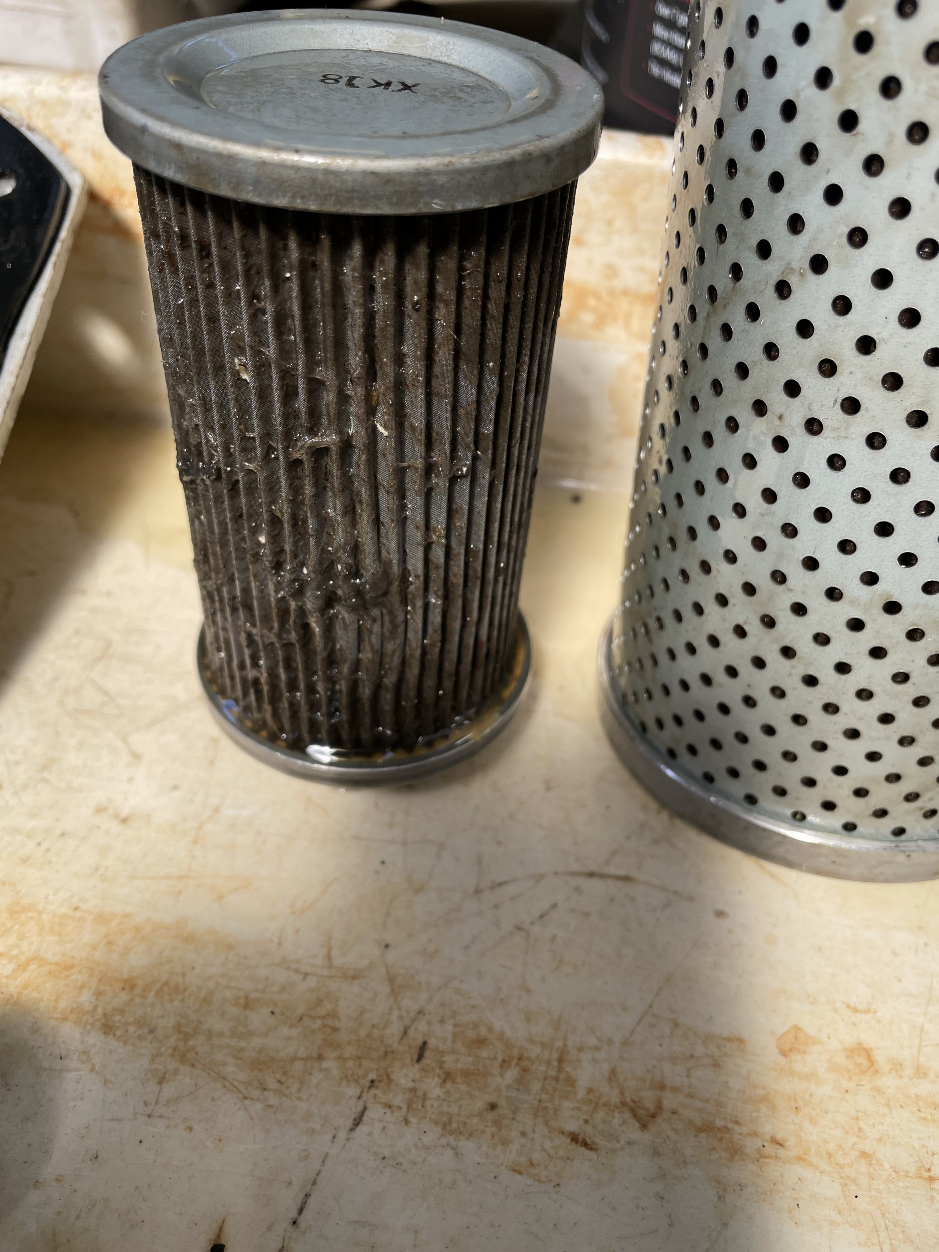

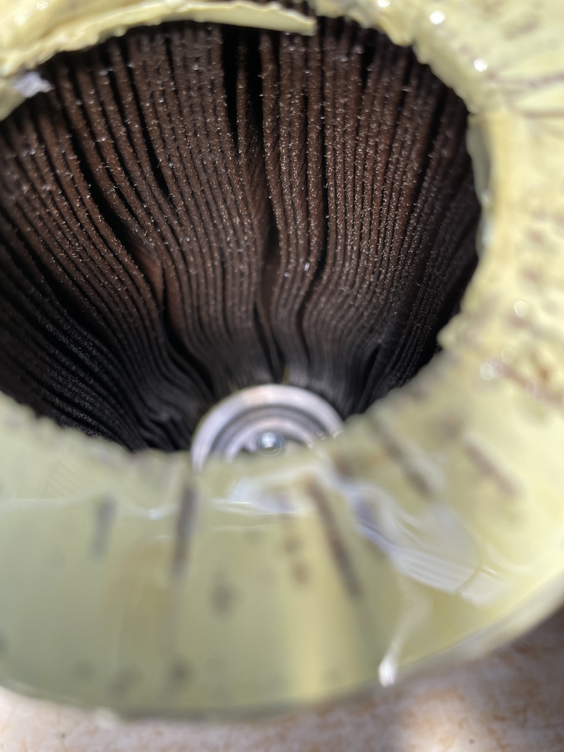

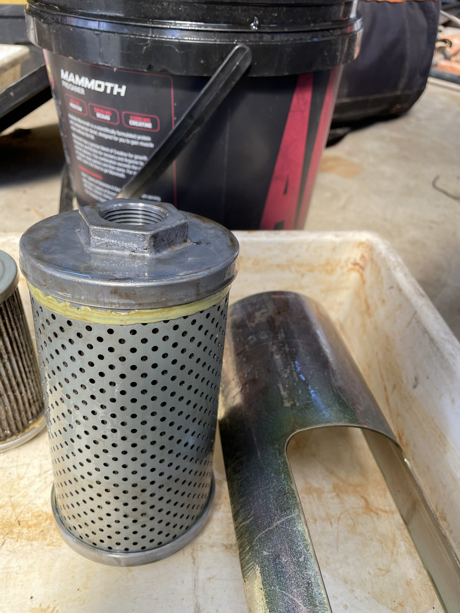

Best way to flush is fill and drain a couple of times with hydraulic fluid. Might be a little pricey but is still the best way. As TractorTech mentioned if you can drain the cylinders this will help and may only require a one fill and drain.
Hope this helps!!

I’ve always considered the D1105 to be a tad slower throttle wise. It’s one of the first things I noticed on my zero turn. Have you heard this machine in good working condition? (Can’t tell what it is.)
It’ll be interesting to see if the fluid and filter change helped. I would think the system’s hydraulic bypass should have prevented any lugging though. Much like picking up too heavy of a load with a FEL and it not moving despite an open loader valve, it should have just bypassed.
