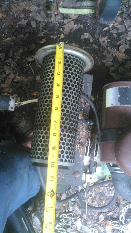

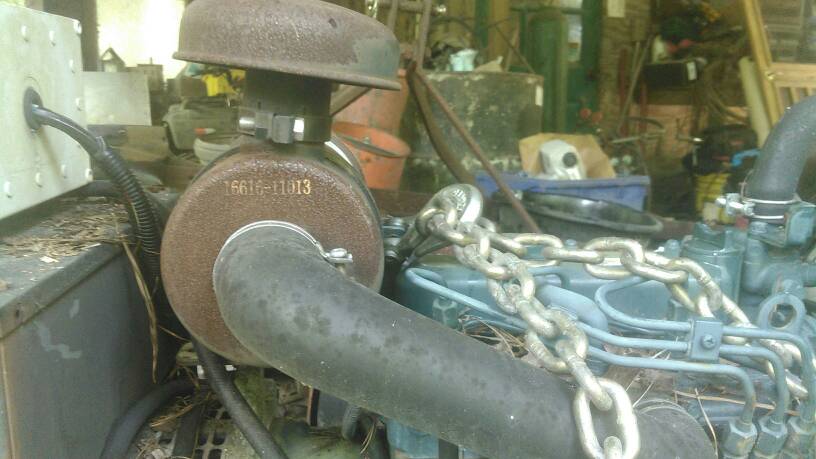

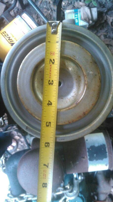

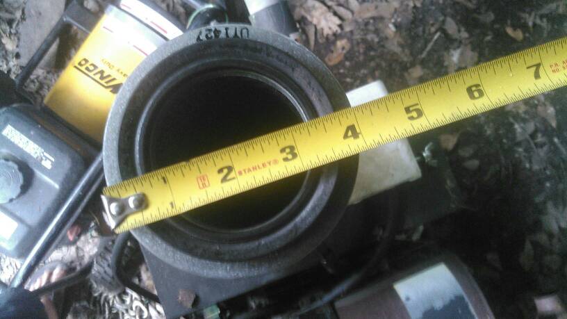

I have a Kubota D1005 on a mecc alte generator. I've acquired it used at a very decent price. I am in need of an air filter number. All of the decals with part numbers are faded off the top of the housing, although, the housing part number is still there. It is 16616-11013. Any help on this would be much appreciated. 1535906790828.jpeg1535906859910.jpeg1535907235348.jpeg1535907317837.jpeg1535907451333.jpeg
   / Kubota D1005 Generator Engine #2
Does that big cap come off the one end? If so, it looks like Baldwin makes that filter and they call it a PA4766: http://catalog.baldwinfilter.com/partspecification.asp?partnumber=PA4766
If not, take it into your local small engine shop which handles Zero Turns and they can probably cross reference it. Most Zero Turns use a very similar air filter.
Aaron Z
   / Kubota D1005 Generator Engine #4
16616-11013 is a good number for the housing. Try putting that in donaldsons website.
I asked my local Kubota dealer and gave them the model and the housing part number. They found the Kubota filter number for me and it is 15741-11083. I just bought it from them because they made an extra effort to help me out.
