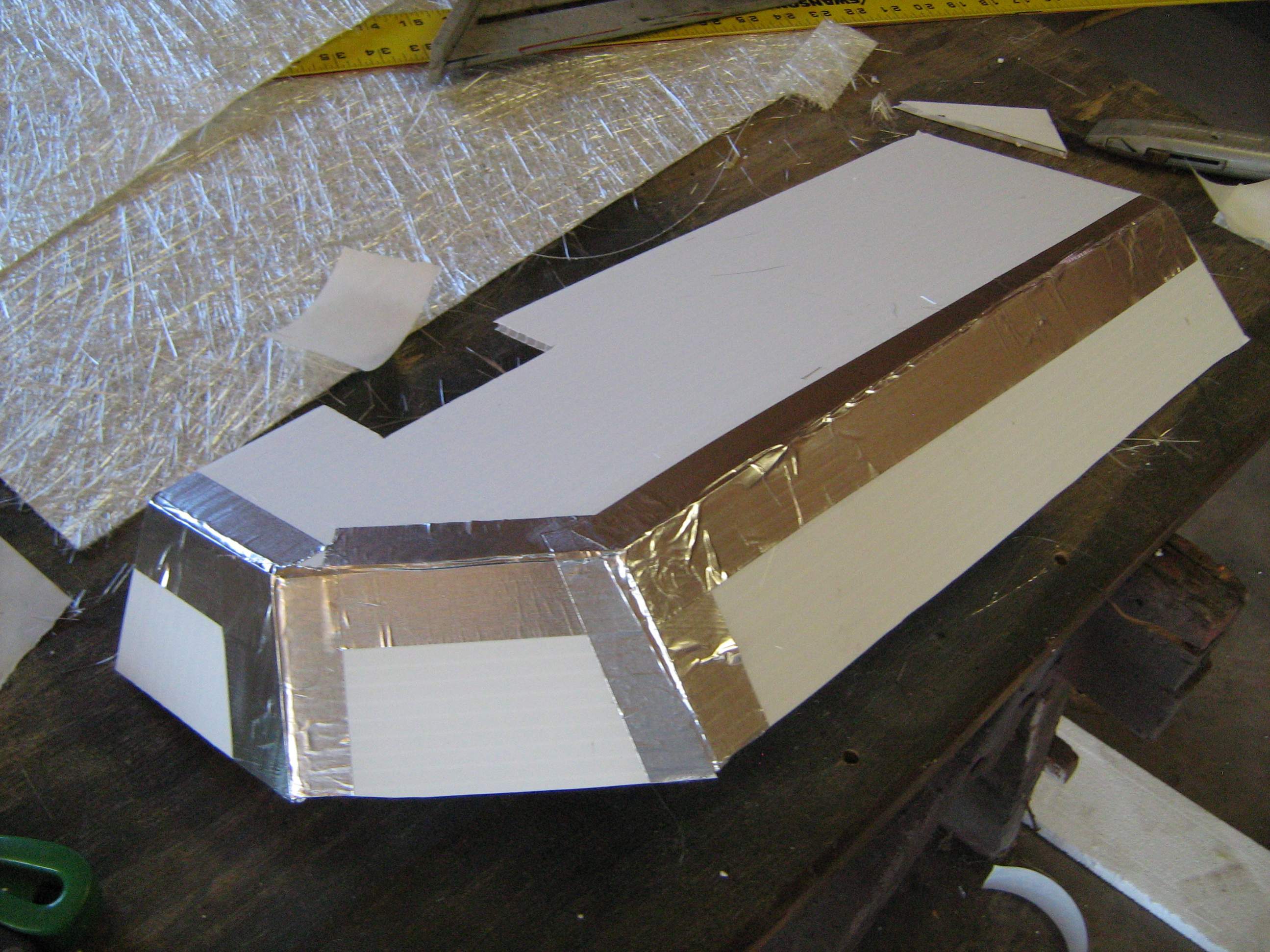

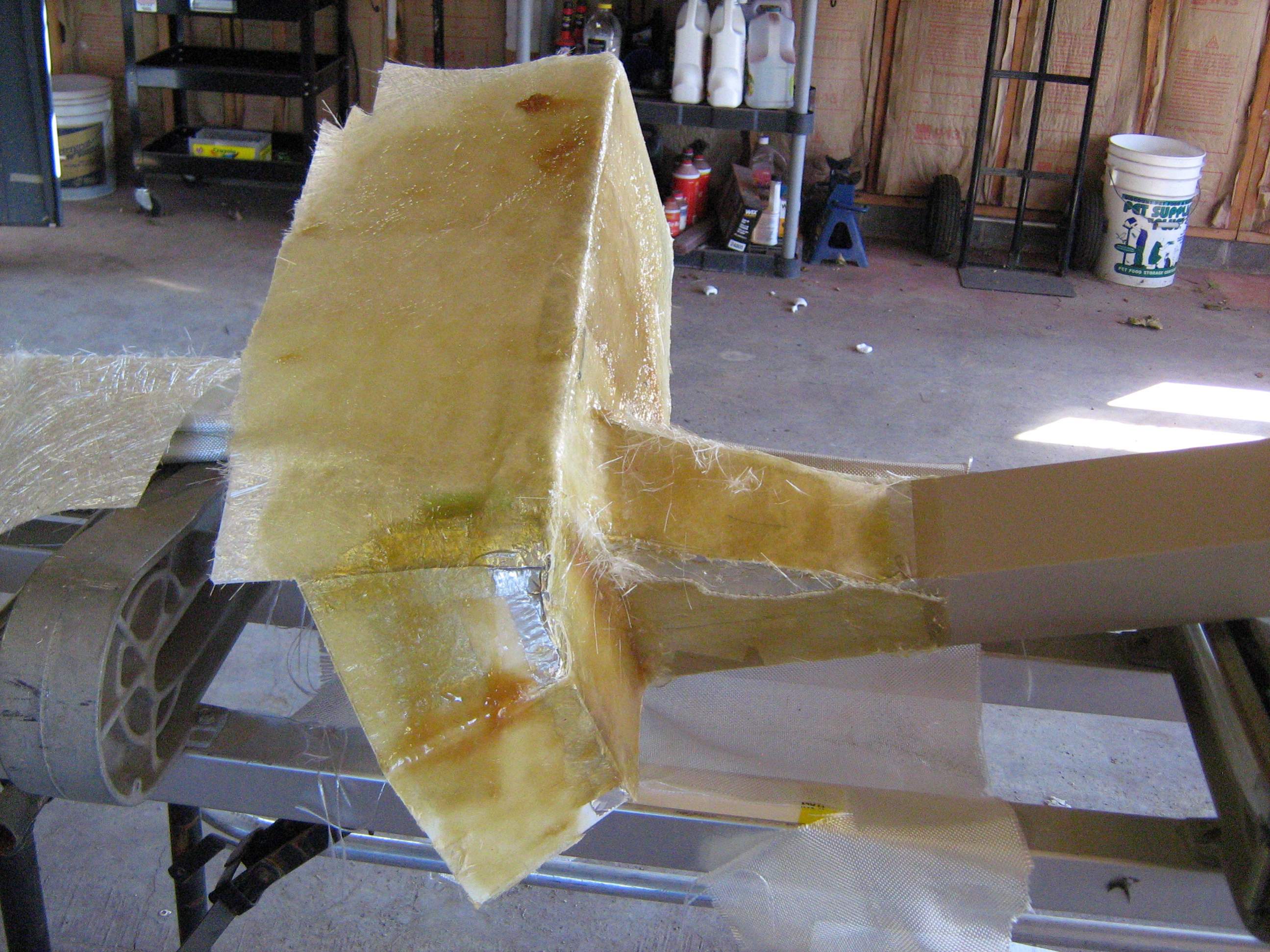

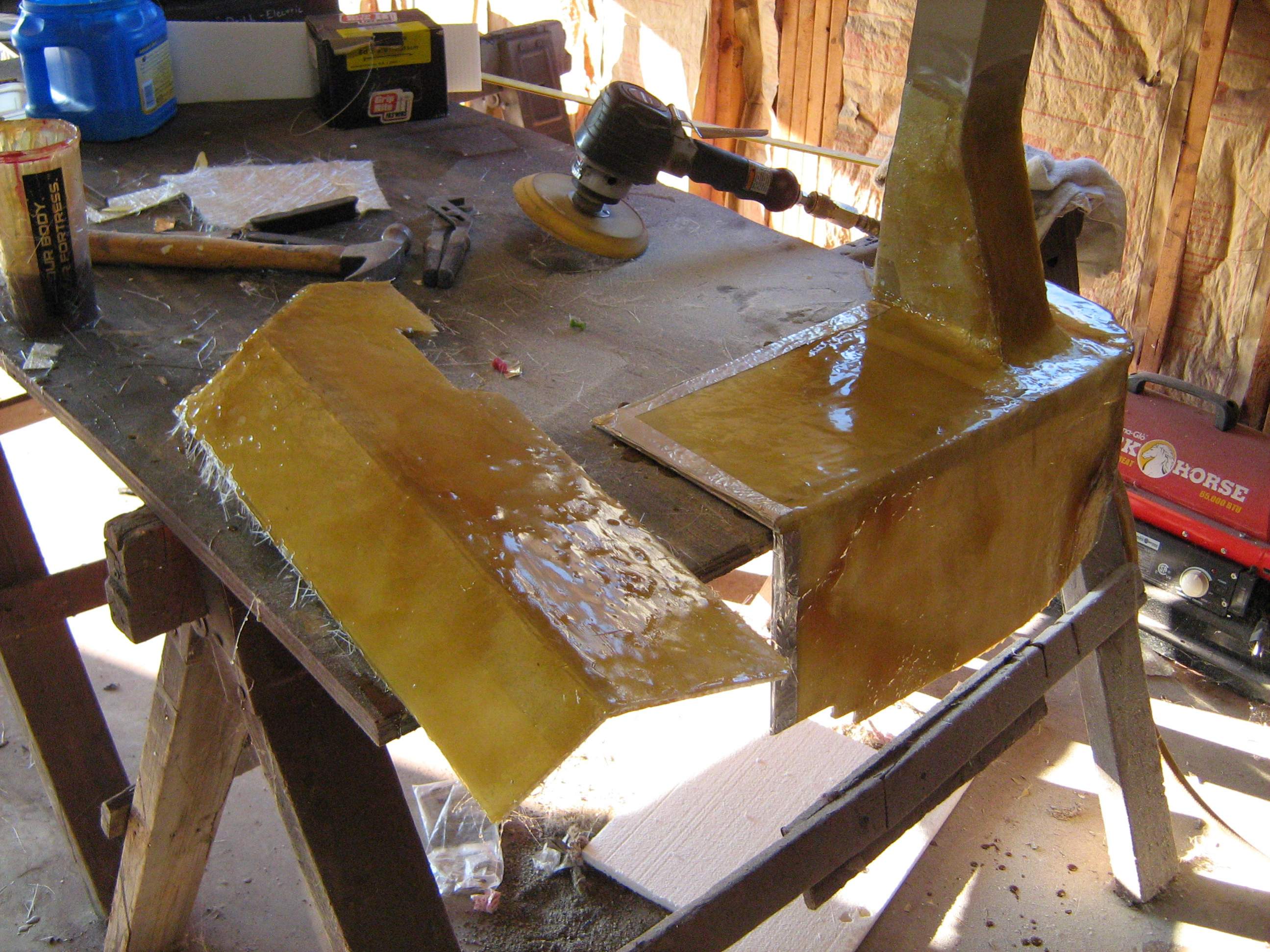

I have been working on trim panels for my custom cab that I built last year I have posted a few pics and will post more as I progress.
I formed the panels out of coroplast plastic (corrogated signboard)
I then laid down fiberglass mat
Then sanded and bondoed
then coated with bedliner spray, primed and painted with oil based enamel, My final coat will be the speckled trunk spray by dupli color
