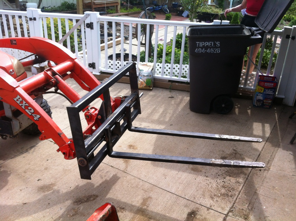

Does any one know the size of the center pin/bushings that are on the bucket of a bx24. Just finished making the fork carriage and need to know were I could purchase bushings (locally)
I am thinking your forks are too long, and will bend under a good load.
Are those forks store bought or did you make them?

The forks are 42" long and they have a 900lb capacity
