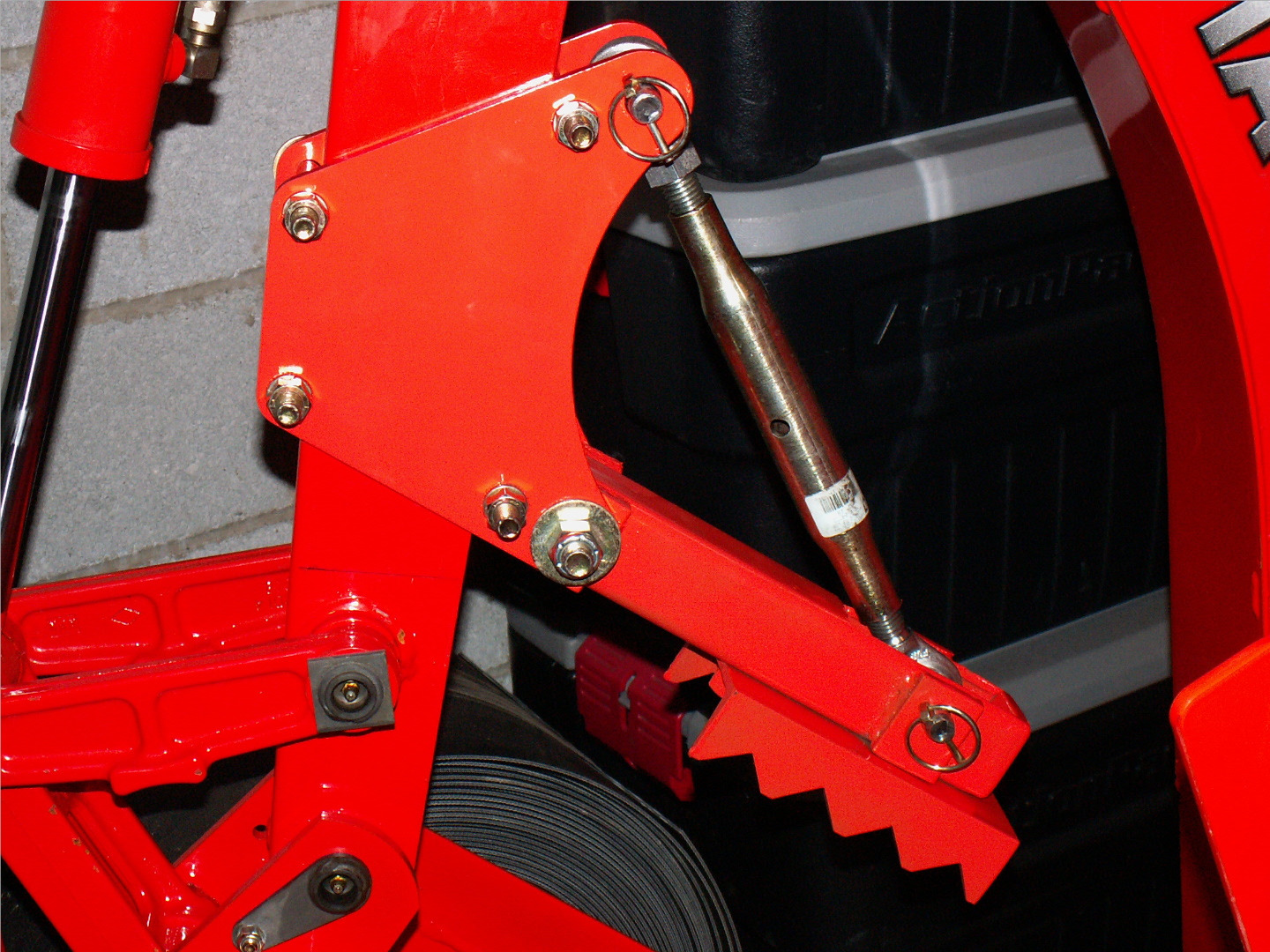

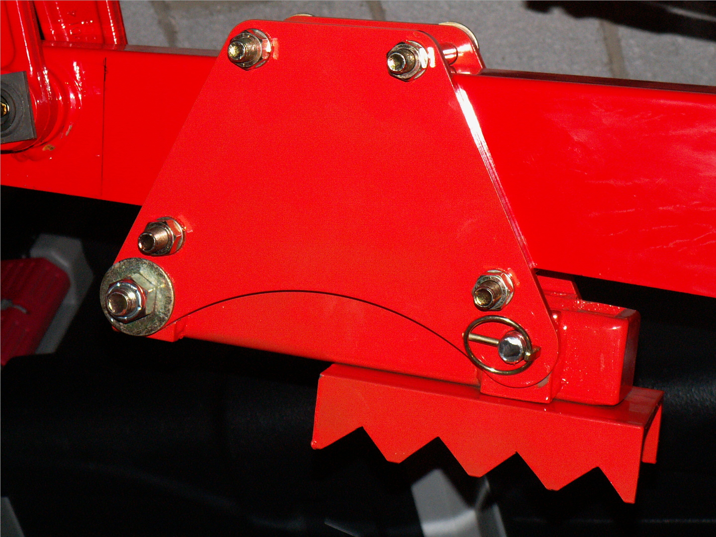

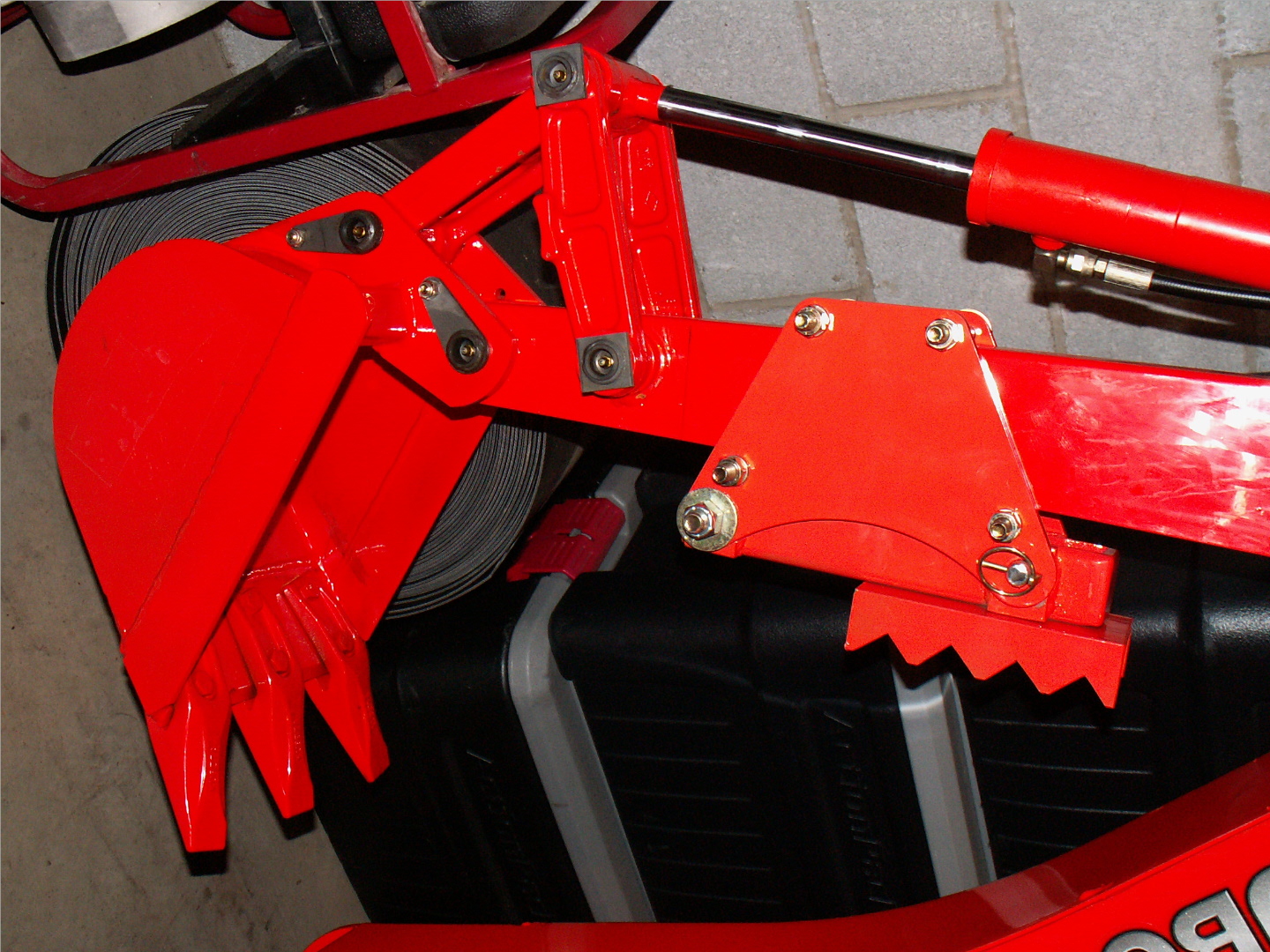

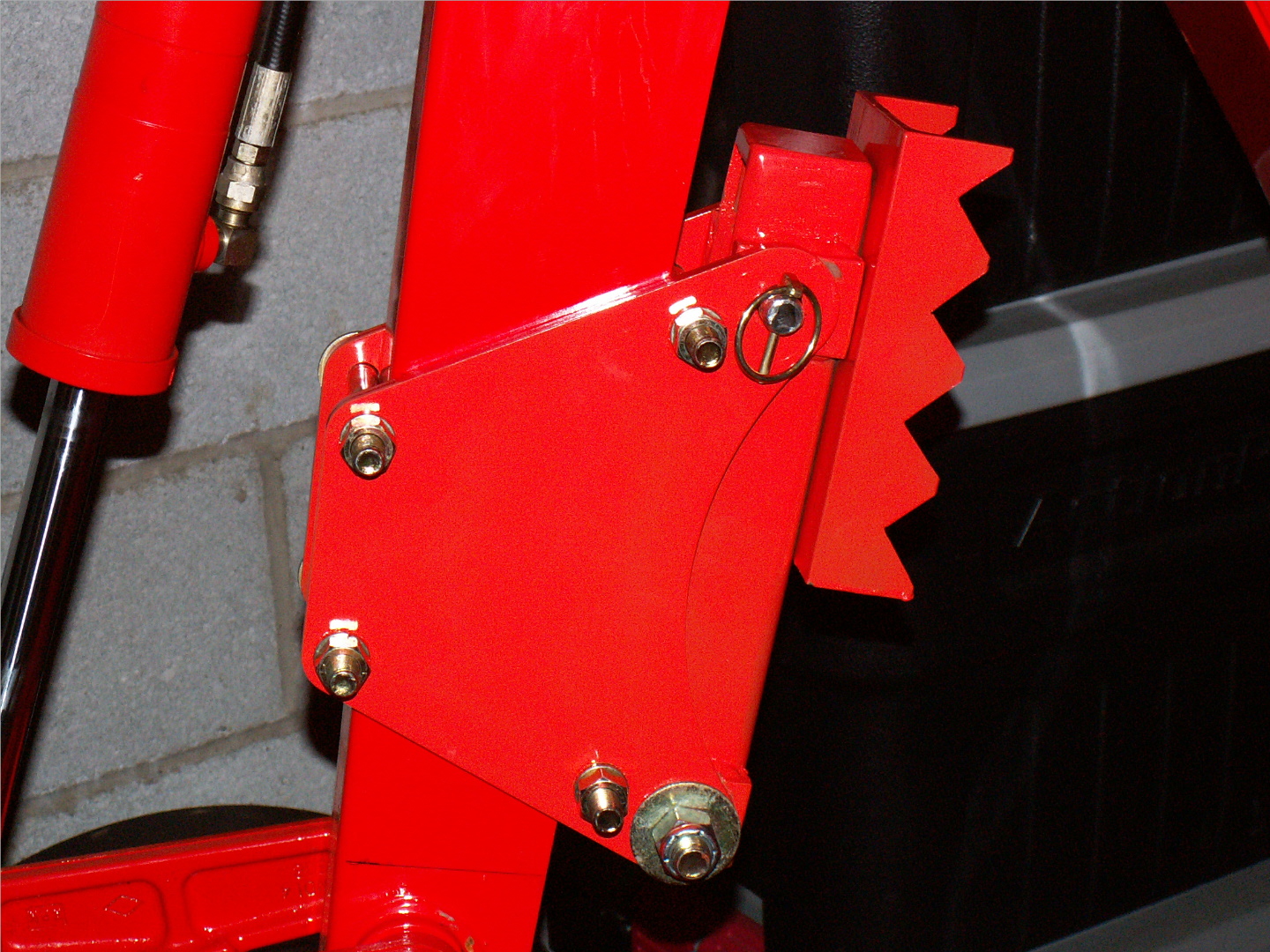

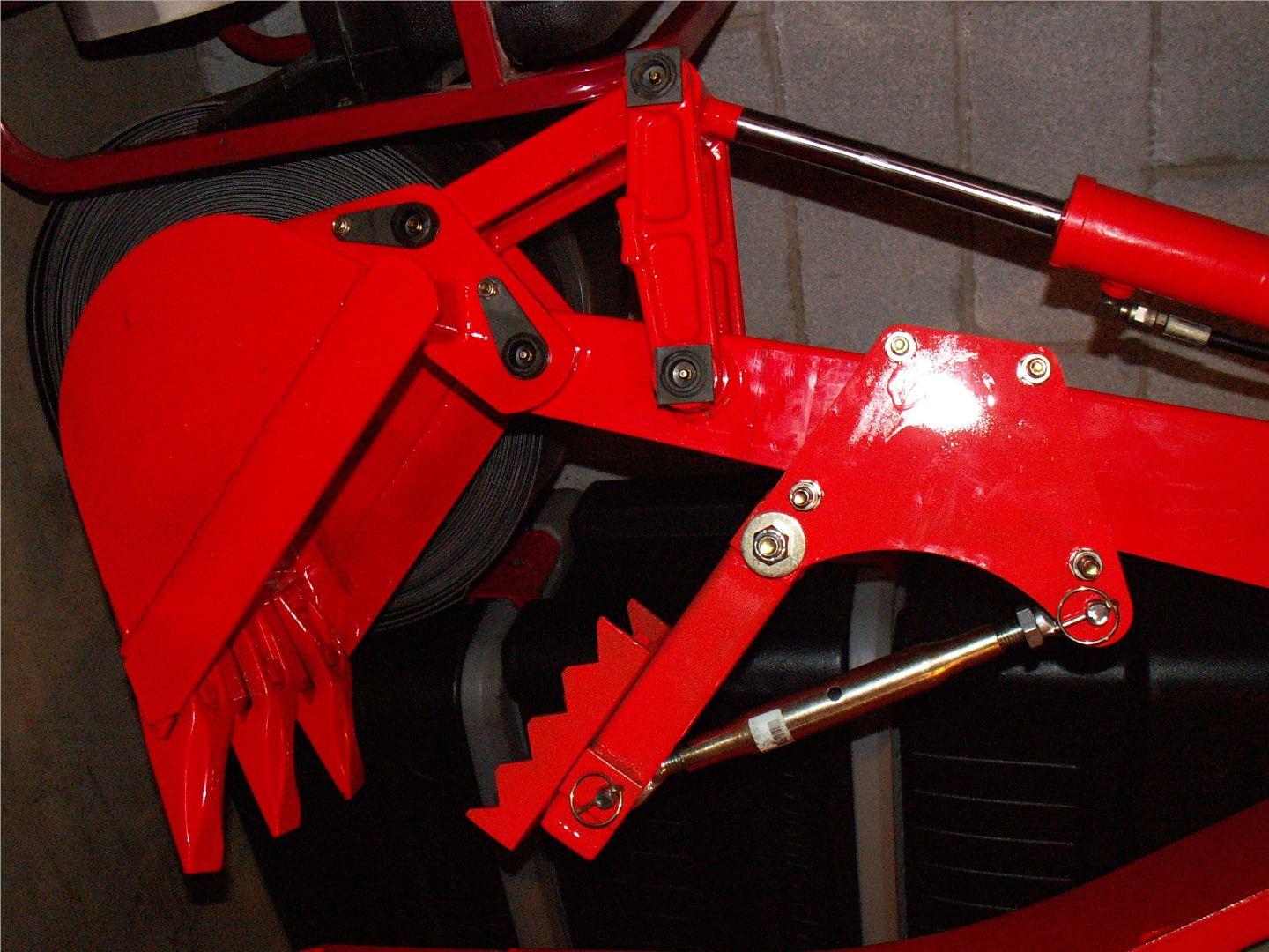

I took delivery of a new Kubota BX24 Tractor at the end of December. It's still sitting in the garage right now but I have begun to mount the goodies to it. I decided that one of the first things I needed was a Thumb. Here in Western Pennsylvania it can get pretty rocky, and also I cut a lot of fire wood, so this attachement will come in quite handy.
The pictures shown here are of a Thumb I fabricated. I first layed the whole lower Dipper Stick and Bucket assembly out on a CADD System to properly design the Thumb. It is made of 3/8" thick plate, and a 2"x2"x 3/16" box beam for the arm. The gripper is just a simple 4" channel that I cut notches out with a cut-off wheel on a disc grinder. The side plates were laser cut from the CADD file in a local machine shop. The best thing here, total cost was only about $60.00 bucks! Better than paying the high prices of buying retail.

Nice Work! I like how it is setup for a top-link so later on, you can move up to a hydraulic top-link and really have a useful tool.

I have no experience with thumbs but other posts have mentioned slippage of the squeezed bolt-on types. You may find a couple of thrust blocks may need to be welded on the dipperstick. Please let us know how yours works once you get the chance to use it.

As for it sliding up the Dipper Stick, I don't see how it can as the stick is tapered and wedged from the narrow end at the bucket and the wide end at mid-knuckle. That was the tricky part in designing this, because the (2) bolts along the tapered bottom I installed a 1/4" thick plate so when the forces are applied to the thumb it will transfer back into the bolts in a shear fashion and then thus the plate will distribute the load more evenly across the bottom taper of the Dipper Stick. We'll see how the thing works. As soon as the weather breaks some around here (6 degrees out now) I plan on see what the whole machine can do. Believe me, there are a number of rocks and stumps in my sights!

I did not realize the bx24 had a tapered dipper. My bx23 dipper is straight. I'll bet your design will work great. I'm sending a PM for the CADD drawing. It won't interchange with the bx23 but may help me out seeing your geometry. I know a lot of time goes into design, thanks for sharing.
