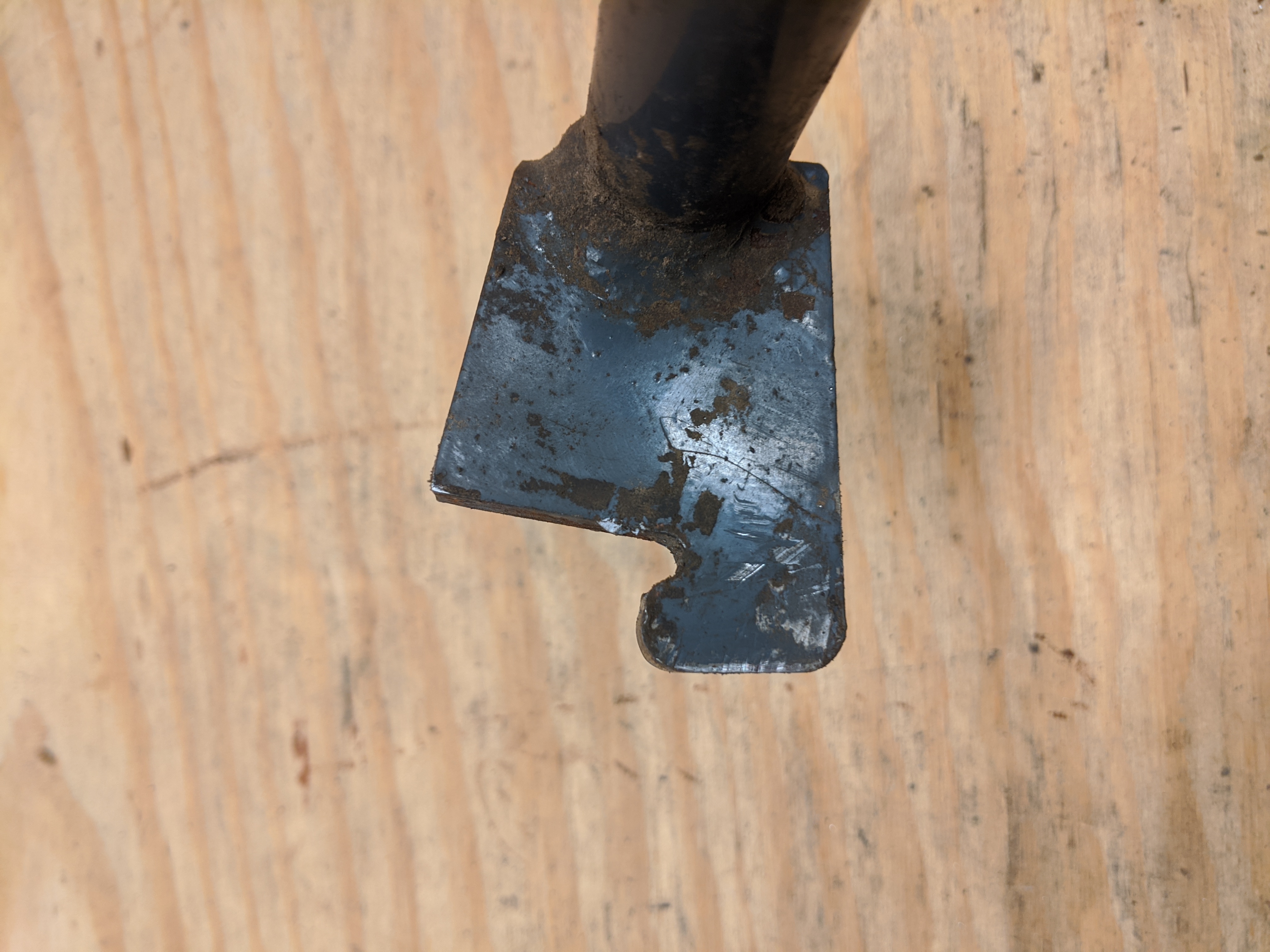

Hi Everyone, first time poster here.
So, I just moved from Arizona where there's nothing but dirt, rock, and cactus to Missouri where I now have several acres of green stuff on the ground that I've been told is called grass. It's been a bit of a learning curve, but I think I'm making progress.
Anyway, I bought a Kubota BX2200 with a 60" deck (RCK60B-22BX). Got it fixed up and did a tune up, replaced a few things on the deck and its running/ operating great. But there seems to be one problem that's got me stumped. The mower deck blade height is only about 2" on the highest setting. The height adjustment knob "works" in that it does raise or lower the deck incrementally, but I'd like to be able to cut higher than 2". I inspected the height adjust mechanism and all the linkages, nothing appears to be damaged. Tire pressure is correct.
The rear deck hangers could be adjusted up about another 1/2", but I don't feel like that's the problem/solution. I've been searching online for days but can't come up with anything. Anyone else have this problem or have any suggestions?
Much appreciated!

What puzzles me is the Top position seems like it is correct. If so, seems like the other positions should be as well.
My Top position also seems correct. Last night I decided to start taking things apart to see if I can find anything. After taking out the rear lift shaft, I had the thought that the bracket welded to the shaft is maybe worn down in the spot that contacts the rotating height adjustment stopper. Especially after reading your post, which I think would agree with this (if it's the issue) since the "Top" position uses top edge of the bracket, not the lower finger that sticks out that all other positions use (as shown in my picture).
I've tried finding a picture of this part (K2561-44250) to see if it is worn but haven't found a good comparison yet.

Mine does the same thing. In fact, when I use the adjustment stopper, it actually moves around and it the deck drops another 1/2" when the deck puts pressure on it.
I've replaced mine twice and I've just lived with it. I do mow rough (bumpy) ground, so I think it gets worn early from the deck jumping up and down.
What I do is if I need a higher cut, I just use the 3pt lift and get it to the height I want, then I lock the 3pt valve so it doesn't leak down.
Personally, throughout my experience with a MMM on a tractor, it's been a wash... Next machine will have a regular 3pt rear mower.
