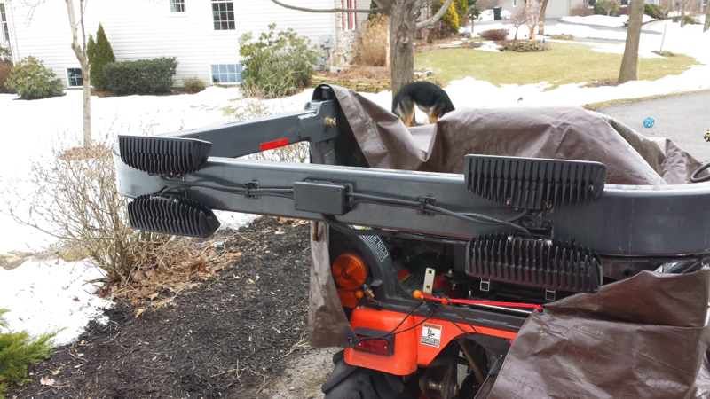

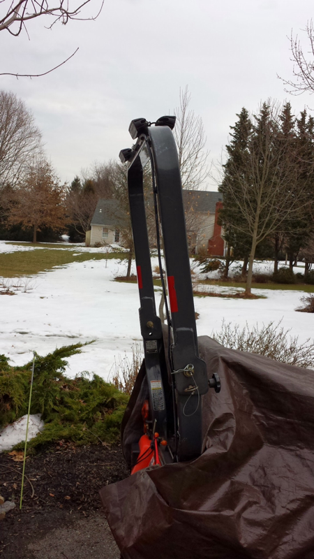

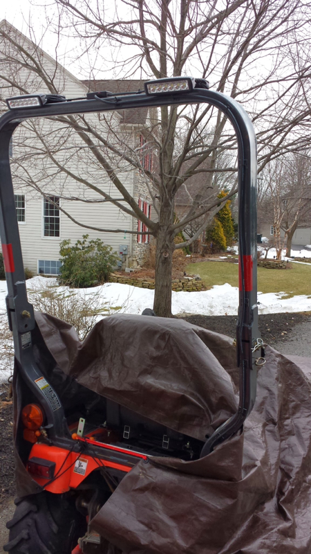

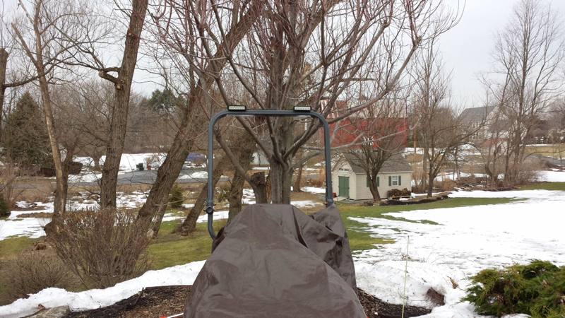

Just thought I would provide pics of my work light install on the ROPS of my BX22. I used four five-LED strip lights from Amazon.com @ $25 each. Used a small project box to keep the electrical connections clean. Used JB Weld to secure the lights to the ROPS. No drilling, just ground off the paint to get a clean, rough mounting surface. Ran the wires to console along the outside of ROPS on the rear side. Attached with cable ties and mounts. Mounted switches on the lower dash to the left of the ignition switch. I've yanked on the lights and the JB Weld bond seems very secure.
