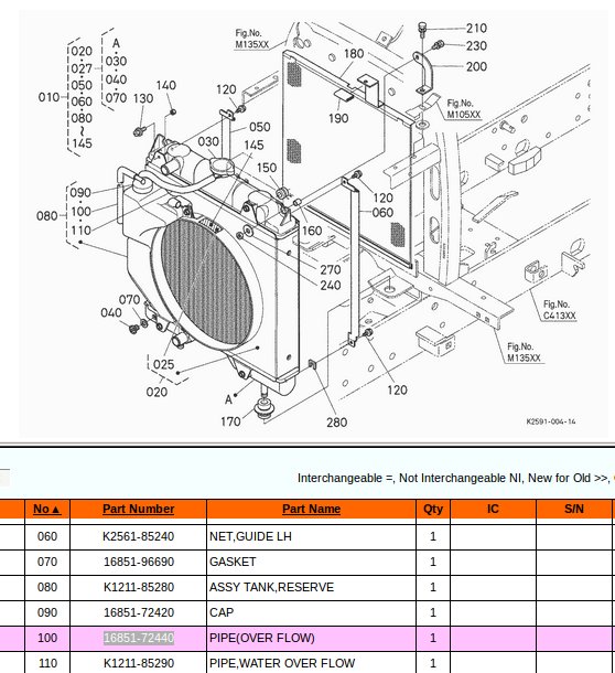

I noticed a gash in the hose that attaches to the coolant overflow bottle on my BX22. (see attached photos, #100 on parts diagram)
Do I need to replace this hose or are they manufactured like this?
Can anyone tell me where to attach the other end, as I pulled it out inadvertently?
Thanks for your help.

Just overflow hose for coolant recovery bottle, does not usually have cut in hose though. Usually routed along side bottle and radiator so it will drain to ground if it overflows. Coolant in tank should be between MAX and MIN.

Thanks for the quick reply. The coolant level is good. The hose will be easy to fix. Glad to know that I can do some tractoring today!
