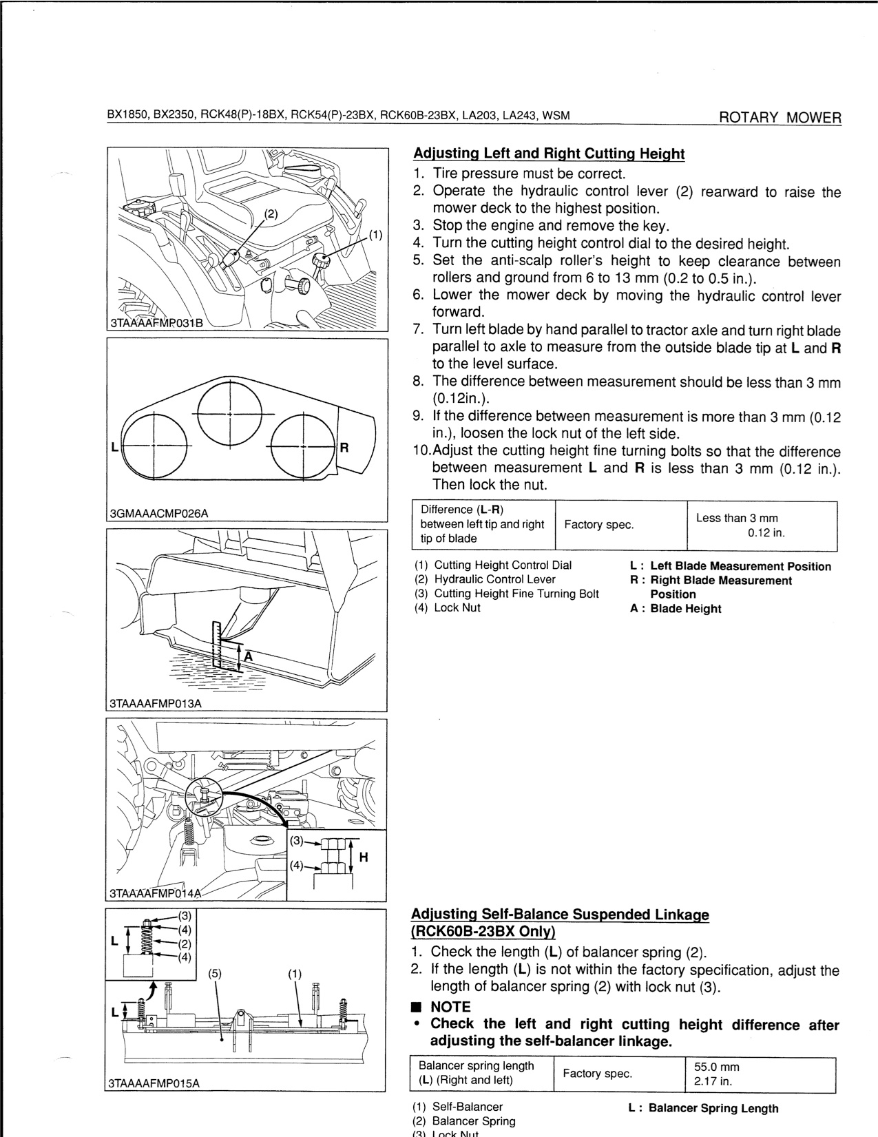

Hello. I am in need of a simple explanation of deck leveling on this RCK-54-23bx deck. My manual is forthcoming and I need help staying ahead of this grass. I am having scalping on the left side of this deck.
Thanks..jn
/ Kubota BX1850D #2
I am going to attempt to attach the leveling instructions from my work shop manual. Should be a fairly easy adjustment.

Someone mentioned a plastic gage you can buy from the green tractor dealer for about $7. The gage is supposed to be a big time saver. You might want to look into this item.
