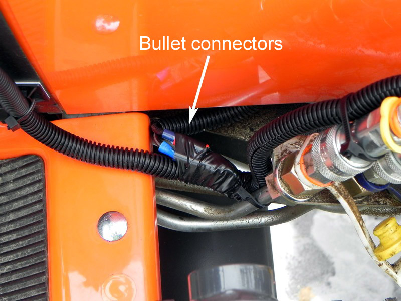

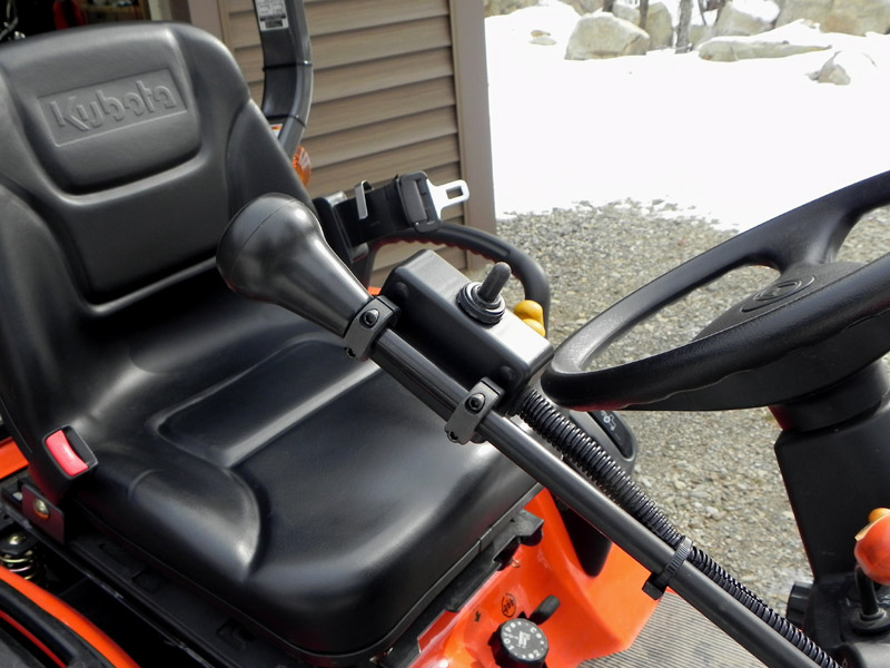

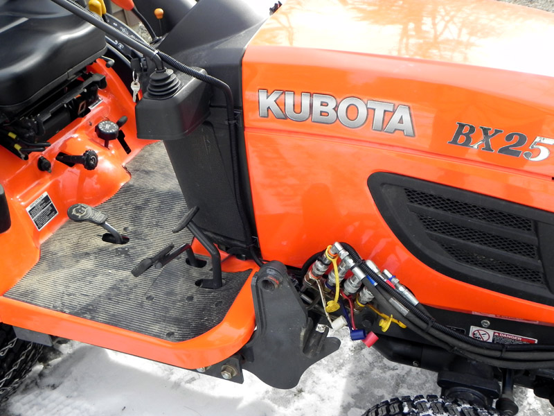

Phil, I just did finish my actuator project and following is how I addressed the wiring, but there are many ways this can be done, no right or wrong way, just what works for you. I drew my power directly from the battery. I bought an inline fuse holder from an auto supply store and connected it directly to the positive battery terminal using a 5 amp fuse. I brought this power line through the firewall on the right near the fuse box alongside an existing wire loom and terminated it near the hydraulic ports with bullet connectors (make positive the female end and negative the male). This power needs to get to the double pole double throw switch (ON momentary-OFF-ON momentary) you will use to operate the actuator. Members here have mounted this switch in many places; I chose to mount it on the joystick close to my hand so I could control all aspects of the blower with one hand. My switch is mounted in a 1"x2"x3" Radio Shack project box and it is connected to the joystick shaft with split shaft collars from Mcmaster-Carr which have flats on 2 sides. Mine were #9746T1 for 1/2" diameter. I drilled and tapped these collars in the center of one flat for 8-32 screws and then drilled holes in the project box to attach it to the collars. I drilled the box for the switch and proceeded to complete the wiring. Starting with power, I ran a line from the power bullet connectors up to the switch. These connect to the 2 center terminals of the 6 on the switch. I then made 2 short jumpers to run diagonally from corner to corner on the switch terminals and mounted them. Then I ran a line from the 2 terminals on one end of the switch to the actuator (doesn't matter which end). I terminated this line with bullet connectors near the actuator and added mating connectors to the actuator leads. Before adding these connectors I tested the actuator to determine which actuator wire went with which line wire so that switch "up" was actuator "up". If you get it wrong just swap wires. Wired like this there is no need for relays which are used to control high current devices with low current switches. My actuator has a full load current of 3 amps and my switch is rated for 20. I used some 16 gauge wire that I had but I'm pretty sure 18 would work fine. All wiring was put into 3/8" looms purchased at Home Depot. This arrangement allows me to unplug the power connection near the hydraulic ports, leaving the power feed line there permanently, and remove the rest of the wiring and switch each spring. Some might want to leave as much wiring as possible on the machine and use a completely different wiring scheme but this is a personal choice and this method suits me. I like to leave the tractor as stock as possible. I don't know why though because I plan to own it until I die. I might just go out and drill a hole in the ROPS. :laughing:
Bullet connectors near hydraulic ports -
Switch on joystick -
Loom route -
Route to actuator -

That's a very clean installation and you've provided great information. The pictures answered a few of my questions as well regarding switch mounting ideas. I'll definitely go with your wiring suggestion, as it sounds very doable. I double checked my actuator and it's ok. Now I just need to gather up the hardware and wiring supplies I'll need and go to it.
Thanks for all of your help!
Phil

You might consider using 2 pole trailer connectors with solder & heat shrink tubing for the disconnects, also no reason not to use the power outlet with a good quality plug if you plan on removing the harness in the spring.
