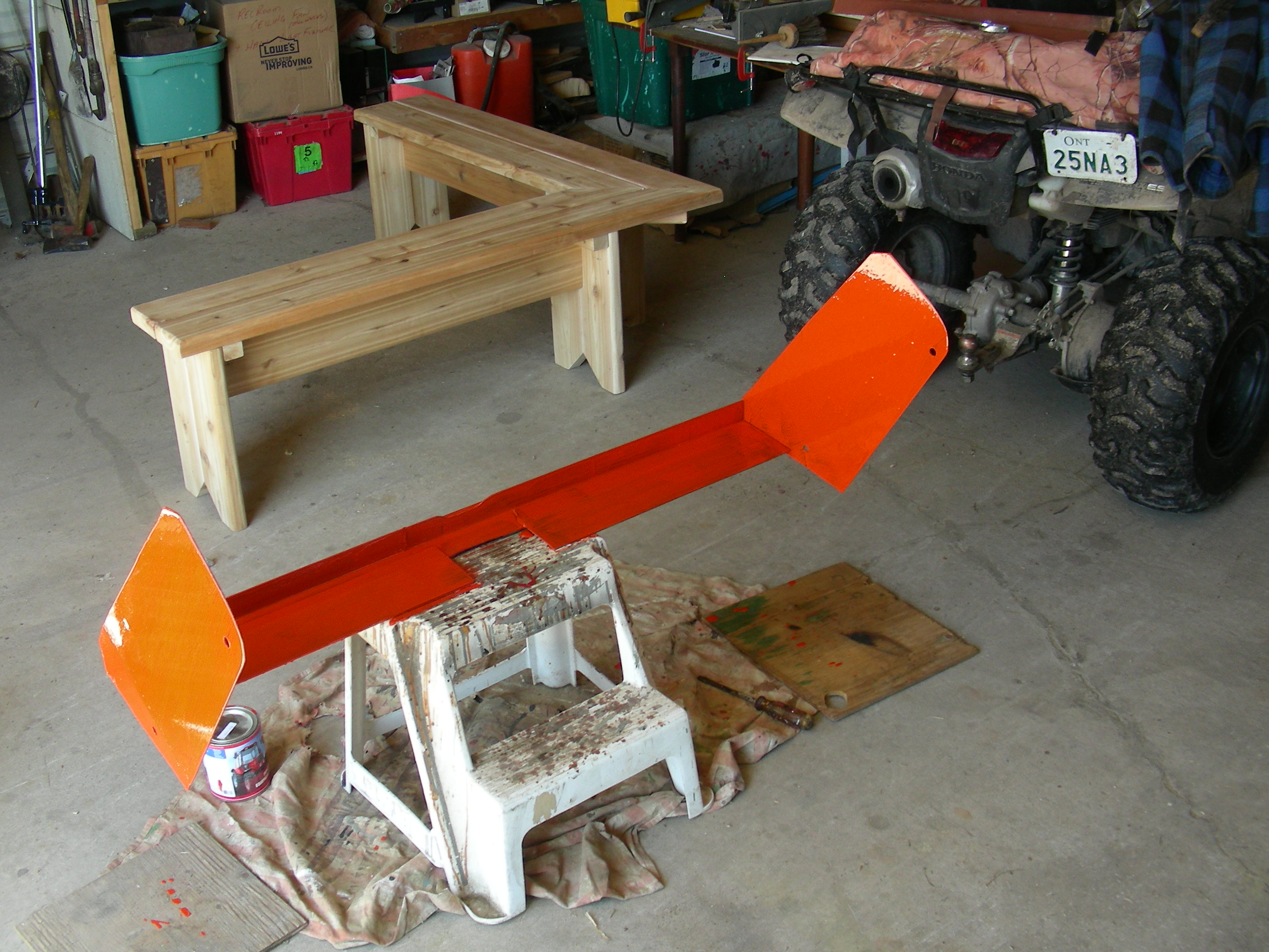

I have a BX2370. I was often frustrated by the limited capacity of the loader bucket. This was especially true when moving lighter weight materials such as sawdust, snow, mulch, composted manure, etc. I researched other large capacity / bulk material buckets, but I didn't want to get into a completely different bucket. Not only because of the nearly $1000.00 price tag, but because the cutting edge of a larger bucket would tend to project further out than the factory bucket, I was afraid that it would limit roll back and break out force.
So in my case I decided to fabricate a 3/16 plate into a spill guard for the bucket. I simply went to my local steel supplier and bought a piece of 3/16 x 8" x 48" plate. I had them make a 45 deg. bend 3" from one edge. I then used C clamps to hold the plate in the bucket so I could measure for the holes.
I used a Hypertherm Powermax 45XP to make the holes and radius the corners. I used circle template of approximately 7/16 to burn the holes through both the fabricated plate and the bucket top at the same time. I then cleaned up the holes with a 1/2 drill bit. This guaranteed alignment when installing the 1/2 fasteners.
I've already used the bucket a few time to place manure in my garden. Maybe it does only increase the bucket capacity by a little mare than one sq/ft. , but the added benefit is that it does prevent material from falling on the hood. I am able to roll the bucket far enough forward that it doesn't interfere with the chain hooks. But in the event that I did want to remove the plate, it would only take a couple of minutes.
Total price for materials and the 45 deg bend was, $35.00 I spent about 2 hours of labor drilling and painting. IMG_5508.JPGIMG_5509.JPGIMG_5511.JPGIMG_5508.JPGIMG_5509.JPGIMG_5511.JPG

How are you supposed to use the bucket hooks now? Are you going to take the 'shield' on and off? Drape the chain over it?
/ Kubota BX - Large Bucket #6
The bucket will actually roll forward far enough so as not to contact the spill guard during a vertical lift. But, I do like having the option to remove the plate if I like. It literally only takes a few minutes to remove the fasteners, and the plate is only about 20 lbs or so.
