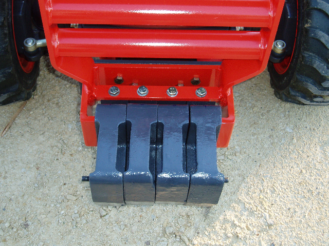

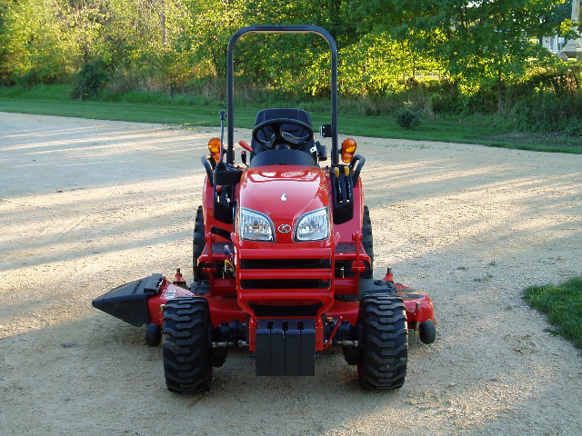

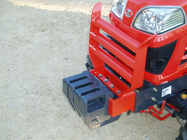

Yes I do have a grill guard and a weight bracket. I have 5 55lb weights on the front. I got real lucky and my dealer had a weight bracket off a older L series that I modified. I had to keep the weights up high to get up and down some hills.
This is 550lb on the pallet.

Thanks, I used a big piece of angle, I think 3"x6." I cut it so it would go in between the grille guard. The welded the weight bracket to the angle and added gussets to the top and bottom.

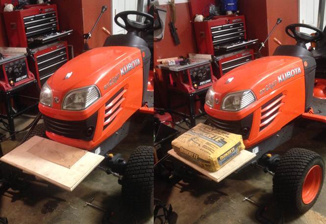

You guys are awesome with your welding skills, I don't have that available to me so I had to come up with something different for much needed front ballast when I use my 600+ pound tow behind aerator - I will only use it twice per year but I for sure needed 60-100 pounds on the front. It's not perfect but I made a tray on the front supported by angle iron underneath which I bolted to the frame of my BX2360. I am going to paint it orange and maybe even buy an orange pillow case for the 80 pound bad a quickcrete! That 80 pounds of weight was way cheaper than a buck per pound. Hope this idea helps someone. I can easily unbolt it and put it away for the 363 days I don't need it.
