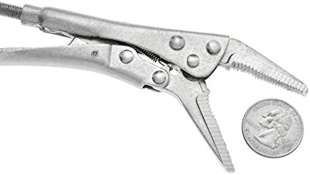

Friends, My BX 2200 suddenly stopped. It turns over but does not catch. There is plenty of fuel in the tank. It sounds like the fuel pump is still functioning. So I am wondering if the fuel filters are toast, and are inhibiting the flow of fuel, if that is what happens when they fail. I do not do any real maintenance on it, except fluids/oil filter, so this would be my first repair excursion. And, even if that is not the source, the filters are due, and I want to learn how to do some basic stuff.

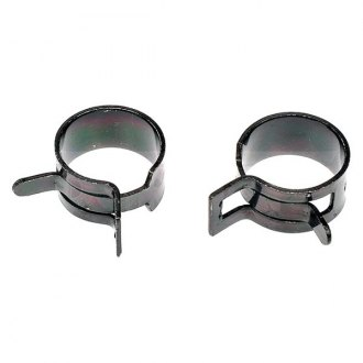

So I understand that it can be a challenge to remove the fuel line from the filters, and that a spreader tool can help. And I would also need some sort of clamps to pinch the fuel lines to keep the fuel from bleeding out. I went to my local Tractor Supply today, and they had neither. And then to a local auto parts store, and struck out again. So I will have to order on line. And suggestions for both devices would be appreciated, as would any advice for this project.

Pliers of the clamps are spring clamps.

IF fuel line is rubber.... Pinch it off with vice grips or stick a golf tee or pencil in it.... IF clamp on fuel line is just a spring clip, common pliers should work on it.... BUT fuel filter is probably not your problem if problem "suddenly" appeared....

Usually if its's a fuel issue it sputters/misses a bit before dying all together - meaning it comes on slowly not suddenly as you experienced. These are easy to change out - just open and slide the spring clamp back an inch, pinch the fuel line input with a pair of vice grips and change out the filter.
