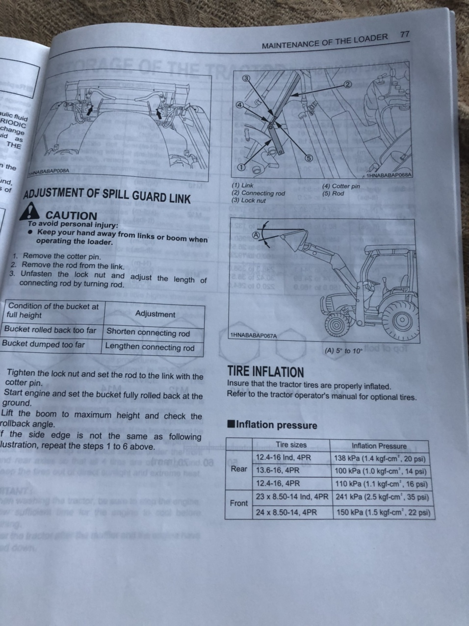

Hello,
My Kubota B26TLB has developed a tendency to want to dump the bucket as the FEL approaches the top of it's lift. I can actually feel the joystick control push sideways in my hand.
Any ideas what may be causing this?

The B26 has some spill guard linkage that rolls the bucket forward when raising to prevent material from spilling backwards onto the hood. This linkage is adjustable. It does this by physically controlling the joy stick. Check that control arms and joints are not bent. Operator’s manual has adjustment procedure. I adjusted mine when I first got it to suit me.
Usually it is set once and forget. Different types buckets would act differently.
This is not a required to operate feature and have a friend who disabled it on his B26. One of the advantages of the TLBs is the greater loader strength and more bucket articulation. I find it helpful particularly moving full buckets of gravel.
