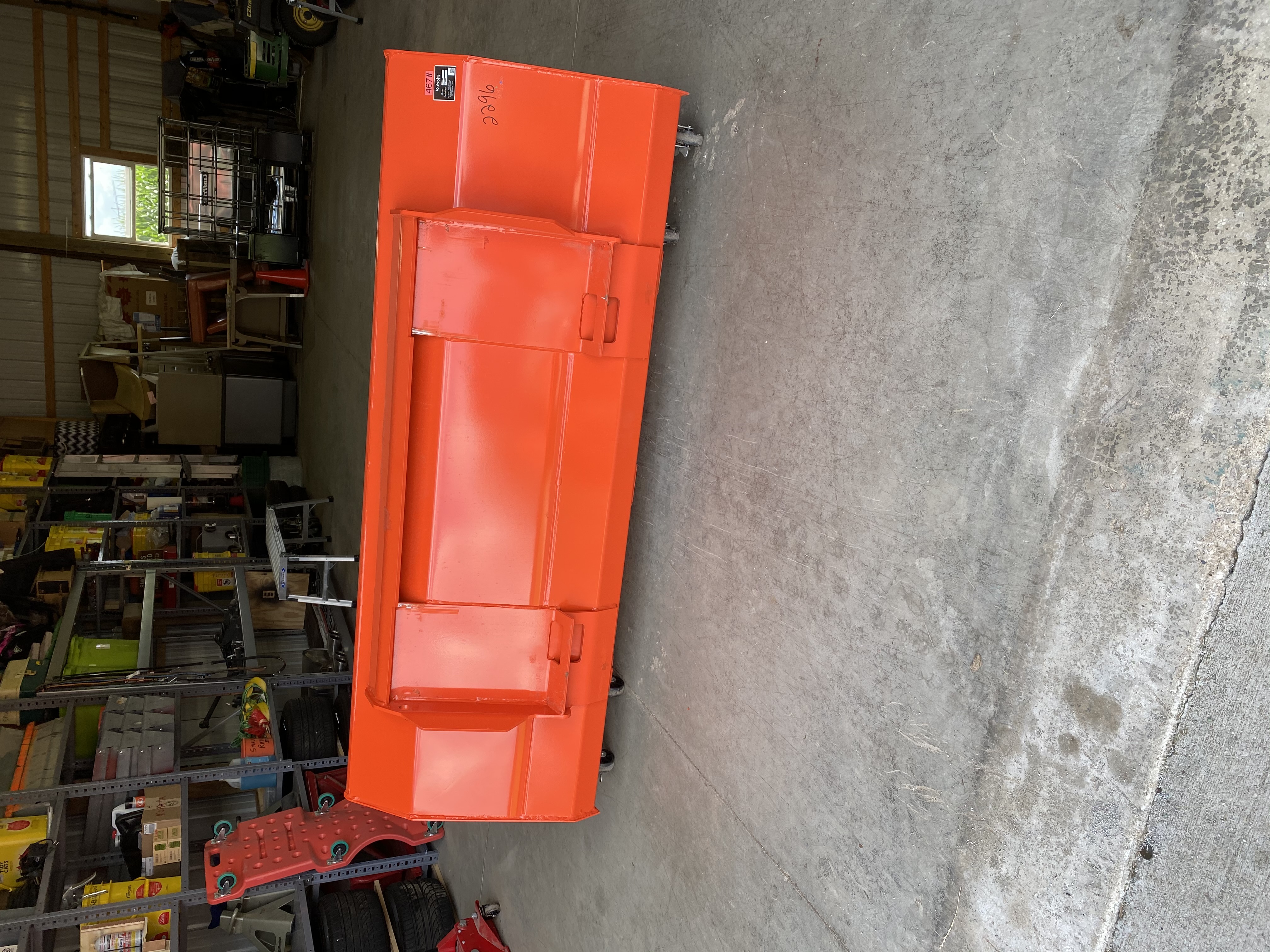

I opted for HD bucket 2296 with bolt on edge. Total weight is 467#. If I remember right HD bucket is 60 something pounds heavier than the standard 72". I had HD bucket on my Bobcat and feel that it's one area that takes extreme abuse. I've never talked to anyone that said they would have save some money and got a standard bucket.
Here's a pic of the back. I sticker the back with the weight, along with BH and loader...my OCD I guess :eek:

I will say this though. If you look closely at my photograph and enlarge it the SSQA plate is not welded square to the bucket it's higher on the right side (yes the perspective is off because I'm not centered to the bucket). You can also see the reveal at the bottom of the plate and the bucket is higher on the right side. Disappointed in Kubota QC a bit as I can see it clearly now that I have bucket off and on a stand. I'm not sure yet how to show this on photographs but I'm working on it. And, I'm not sure if it matters. OCD once again I guess.
Anybody else have this issue? If, it is an issue after-all?

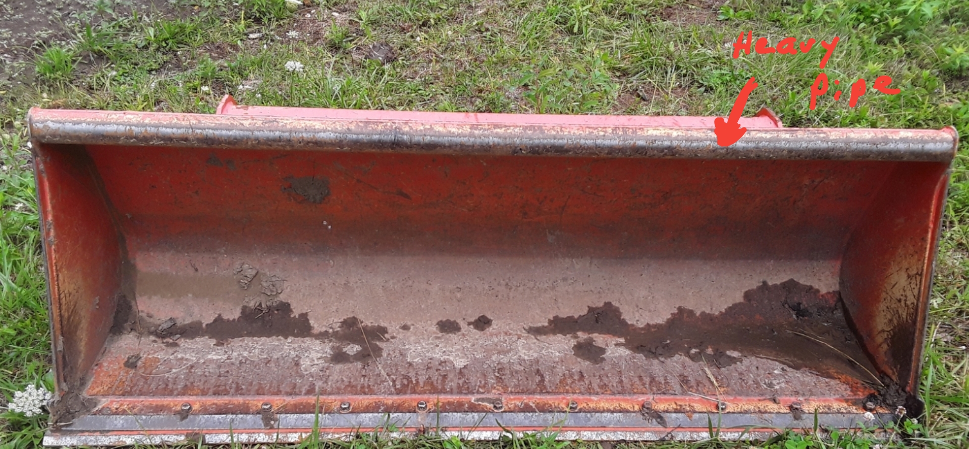

I do a lot of grading in reverse with the bucket flipped over. The top edge of my HD bucket is heavy wall pipe. At the time I purchased mine the regular one was bent sheet metal.
