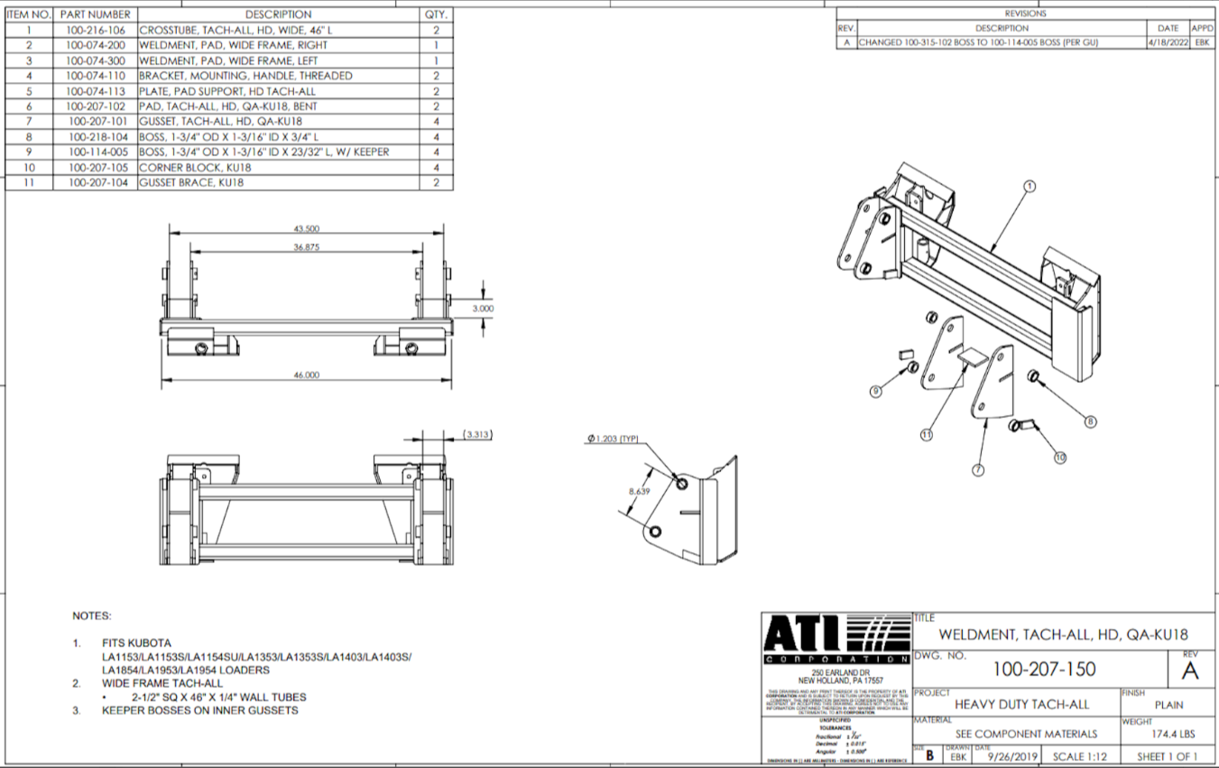

I would like to find a global coupler for my SSQA Kubota loader, not an add on adapter, but actual global loader “ends”
Found that ATI makes all types. SSQA to Global and pin on to SSQA, etc.
