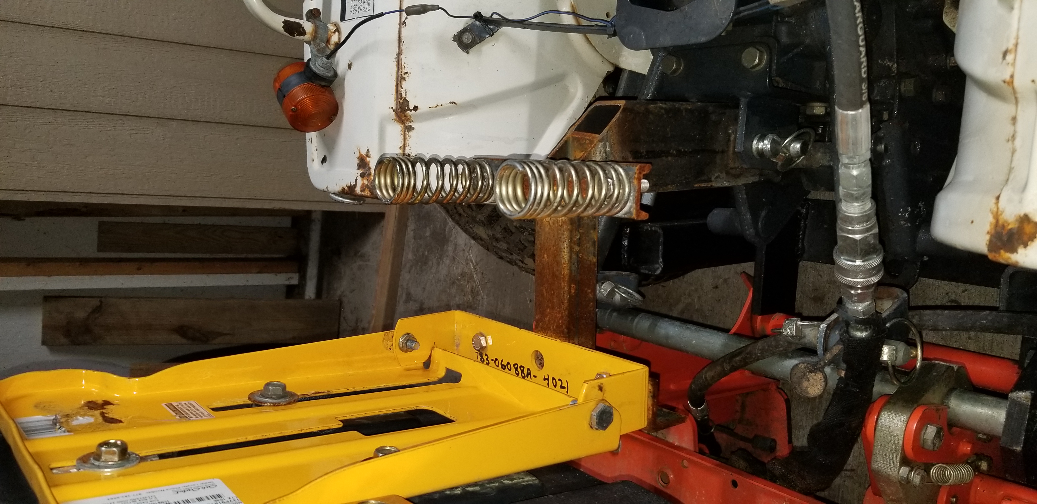

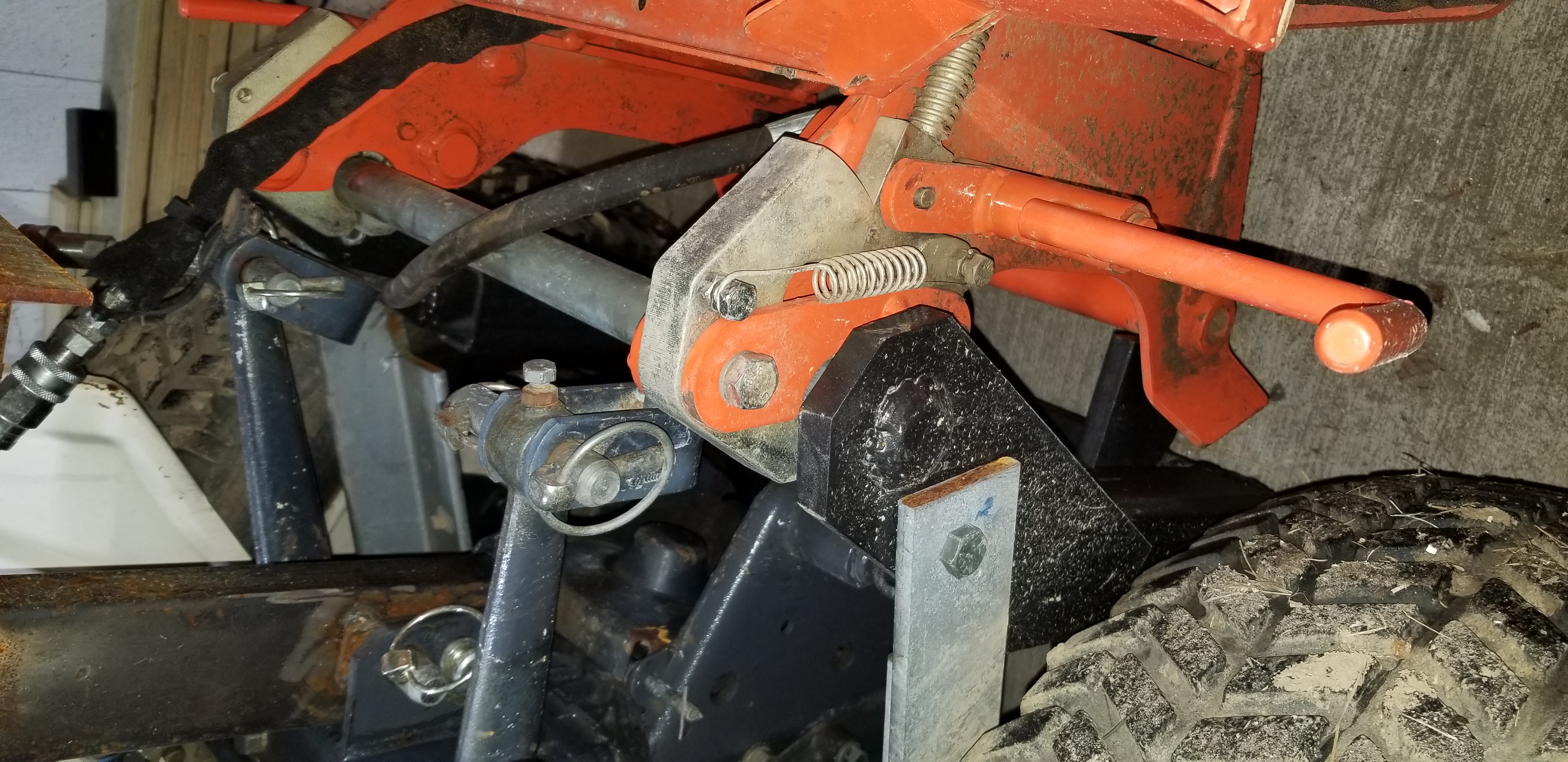

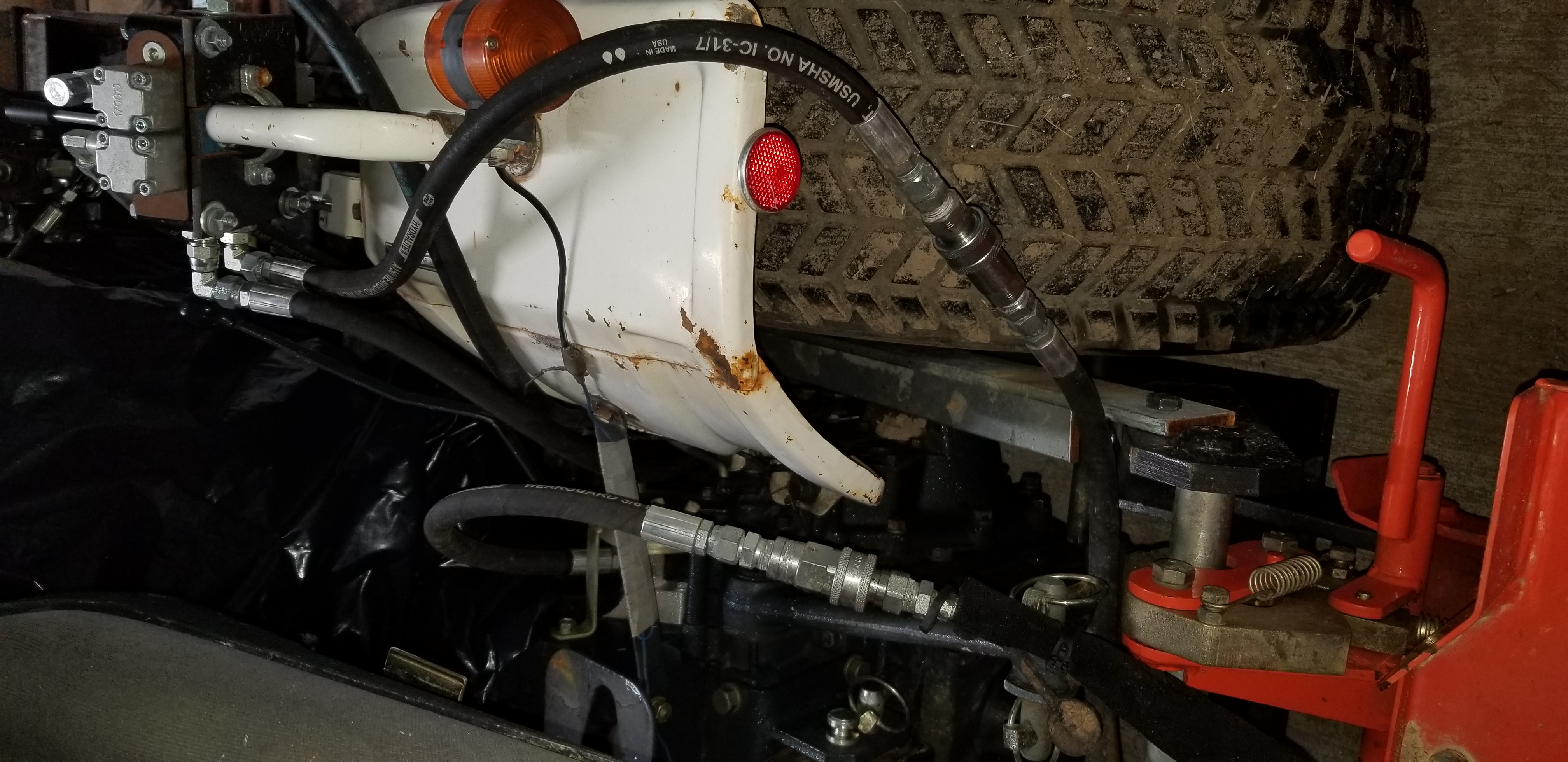

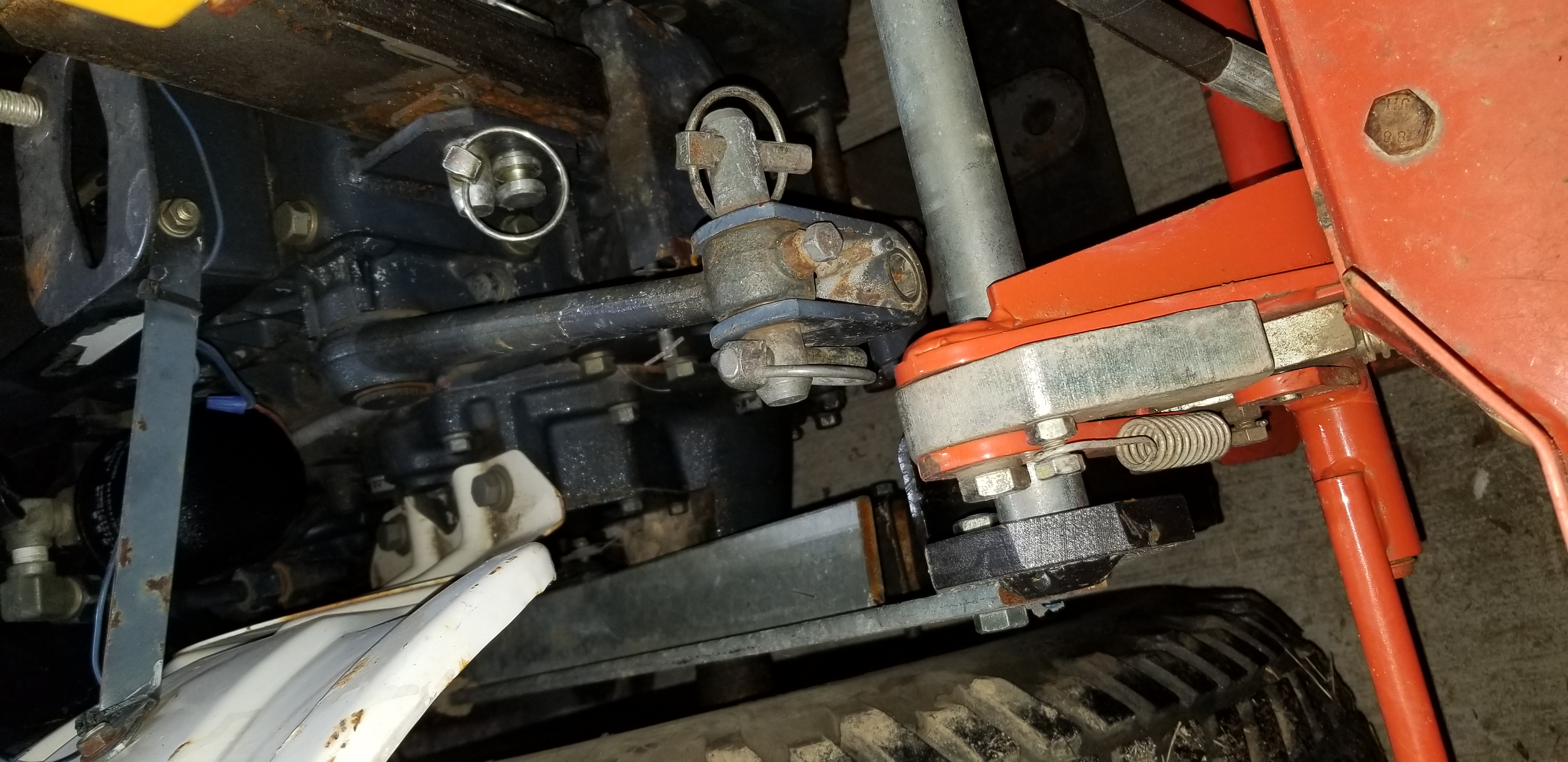

I checked my machine. I have the BT600 which only has 2 hoses. In the year since I installed it I have pulled 2 dozen stumps, planted (16) tress, widened a 100 feet run-off ditch and the list goes on. I would use the tractor hydraulics before spending money on a PTO pump. Unless you really need the speed you may find that is all you need. My tractor has 3gpm, 13.7 quart hydraulic tank, and 1850psi. I considered a swivel seat but I already had the metal and I couldn't wait to take it out and play in the dirt. I picked up the seat for $10 at a local repair shop and I removed when I remove the backhoe by pulling the 2 pins.

Thank you for taking the time to respond. Looks like a nice setup to me. While very functional, awesome and tough for its size, the loader on my Yanmar is SUPER slow, one motion at a time or its turns into a sloth. I imagine that using 2 motions at a time with a backhoe is essential to smooth operation. Also, while I haven't really looked into it yet...I am a bit concerned about the compatibility of the hydraulic fluid compatability, as my Yanmar hydraulic system ties in with the transmission and uses the same fluid. It is a geared transmission though, not a hydro trans.
As for adding a separate seat, I had already begun to lean in that direction, assuming I have space for it.
